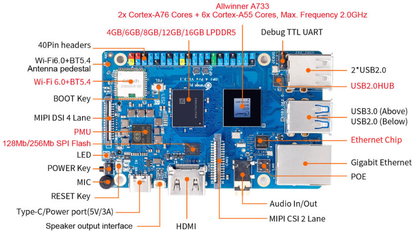

Orange Pi has recently introduced the Orange Pi 4 Pro, a high-performance SBC built around the Allwinner A733 octa-core processor (2×Cortex-A76 + 6×Cortex-A55), with a 3 TOPS NPU and BXM-4-64 GPU for edge computing and AI workloads. Designed for applications like robotics, smart gateways, industrial automation, and AI inference.
The board supports up to 16GB LPDDR5 RAM, WiFi 6 and Bluetooth 5.4, and Gigabit Ethernet with PoE, along with expansion options through PCIe 3.0 M.2 NVMe, eMMC, SPI flash, and microSD. It provides dual MIPI CSI camera interfaces, HDMI 2.0 output (up to 4K@60Hz), and a 4-lane MIPI DSI display interface. Additional features include USB 3.0 and USB 2.0 ports, audio I/O, RISC-V E902 co-processor, and a compact 89×56mm PCB. With its open hardware ecosystem and balanced CPU–NPU–GPU configuration, the OPi 4 Pro is well-suited for AI edge devices, robotics control, education, and embedded system development.

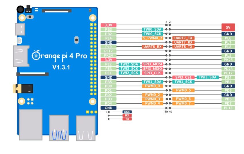

Orange Pi 4 Pro Pinout

  • SoC: Allwinner A733 octa-core processor
    • 2x Cortex-A76 cores @ up to 2.0GHz
    • 6x Cortex-A55 cores @ up to 2.0GHz
    • RISC-V E902 co-processor @ 200MHz
    • GPU: Imagination BXM-4-64
    • NPU: 3 TOPS @ INT8, supports INT8/INT16/FP16/BF16 mixed precision
    • PMIC: AXP318
  • Memory: Up to 16GB LPDDR5

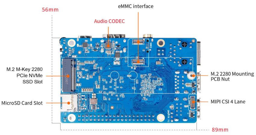

  • Storage:
    • Optional eMMC module: 16GB / 32GB / 64GB / 128GB
    • Optional SPI flash: 128Mb or 256Mb
    • M.2 M-Key slot (PCIe 3.0 x1) for NVMe SSD
    • MicroSD card slot (up to 128GB)
  • Networking:
    • Gigabit Ethernet (YT8531CA PHY) with PoE support
    • WiFi 6 and Bluetooth 5.4 (with BLE support)
  • Display:
    • HDMI 2.0 port up to 4K@60Hz
    • 1x 4-lane MIPI DSI interface
  • Camera:
    • 1x 2-lane MIPI CSI
    • 1x 4-lane MIPI CSI
  • USB:

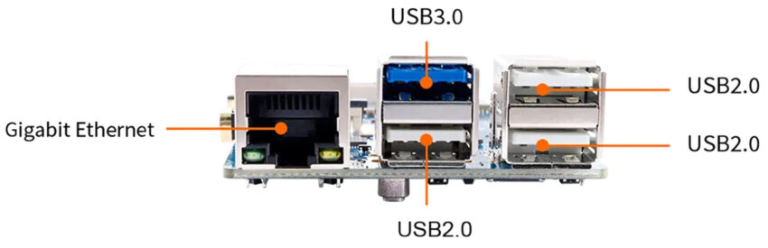

    • 1x USB 3.0 Host port
    • 3x USB 2.0 Host ports
  • Audio:
    • 3.5mm audio jack (input/output)
    • Single speaker and single microphone support
  • Other I/O:
    • 1x Boot button, 1x Reset button, 1x Power button
    • 2-pin 5V DC fan header
  • Power Supply: Supports PoE and DC input (details TBD)
  • Dimensions: 89 × 56 mm
  • Weight: 58 g

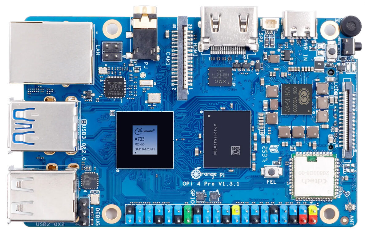

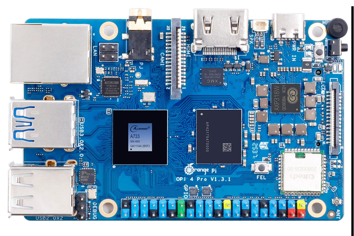

Hardware Overview
Orange Pi 4 Pro Allwinner A733 SBC
Hardware Overview (Top)
Hardware Overview (Bottom)
Hardware Overview (Front)
