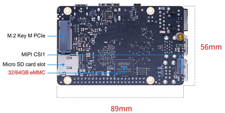

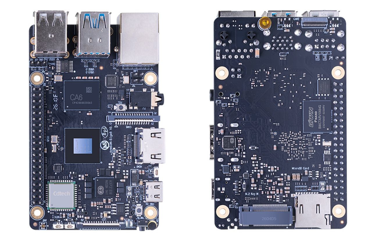

ArmSoM Sige6 Allwinner A733 SBC front and back
Sige6 allwinner A733 SBC front and back

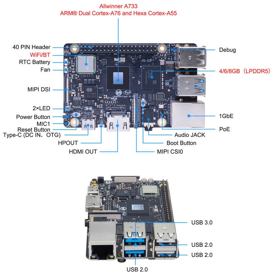

Sige6 allwinner A733 SBC Specifications:
  • SoC: Allwinner A733
    • Octa-core processor with 2x Arm Cortex-A76 cores at up to 2.0GHz
    • 6x Arm Cortex-A55 cores at up to 1.8GHz
    • 12nm manufacturing process
  • GPU: Imagination BXM-4-64 MC1
    • Supports OpenGL ES 3.2
    • Supports Vulkan 1.3
    • Supports OpenCL 3.0
  • NPU: 3 TOPS AI Accelerator
    • Up to 3 TOPS AI processing performance
    • Dedicated hardware acceleration for AI workloads
  • VPU / Video Codec:
    • H.265/VP9/AVS2 hardware decoding up to 4K@60fps
    • H.264 hardware decoding up to 4K@30fps
    • H.264/H.265 hardware encoding up to 4K@30fps
  • RAM: LPDDR5
    • 2GB, 4GB, 6GB, 8GB, 12GB, or 16GB configurations
    • Up to 16GB LPDDR5 memory
  • Flash Storage:
    • 32GB, 64GB, or 128GB eMMC
    • 64Mb SPI Flash by default
    • Optional 128Mb and 256Mb SPI Flash
    • MicroSD card expansion support
  • PCIe / M.2:
    • 1x M.2 Key M slot
    • PCIe 3.0 2-lane interface
    • Supports 2230, 2242, 2260, and 2280 NVMe SSDs
    • 2280 SSD configuration supplied by default
  • Networking:
    • 1x Gigabit Ethernet port
    • PoE support with an external PoE HAT
    • Wi-Fi 6 connectivity
    • Bluetooth 5
    • External antenna connector
  • Video:
    • Video Output:
      • 1x HDMI 2.0 output
      • Supports up to 4K@60fps
      • 1x 4-lane MIPI-DSI interface
    • Video Input:
      • 1x 4-lane MIPI-CSI interface
      • 1x 2-lane MIPI-CSI interface
      • Up to 2.0Gbps per lane
  • USB:
    • 1x USB 3.1 port with up to 5Gbps data transfer
    • 1x USB Type-C OTG/power port
    • 1x USB 2.0 port
  • Audio:
    • 1x headphone audio output
    • 1x audio jack
  • 40-Pin Header:
    • GPIO interface
    • UART interface
    • SPI interface
    • I2C interface
    • PWM interface
    • 5V power output
    • 3.3V power output
  • Other Interfaces:
    • 1x 3-pin debug serial port
    • 1x 5V fan header
    • 1x RTC battery connector for the LK8563S RTC
    • 1x user-controllable red LED
    • 1x green power/status LED
    • 1x PWRON button
    • 1x reset button
    • 1x boot button
  • Power Supply:
    • 5V power input through USB Type-C
    • 5V power input through the 40-pin header
    • PoE power support with an external PoE HAT
  • Dimensions: 89 x 56 x 21.6mm
  • Operating temperature: -25°C to 115°C
Sige6 ports and specifications

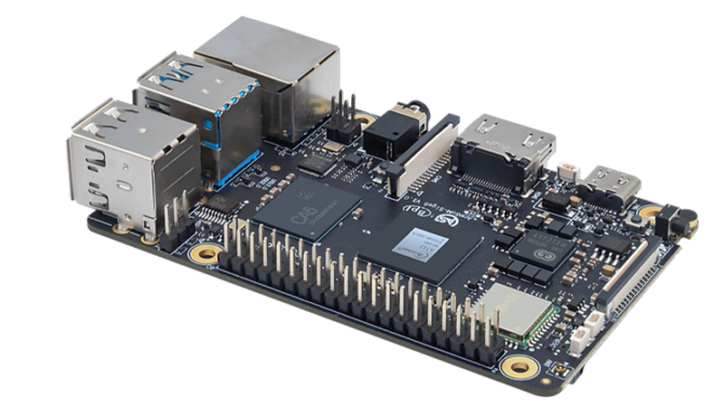

Sige6 back side specifications
