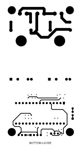

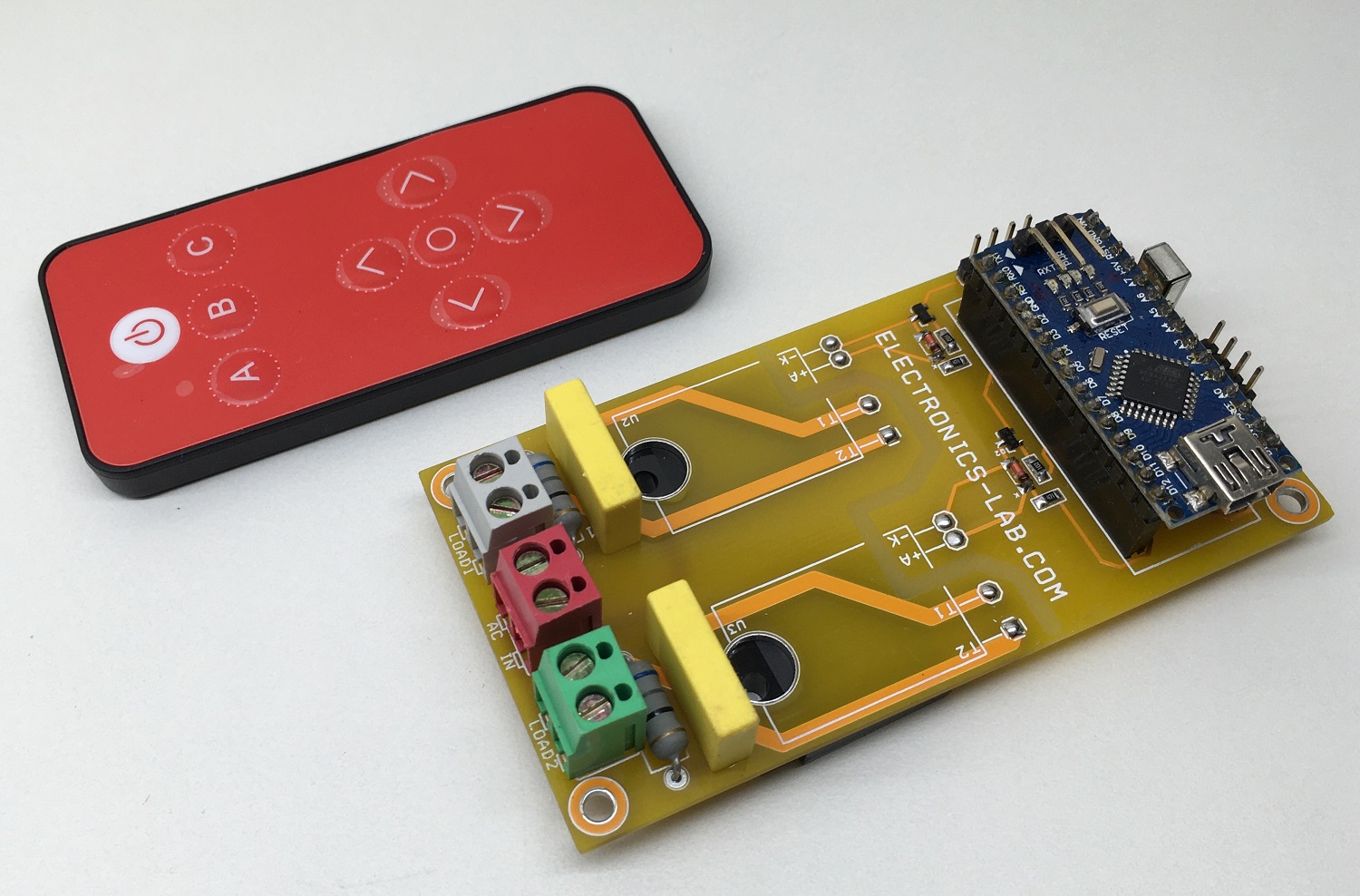

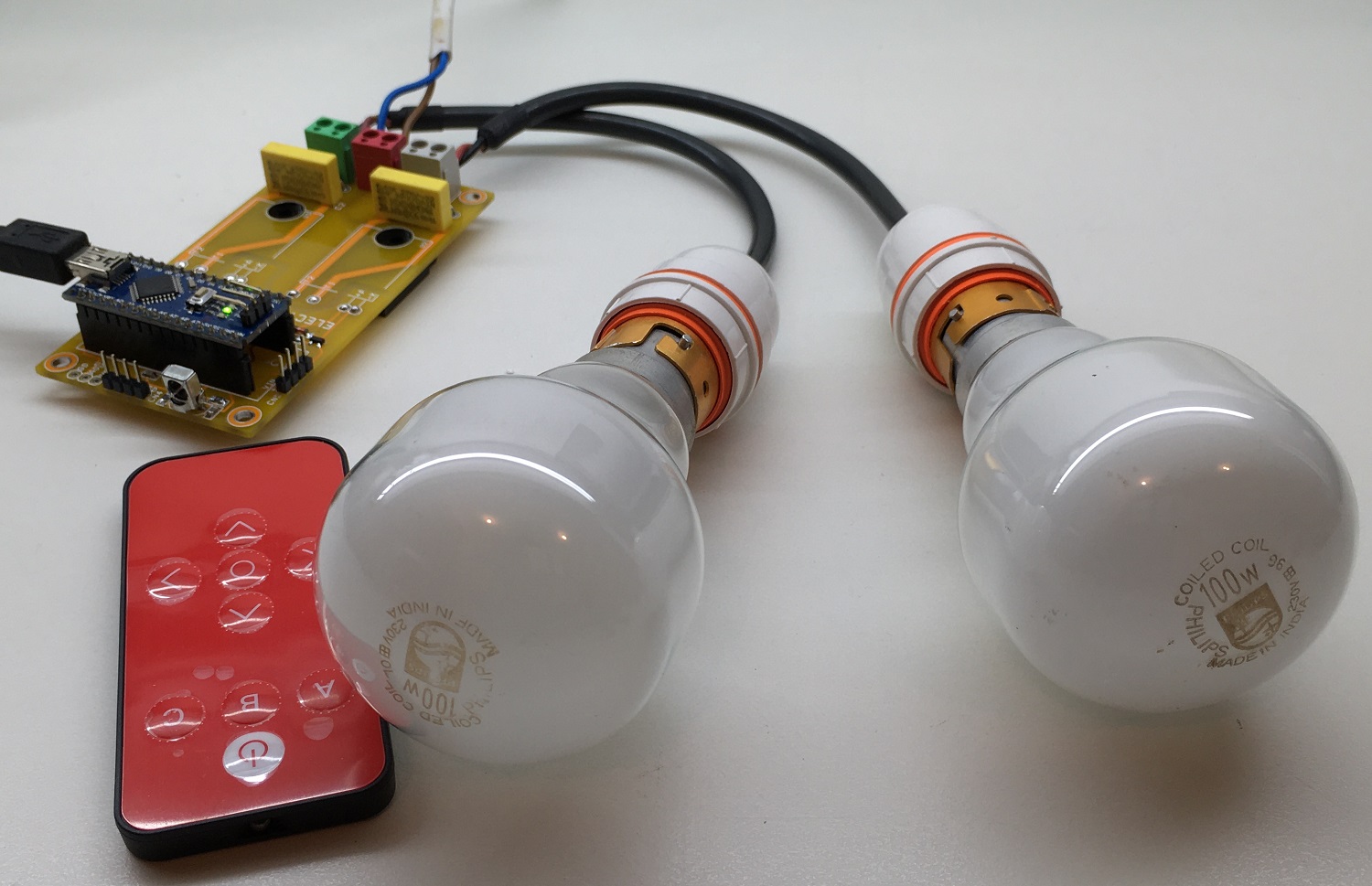

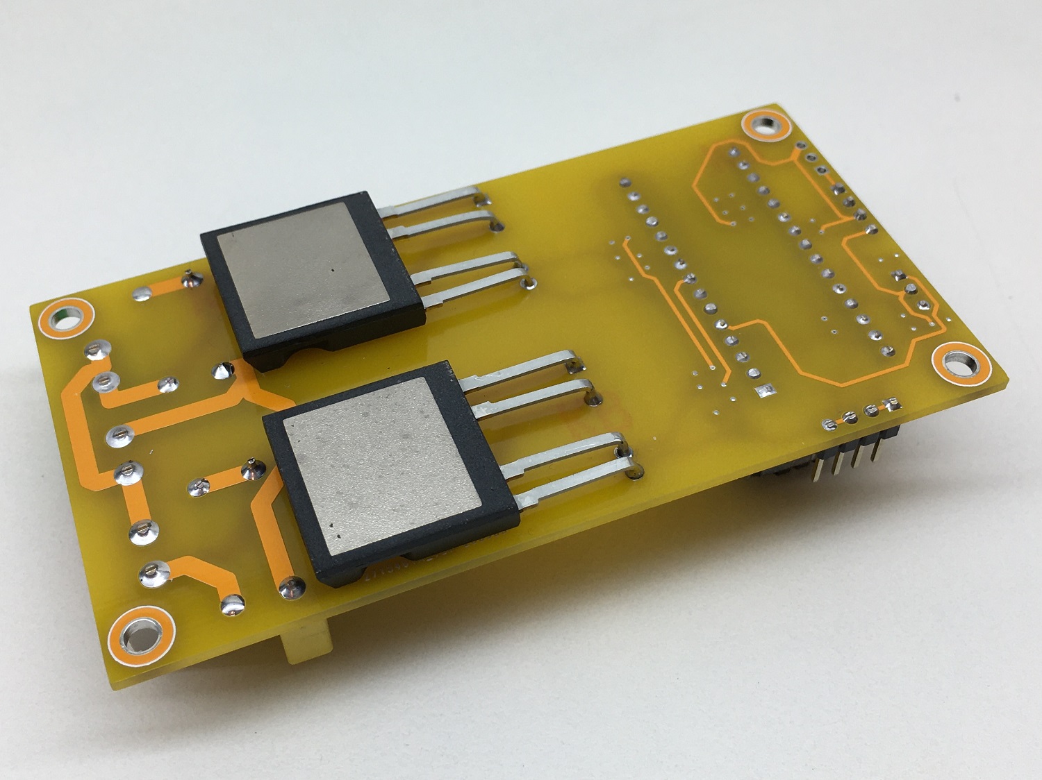

The project presented here is a two-channel infrared remote ON/OFF switch that can be used to control home appliances, Lights, Fans, Water Pumps, Aquarium pumps, Ovens, Heaters, etc. This open-source project contains 2 x SSR (Solid State Relay), Arduino Nano, and TSOP1838 infrared receiver, keeping safety in mind, optically isolated SSR (Solid State Relay) is used to have isolation between high voltage AC circuitry and Arduino Nano.

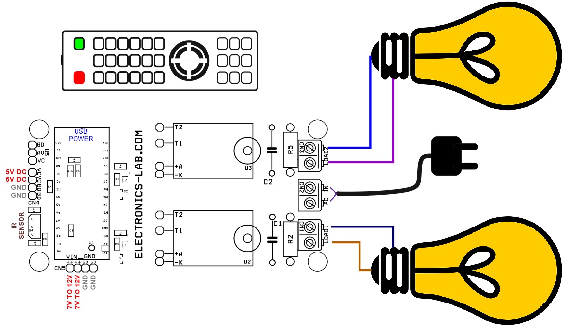

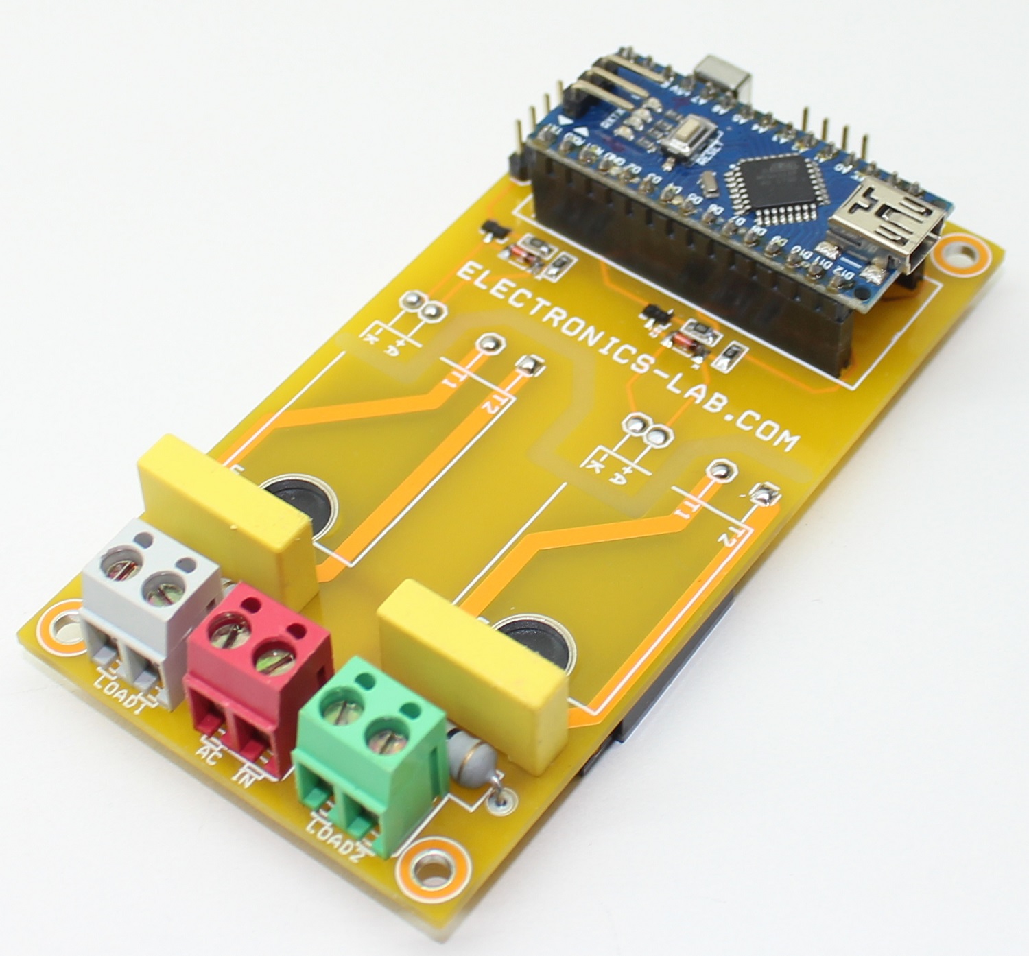

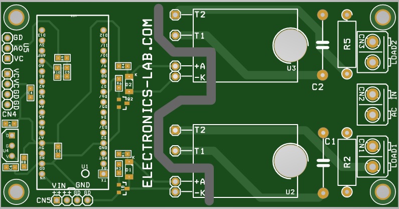

The project presented here is a two-channel infrared remote ON/OFF switch that can be used to control home appliances, Lights, Fans, Water Pumps, Aquarium pumps, Ovens, Heaters, etc. This open-source project contains 2 x SSR (Solid State Relay), Arduino Nano, and TSOP1838 infrared receiver, keeping safety in mind, optically isolated SSR (Solid State Relay) is used to have isolation between high voltage AC circuitry and Arduino Nano. The operation of the circuit is pretty simple, TSOP1838/TSOP38238 IR Sensor receives the infrared signal from IR remote, Arduino Nano decodes the IR signal which is connected to digital pin D2 and provides latch outputs on digital pins D5, and D6 in respect to IR code received from IR remote. These two digital outputs D5, D6 drive the SSR using 2 x BC847 BJT transistors. CPC1998J optically isolated solid-state relays from IXYS Integrated Circuits drive the AC loads. We have tested this board with 500W/230V AC lamps, however, the load capacity of SSR is 20A. A snubber circuit is provided across the SSR-Traic which helps driving inductive loads. Heat-sink on SSR is not required for loads up to 5A, but for higher load, it is advisable to mount a heatsink on SSR.

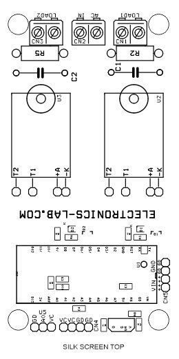

  • Components Functions: U2 & U3 SSR Relay AC Load driver, U4 TSOP1838/TSOP38238 IR Sensor, R1 & R4 Current limiting resistor for SSR LED, Q1 & Q2 LED Driver of  SSR, D1 & D2 Protection Diode for SSR LED, C1 & C2 + R1 & R5 Snubber Circuit for AC Inductive Load.
  • Connections: CN2 AC Input 110V-220V AC, CN1 Load, CN3 Load, CN4 5V DC Supply If Arduino Nano USB power is not available, CN5 DC Power (Optional) 7V to 12V if USB/5V power is not available.
  • Power Supply DC: The Arduino Nano can be powered via the Mini-B USB connection, 7-12V unregulated external power supply (CN5), or 5V regulated external power supply (CN4).

Note 1: This board can accommodate other SSR like S216S02 from Sharp, CPC1998J from IXYS or KSD215AC3 available from http://www.cosmo-ic.com
Note 2: This project also can be used for many other applications that require 2 x SSR, Optional U5 connector is provided to interface analog/digital device or sensor

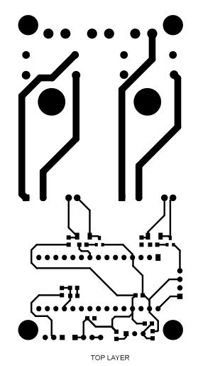

  • PCB Dimensions 98.43  x 50.80 mm
Schematic

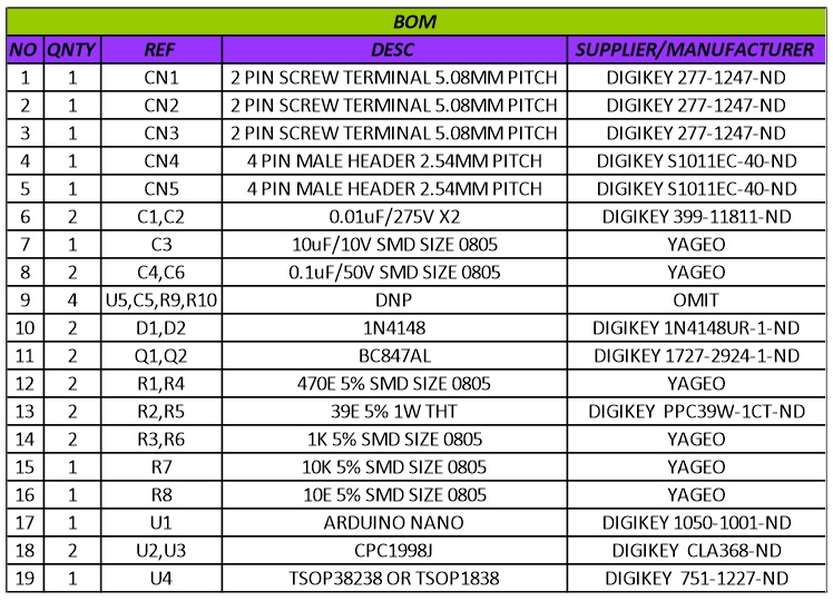

Parts List
NOQNTYREFDESCSUPPLIER/MANUFACTURER
11CN12 PIN SCREW TERMINAL 5.08MM PITCHDIGIKEY 277-1247-ND
21CN22 PIN SCREW TERMINAL 5.08MM PITCHDIGIKEY 277-1247-ND
31CN32 PIN SCREW TERMINAL 5.08MM PITCHDIGIKEY 277-1247-ND
41CN44 PIN MALE HEADER 2.54MM PITCHDIGIKEY S1011EC-40-ND
51CN54 PIN MALE HEADER 2.54MM PITCHDIGIKEY S1011EC-40-ND
62C1,C20.01uF/275V X2DIGIKEY 399-11811-ND
71C310uF/10V SMD SIZE 0805YAGEO
82C4,C60.1uF/50V SMD SIZE 0805YAGEO
94U5,C5,R9,R10DNPOMIT
102D1,D21N4148DIGIKEY 1N4148UR-1-ND
112Q1,Q2BC847ALDIGIKEY 1727-2924-1-ND
122R1,R4470E 5% SMD SIZE 0805YAGEO
132R2,R539E 5% 1W THTDIGIKEY PPC39W-1CT-ND
142R3,R61K 5% SMD SIZE 0805YAGEO
151R710K 5% SMD SIZE 0805YAGEO
161R810E 5% SMD SIZE 0805YAGEO
171U1ARDUINO NANODIGIKEY 1050-1001-ND
182U2,U3CPC1998JDIGIKEY CLA368-ND
191U4TSOP38238 OR TSOP1838DIGIKEY 751-1227-ND

Gerber View
