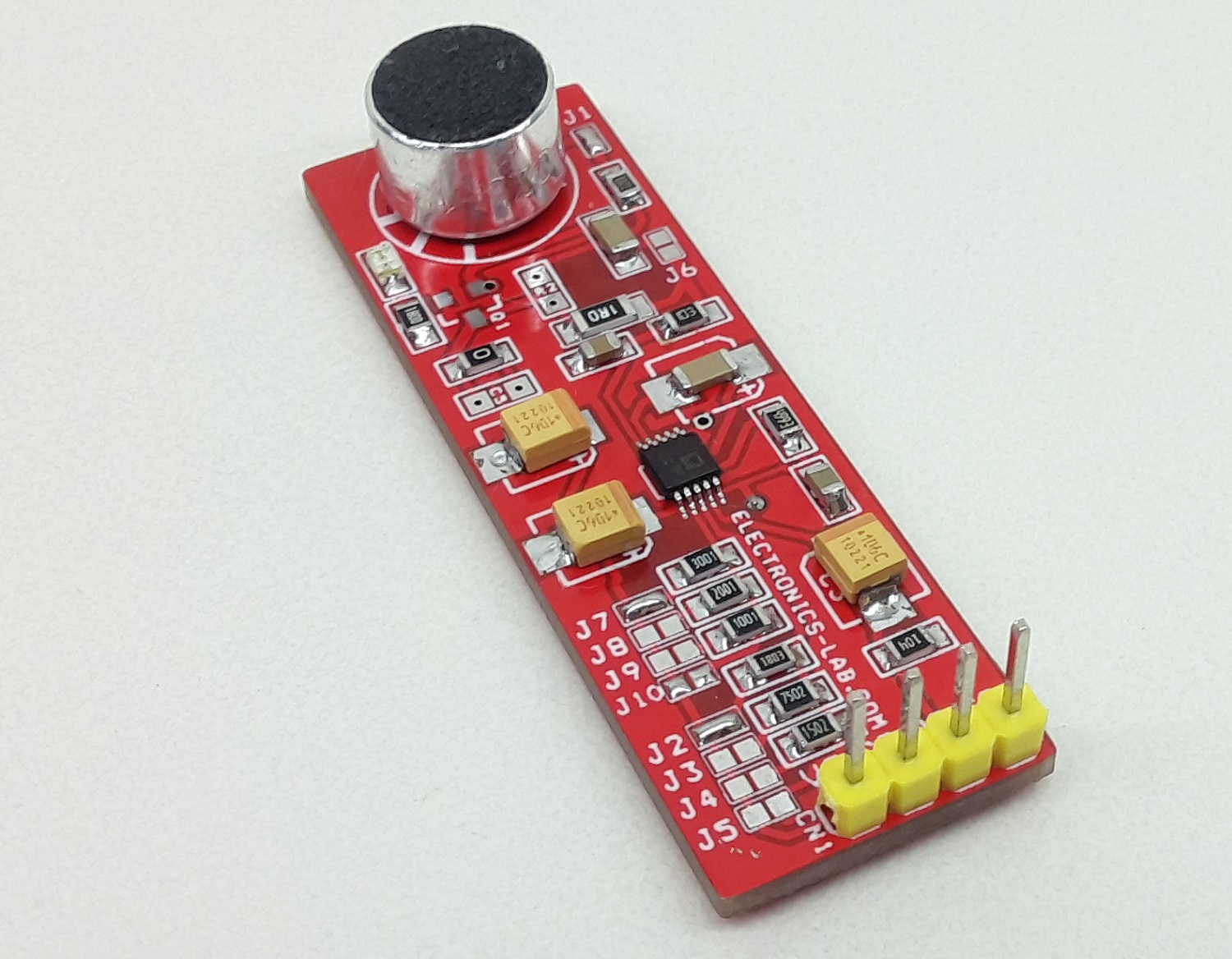

Low Voltage Microphone Preamplifier with Variable Compression and Noise Canceling
This is a complete microphone signal conditioning project. Designed primarily for voice-band applications, this project provides amplification, limiting, variable compression, and noise gate.
This is a complete microphone signal conditioning project. Designed primarily for voice-band applications, this project provides amplification, limiting, variable compression, and noise gate. User-adjustable compression ratio, noise gate threshold, and two different fixed gains optimize circuit operation for a variety of applications.
This is a complete and flexible solution for conditioning condenser microphones for personal electronics and computer audio systems. It is also excellent for improving vocal clarity in communications and the public address systems. A low noise voltage-controlled amplifier (VCA) provides a gain that is dynamically adjusted by a control loop to maintain a set compressions characteristic. The compression ratio is set by a jumper and can be varied from 1:1 to over 10:1 relative to the fixed rotation point. Signals above the rotation point are limited to prevent overload and eliminate popping.
A downward expander (noise gate) prevents the amplification of background noise or hum. This results in an optimized signal level prior to digitization, thereby eliminating the need for additional gain or attenuation in the digital domain. The flexibility of setting the compression ratio and the time constant of the level detector, coupled with two values of rotation point, make the SSM2167 easy to integrate into a wide variety of microphone conditioning applications.

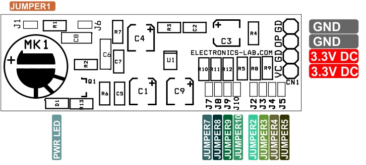

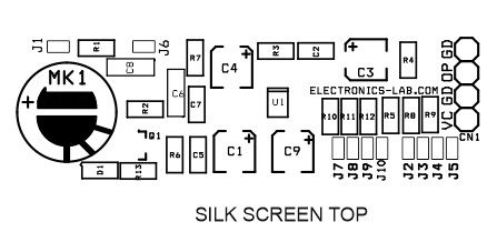

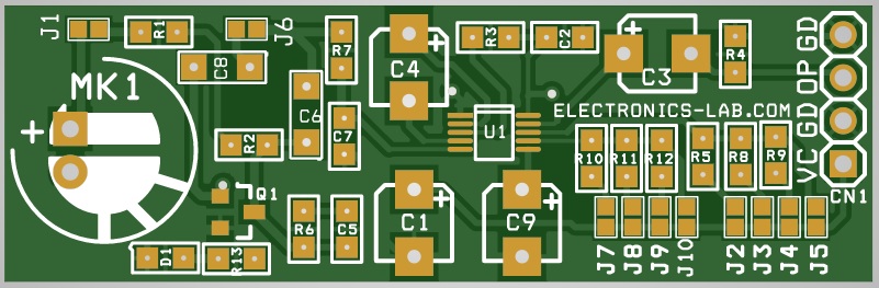

Electret Microphone or Dynamic Microphone (Project Supports Electret Microphone and Dynamic Microphone)
- Open Jumper J1 and Electret Microphone to Connect Dynamic Microphone or self-power microphone.
- Close Jumper J1 for Electret Microphone
Setting The Compression Ratio (PCB Solder Jumper) Jumper J2 Compression Ration 10:1
- Jumper J2 Compression Ration 10:1
- Jumper J3 Compression Ration 5:1
- Jumper J4 Compression Ration 2:1
- Jumper J5 Compression Ration 1:1
Setting The Noise Gate Threshold (PCB Solder Jumper) Noise gate keeps the background sounds subdued.
- Jumper J7 Noise Gate (dBV) -55
- Jumper J8 Noise Gate (dBV) -54
- Jumper J9 Noise Gate (dBV) -48
- Jumper J10 Noise Gate (dBV) -40

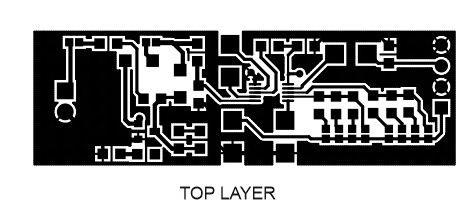

- Operating Supply 3.3V DC
- On Board Condenser Microphone
- On Board Power LED
- Jumpers to Set Various Noise Gate (J7, J8, J9, J10)
- Jumpers to Set Various Compression Ratio (J2, J3, J4, J5)
- Jumper J1 for Biasing Voltage to Microphone, Open if Biasing Supply not Required

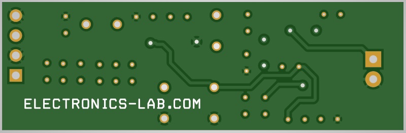

- PCB Dimensions 51.12 x 16.35 mm

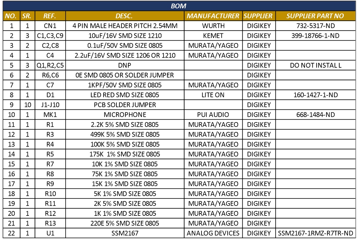

Parts List
| NO. | SR. | REF. | DESC. | MANUFACTURER | SUPPLIER | SUPPLIER PART NO |
| 1 | 1 | CN1 | 4 PIN MALE HEADER PITCH 2.54MM | WURTH | DIGIKEY | 732-5317-ND |
| 2 | 3 | C1,C3,C9 | 10uF/16V SMD SIZE 1210 | KEMET | DIGIKEY | 399-18766-1-ND |
| 3 | 2 | C2,C8 | 0.1uF/50V SMD SIZE 0805 | MURATA/YAGEO | DIGIKEY | |
| 4 | 1 | C4 | 2.2uF/16V SMD SIZE 1206 OR 1210 | MURATA/YAGEO | DIGIKEY | |
| 5 | 3 | Q1,R2,C5 | DNP | DIGIKEY | DO NOT INSTAL L | |
| 6 | 2 | R6,C6 | 0E SMD 0805 OR SOLDER JUMPER | DIGIKEY | ||
| 7 | 1 | C7 | 1KPF/50V SMD SIZE 0805 | MURATA/YAGEO | DIGIKEY | |
| 8 | 1 | D1 | LED RED SMD SIZE 0805 | LITE ON | DIGIKEY | 160-1427-1-ND |
| 9 | 10 | J1-J10 | PCB SOLDER JUMPER | DIGIKEY | ||
| 10 | 1 | MK1 | MICROPHONE | PUI AUDIO | DIGIKEY | 668-1484-ND |
| 11 | 1 | R1 | 2.2K 5% SMD SIZE 0805 | MURATA/YAGEO | DIGIKEY | |
| 12 | 1 | R3 | 499K 5% SMD SIZE 0805 | MURATA/YAGEO | DIGIKEY | |
| 13 | 1 | R4 | 100K 5% SMD SIZE 0805 | MURATA/YAGEO | DIGIKEY | |
| 14 | 1 | R5 | 175K 1% SMD SIZE 0805 | MURATA/YAGEO | DIGIKEY | |
| 15 | 1 | R7 | 10K 1% SMD SIZE 0805 | MURATA/YAGEO | DIGIKEY | |
| 16 | 1 | R8 | 75K 1% SMD SIZE 0805 | MURATA/YAGEO | DIGIKEY | |
| 17 | 1 | R9 | 15K 1% SMD SIZE 0805 | MURATA/YAGEO | DIGIKEY | |
| 18 | 1 | R10 | 5K 1% SMD SIZE 0805 | MURATA/YAGEO | DIGIKEY | |
| 19 | 1 | R11 | 2K 5% SMD SIZE 0805 | MURATA/YAGEO | DIGIKEY | |
| 20 | 1 | R12 | 1K 1% SMD SIZE 0805 | MURATA/YAGEO | DIGIKEY | |
| 21 | 1 | R13 | 220E 5% SMD SIZE 0805 | MURATA/YAGEO | DIGIKEY | |
| 22 | 1 | U1 | SSM2167 | ANALOG DEVICES | DIGIKEY | SSM2167-1RMZ-R7TR-ND |
