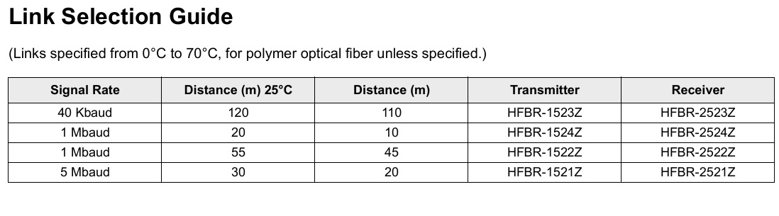

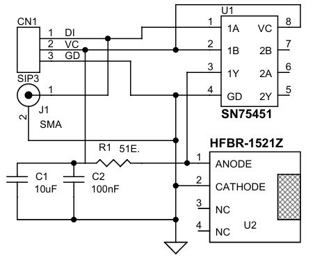

The transmitter incorporates a 660-nm LED. IC U1 and resistor R1 supply the majority of the drive current to the LED. The design uses the HBBR-1521Z transmitter module, which supports data rates up to 5 Mbaud. For applications requiring different data rates, refer to the provided table for suitable replacement modules supporting both lower and higher speeds.

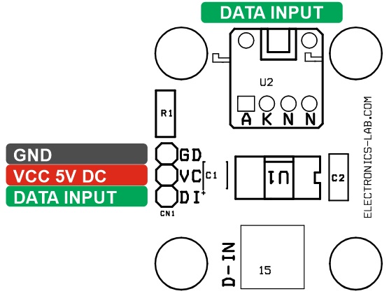

Connections
  • CN1: Pin 1 = Data Input, Pin 2 = VCC 5V DC, Pin 3 = GND
  • J1: SMA Connector for the Data Input
Schematic
Parts List
NO.QNTY.REF.DESC.MANUFACTURERSUPPLIERSUPPLIER PART NO
11CN13 PIN MALE HEADER PITCH 2.54MMWURTHDIGIKEY732-5316-ND
21C110uF/16V TANTLUM 1210YAGEO/MURATADIGIKEY
31R151E 1% SMD SIZE 1206YAGEO/MURATADIGIKEY
41U1SN75451 DIP8TIDIGIKEY296-1746-5-ND
51U2HFBR-1521ZBROADCOMDIGIKEY516-2043-ND
61C2100nF/50V CERAMIC SMD SZE 1206YAGEO/MURATADIGIKEY
71J1SMA CONNECTOR RIGHT ANGLEADAM TECHDIGIKEY2057-RF2-03E-T-00-50-G-ND

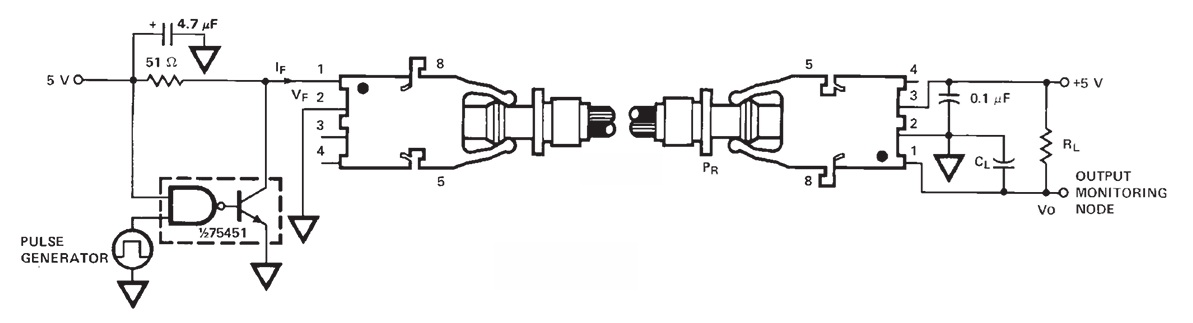

Application Diagram

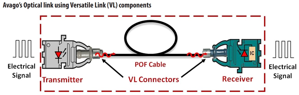

Cable Connection
Connections

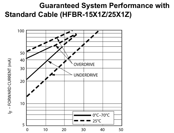

System Performance vs Cable Selection

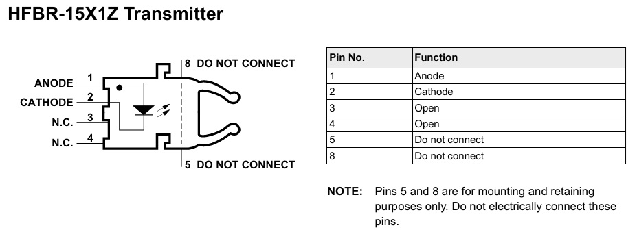

Transmitter Connector
Link Selection Guide

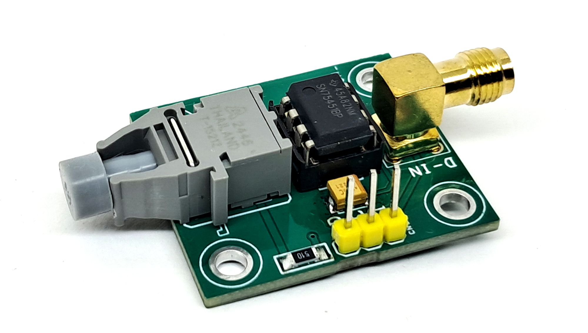

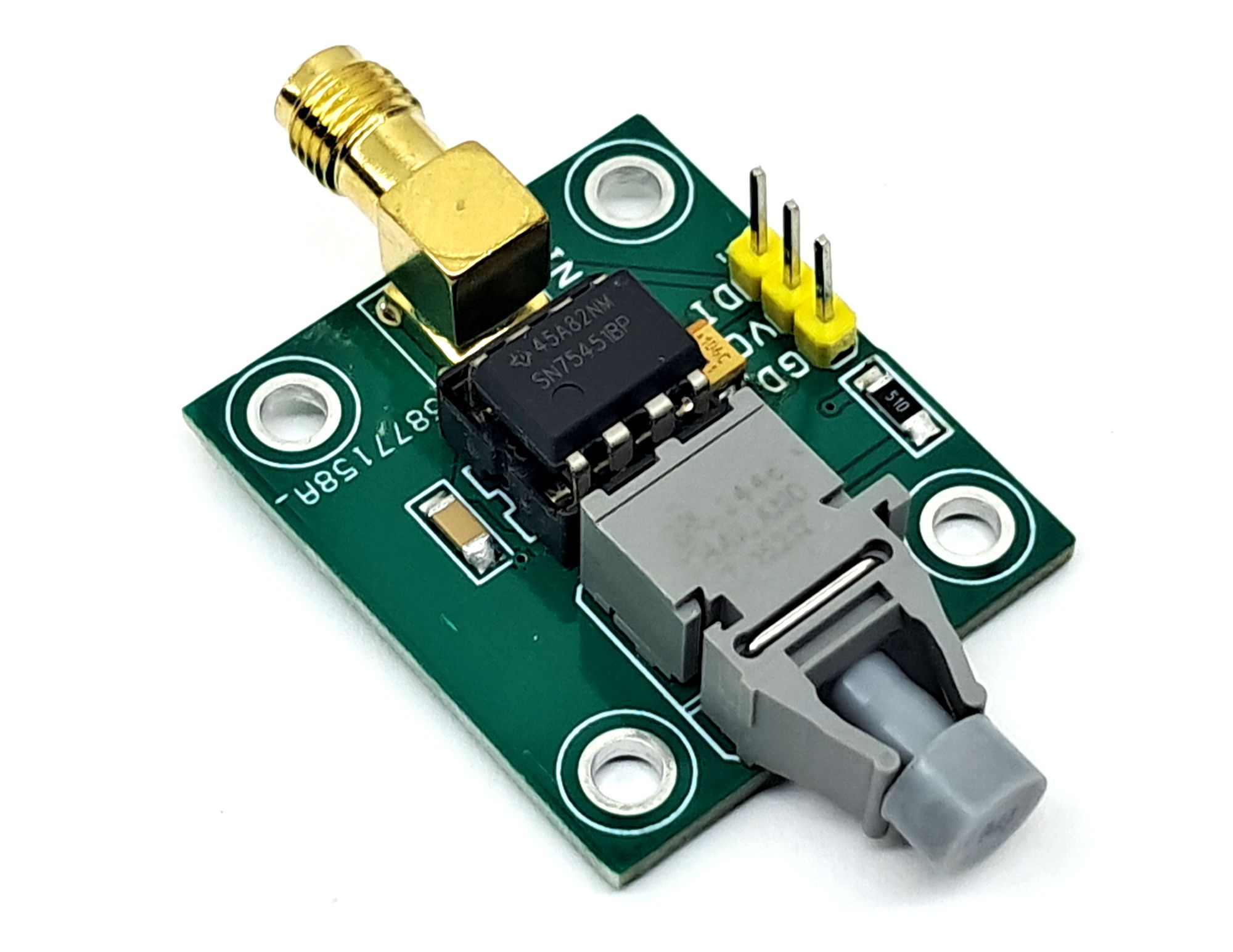

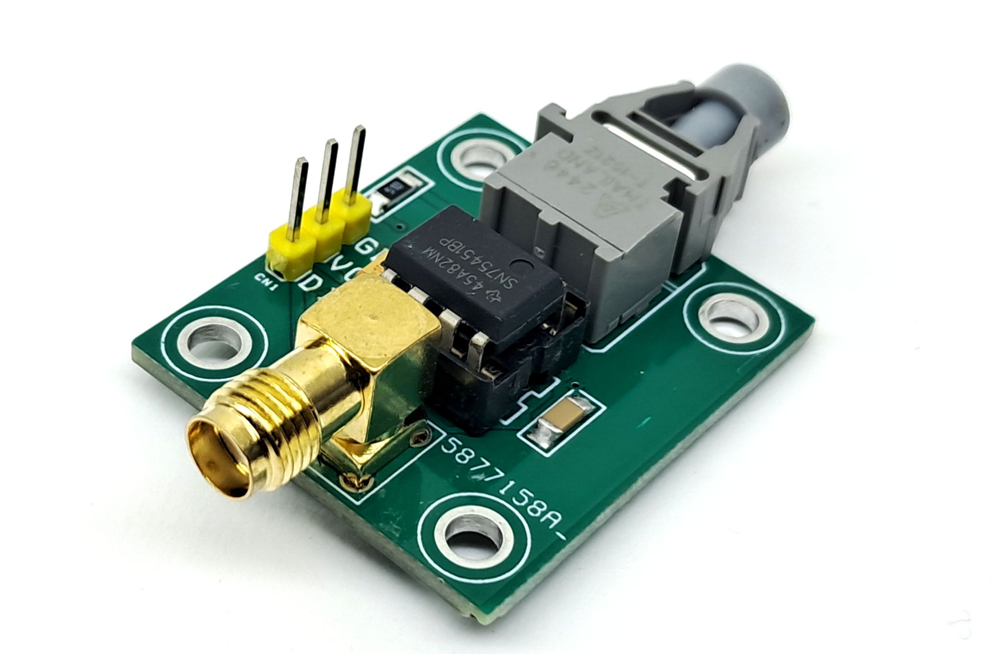

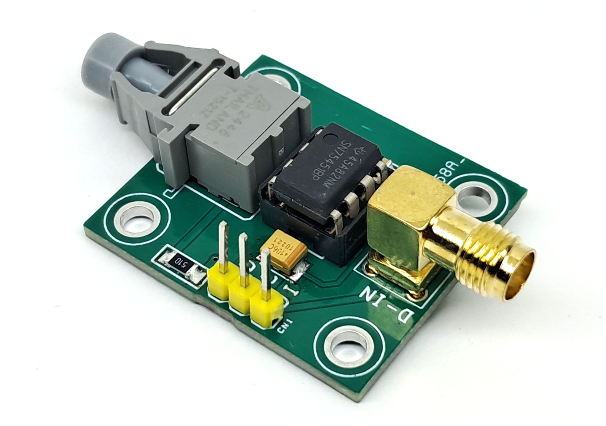

Photos
