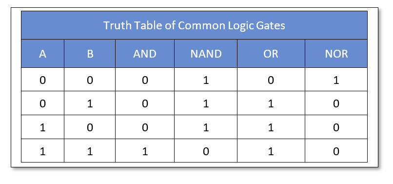

The truth table comprising of AND, NAND, OR, and NOR logic functions against two inputs is given below. These logical functions are used in DeMorgan’s Theorems and, as such, given to recall these logical operations.

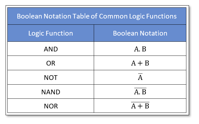

The above given logical functions are denoted by equivalent Boolean notations. A “.” between operands means AND (Multiplication) operation, a “+” means OR (Sum) operation, and overline means an inversion of the operand. The equivalent Boolean notations of commonly used logical functions are shown in the following table.

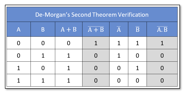

Verification of DeMorgan’s Second Theorem using Truth Table
DeMorgan’s Second Theorem can be verified using a truth table as illustrated below:

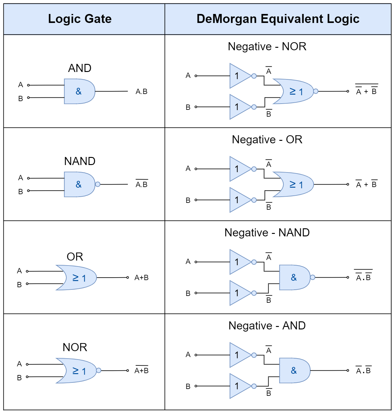

DeMorgan’s Equivalent Gates
The standard logic gates i.e. AND, NAND, OR, and NOR representing DeMorgan’s theorems can be obtained.  It has already been discussed above that the NAND (AND + NOT) operation can be replaced by the OR logic on inverted inputs. Here, firstly, AND logic is replaced with the OR, and, secondly, the inversion is applied at the inputs and outputs. Resultantly, the AND + NOT logic becomes NOT + OR. The inputs which were originally not inverted become inverted and inverted output becomes non-inverted. The same can be applied to DeMorgan’s Second Theorem to obtain equivalent logic gates.
The following table shows the standard equivalent logic gates of DeMorgan’s theorems.
