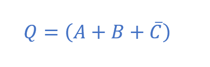

The Product-of-Sum (POS) expresses the combinational logic as two or more sums are multiplied together. In logical terms, the outputs of two or more OR functions (constituting sums) are connected to AND function (multiplied together) to give Product-of-Sum. It is an OR-AND logic operation having two or more OR terms and only one AND term. A few examples of Product-of-Sum (POS) are given below:
And,

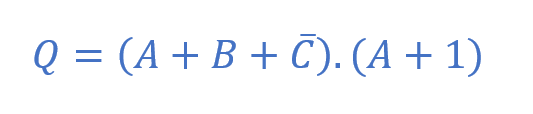

Another, non-standard POS form:
Which can be further reduced to:
Further to,
And,

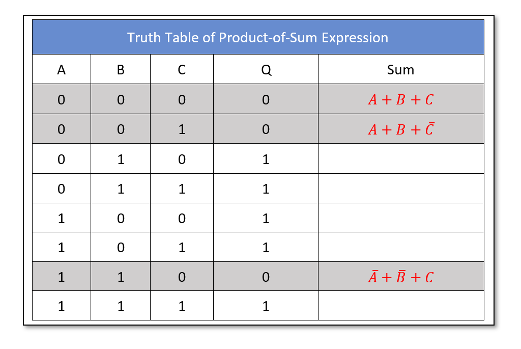

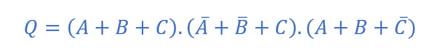

A truth table can be constructed from a product-of-sum expression and, conversely, a product-of-sum expression from a truth table. The sum terms in the product-of-sum expression, each produce a logic “0” for the specific input states. For example, the A+B+C term will produce a “0” state when A=1, B=1, & C=1. Similarly, A+B+C’ is “0” when A=1, B=1, & C=0. In a similar manner, the truth table is constructed for all the sum terms for the specific inputs’ states and their output is set to “0”. The output of all other states is set to “1”.  Consider the following Boolean expression:
The following truth table is drawn for all of the possible states of A, B, and C. The output of the above expression is set to “0” for all the sums in terms of product-of-sum expression at their specific input states.
It is obvious from the above table that sum terms are set to “0” for that specific state of inputs and the rest of the output states are set to “1”. When any of the terms is “0” then AND (product) function sets the output to “0”.
Likewise, a Boolean product-of-sum (POS) expression can be constructed from a given truth table. Consider the following truth tables.
From the above truth table, the following product-of-sum expression is derived.

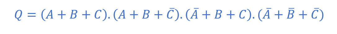

Consider the following given Boolean expression:
If the expression is in the non-standard form of the product-of-sum then it needs to be converted into standard form before proceeding further. The given expression is in standard form.
The following truth table is constructed from the above product-of-sum expression.

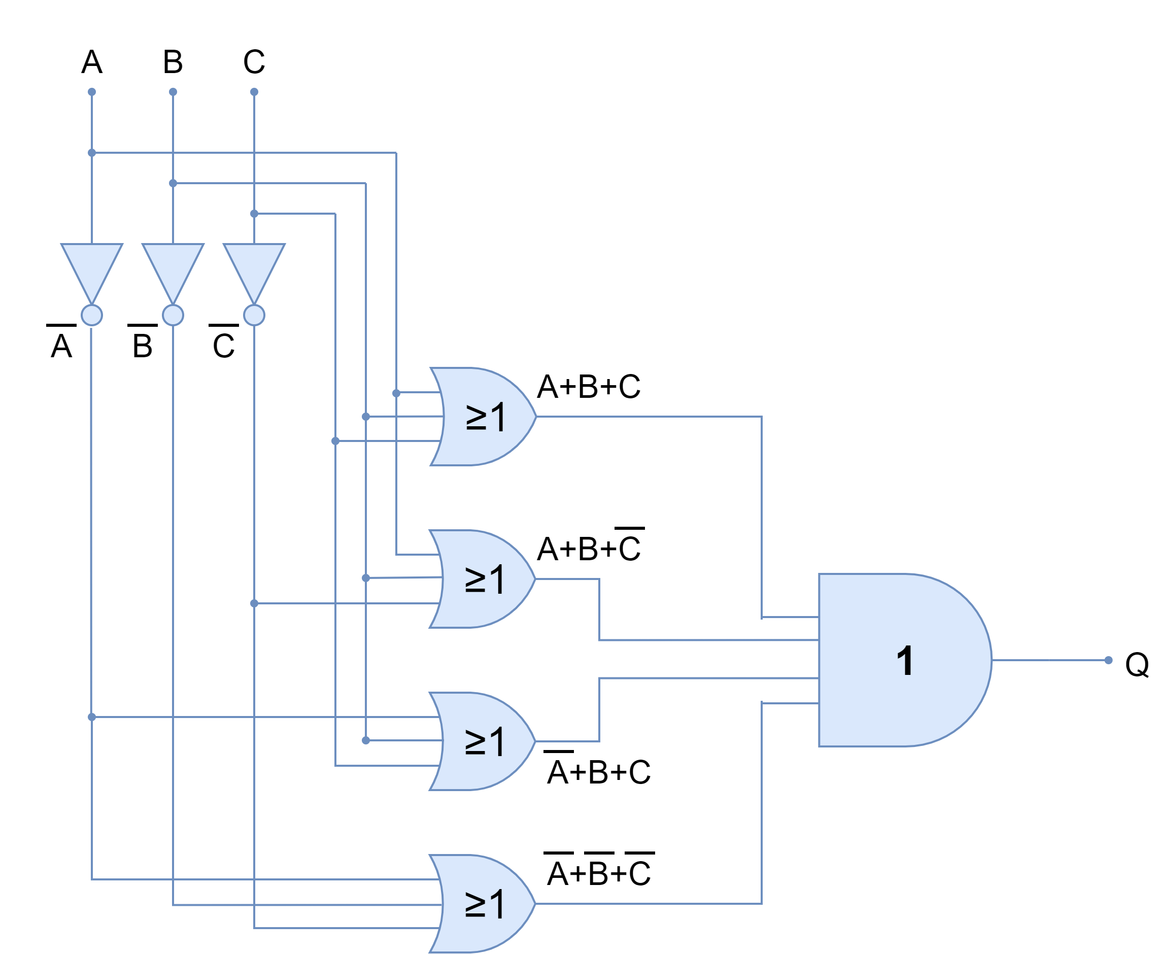

From the given product-of-sum following logic diagram is created.
Figure 3: The Logic Gate diagram of POS expression
Following the above example, from any truth table, a product-of-sum expression can be derived and can ease the process of creating a logic diagram.
