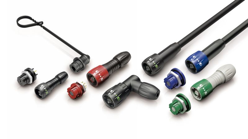

Standard connectors leave their contacts exposed when disconnected, relying on protective caps or careful handling to keep out dust and moisture. Binder’s NCC family addresses this with an integrated, spring-loaded plastic cover built into the female panel-mount connector. The cover automatically closes the interface the moment the connector is unplugged.
Binder’s NCC family offers ingress protection, even when unmated
Binder’s NCC family offers ingress protection, even when unmated. Image used courtesy of Binder
The protection ratings back this up. Series 670 (subminiature, 5-pin) achieves IP54 when unmated and IP67 when mated. Series 770 (miniature, 8-pin) reaches IP67 in both states. For equipment that gets frequently plugged and unplugged in industrial or lab environments, that’s a meaningful reduction in contamination risk without any extra steps from the user.
Both series use a bayonet locking system that allows tool-free mating with a single quarter-turn motion. Series 670 is rated for more than 1,000 mating cycles, while series 770 handles more than 5,000 — making either a reasonable choice for high-frequency connection applications. The spring mechanism driving the sealing cap is designed to maintain a consistent return force across the full rated cycle life.
