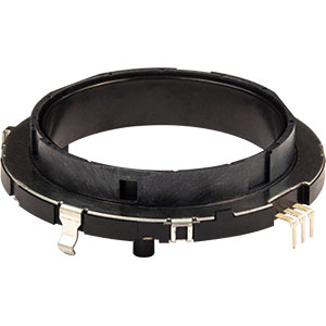

Bourns' PER28/PER35/PER56 encoders feature a ring interface that allows illumination or installation of other components in the center Bourns’ model PER28, PER35, and PER56 long-life incremental ring encoders come in sizes 28 mm, 35 mm, and 56 mm, respectively. These low-profile encoders are designed for use in professional audio and lighting applications, low/medium risk medical and laboratory equipment, industrial automation controls, and other applications where a menu select encoder is required.

Bourns’ model PER28, PER35, and PER56 long-life incremental ring encoders come in sizes 28 mm, 35 mm, and 56 mm, respectively. These low-profile encoders are designed for use in professional audio and lighting applications, low/medium risk medical and laboratory equipment, industrial automation controls, and other applications where a menu select encoder is required. These models feature a ring interface that allows illumination or installation of other components in the center.
  • Low-profile incremental encoders
  • THT mounting style
  • 50,000 rotational cycle rating
  • Haptic detent feedback
  • RoHS compliant
