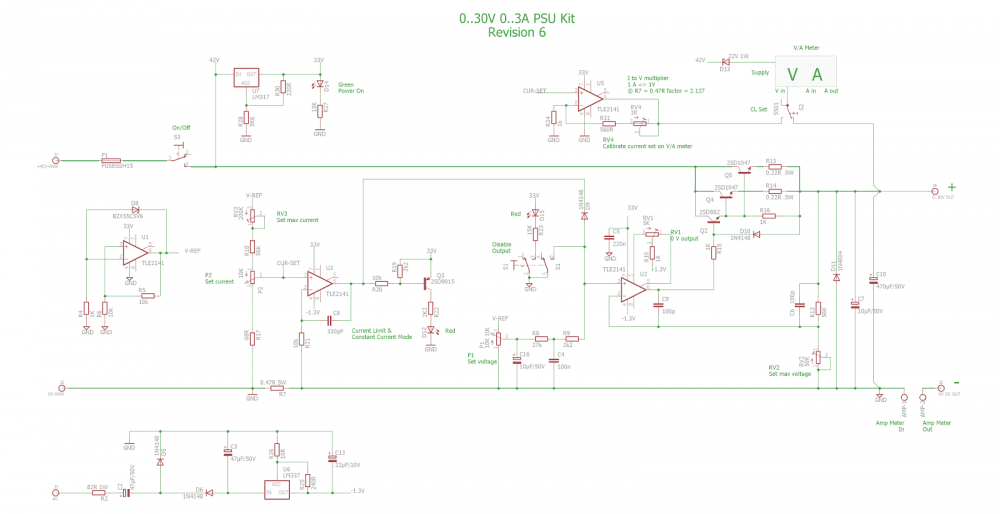

audioguru Posted August 31, 2019 Report Posted August 31, 2019 The 24VAC transformer probably produces 25VAC with a light load on the project. Then its rectified and filtered output is +34V and -5.6V which power the opamps. At times the voltages are higher. Your transformer will be overloaded if its power rating is 105VA or less (24V at 4.4A).. The old TL081 opamps have an absolute maximum allowed supply of a total of only 36V so they will not last long. Replace the opamps with TLE2141 opamps that have a maximum allowed supply of 44V. Many of the resistors and the driver transistor in the original project are overloaded. Upgrade them. The main filter capacitor C1 value is much too low, upgrade it. frisil 1 Quote

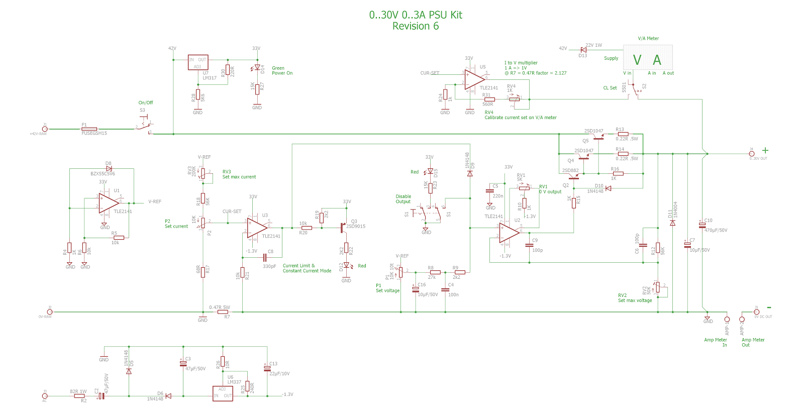

admin Posted January 2, 2020 Report Posted January 2, 2020 I am attaching a Troubleshooting FAQ’s I found for this power supply. It summarizes the 150 pages of an old thread into a single document. Hope this helps get some questions answered. 0-30V 0-3A Bench Power Supply Unit Troubleshooting FAQ’s.pdf Dibagay 1 Quote

paul .a larner Posted November 25, 2020 Report Posted November 25, 2020 ive built this psu,when q1 is connected u2 gets hot+ output drops to 0,if i cut the emitter of q1 it seems to work ok,any ideas,btw in cc mode i get a spike on switch off,in cv mode its fine,cheers in advance. Quote
HarryA Posted November 25, 2020 Report Posted November 25, 2020 There are others who are more qualified than I on this circuit but not letting ignorance stand in my way I will continue anyway. In the various schematics U2 is connected to a transistor base through a 0, 22, or 1k ohm resistor. So it makes a difference which schematics you are referring to. At 1k the current from Q2 would be limited to 33v/1k or 33ma well within the 88ma max. of U2. Else for the 0 or 22 ohms I would wonder about diode D10 if it is shorted or not. Quote
paul .a larner Posted November 26, 2020 Report Posted November 26, 2020 well i found d7 shorted,that fixed the u2 getting hot+low output issue,only trouble is now is with the current regulation,its like all or nothing,when it goes into cc mode,if i wind the volt pot ccw the led stays lit,funny tho as it still lets me turn the voltage up when in indicated cc mode,r18 is 33k. Quote
