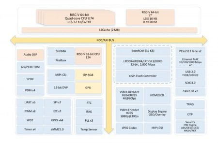

The block diagram of Jinghong 7110 shows us the inner workings of the RISC-V Quad-core CV-U74 chipset. At its core, it runs at 1.5 GHz and uses L1 and L2 caches for fast data access. The chipset has two main paths: one for the core and another for added features. It features a dedicated Audio DSP and for video processing, it has a GPU with an encoder and decoder. For connecting to other devices, it uses ports like PCIe, Ethernet, and HDMI. Essentially, this chipset combines technical specifics with broad functionality.

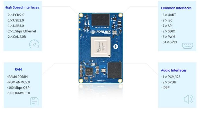

FET7110-C SoM Specifications:
  • Memory: 2/4GB LPDDR4 RAM; Storage: 32GB eMMC 5.0, 100 Mbps QSPI, SD 3.0/MMC 5.0
  • Connectivity: 2x GMAC (10/100/1000 Mbps)
  • Display: HDMI 2.0 (4K@30fps), 1x 4-lane MIPI DSI (2K@30fps)
  • Audio: 8-lane I2S PCM/TDM
  • Camera: 1x 4-lane MIPI-CSI
  • Expansion: PCIe2.0 (1x lane, 2 integrated controllers)
  • USB: 1x USB 2.0, 1x USB 3.0
  • I/O: 6x UART, 7x I2C, 7x SPI, 1x SDIO, 8x PWM, 64x GPIOs, 2x CAN 2.0B
  • Power: 5V DC; OS: Linux 5.15.0
  • Size: 60 x 38mm; Connectors: 3x 80-pin B2B

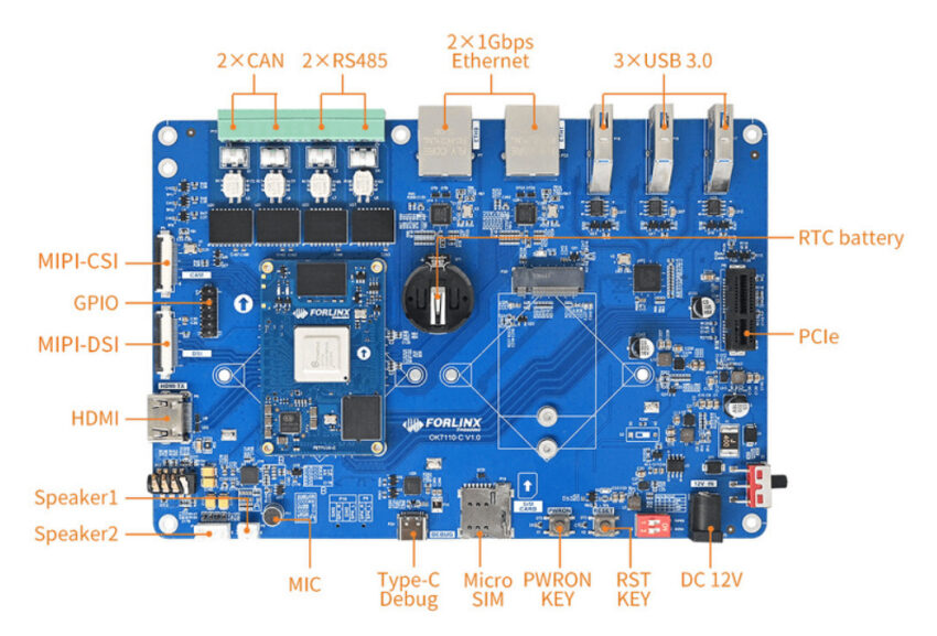

OK7110-C Development Board Specifications:
  • Connectivity: 2x Gigabit Ethernet ports
  • Display: 1x HDMI 2.0, 1x MIPI DSI; Audio: 2x Speakers, 1x Mic
  • Camera: 1x MIPI-CSI
  • Expansion: 2x PCIE 2.0, 1x Micro SIM
  • USB: 1x USB Type-C, 3x USB 3.0
  • I/O: 2x CAN, 2x RS485
  • Extras: Power button, Reset Key, RTC battery
  • Power: 12V DC (barrel connector)
  • Connectors: 3x 80-pin B2B
