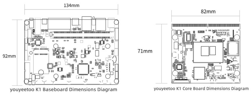

Youyeetoo has recently released the K1, a new modular Edge AI SBC built around the Intel N100 x86 Processor “Alder Lake-N” quad-core chip. Unlike the standard N100 Mini PCs like the MeLE QuieterDL, Palmshell SLiM X4L, or the MINIX Z100-AERO, the K1 adopts a  SoM plus Carrier Board approach designed with industrial interfaces like 27x GPIOs, 4x UARTs, and MIPI/eDP display options alongside standard features like Dual 4K HDMI and Dual Gigabit Ethernet.

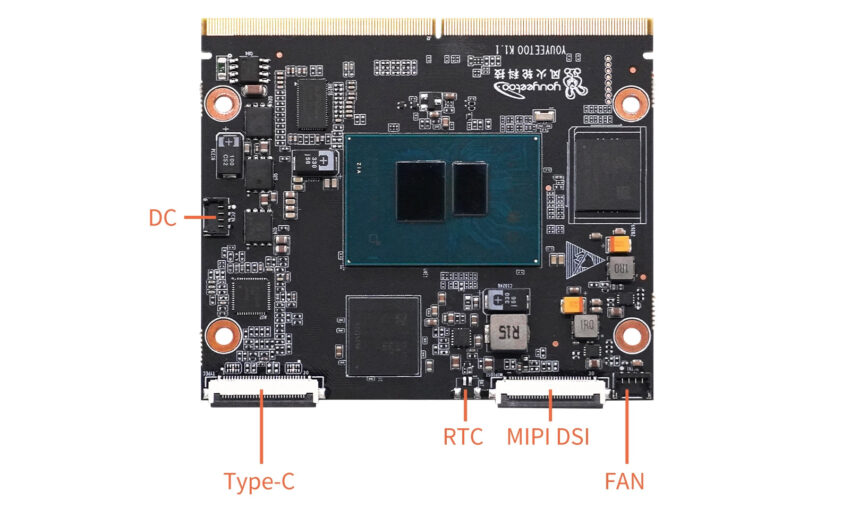

The system is built around an 82 × 71 mm Core Board (SoM) containing the CPU, RAM, and eMMC, and interestingly, the product page mentions that “SOM B” can be used independently, whereas the standard “SOM A” requires the carrier board for power. The SoM A varinet snaps onto a larger 134 × 92 mm carrier board that breaks out the physical I/O for industrial HMI, digital signage, and OpenWrt-based gateway applications.

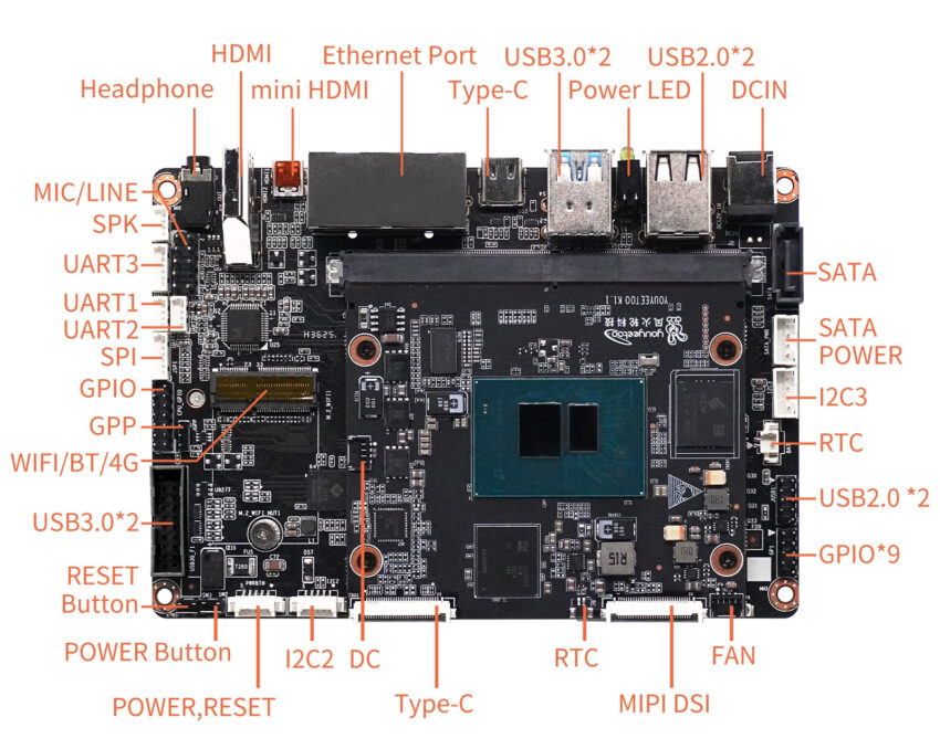

N100 x86 Edge AI SBC Hardware Overview: SoM + Carrier Board

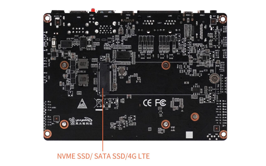

  • Storage:
    • Optional eMMC flash up to 256GB
    • 1x M.2 2280 NVMe/SATA SSD socket
    • 1x SATA 3.0 port for 2.5-inch drives
  • Video Output:
    • 2x HDMI 2.0 ports up to 4K @ 60 Hz
    • MIPI DSI interface
    • eDP interface
    • Support for touch screens is mentioned
  • Camera I/F: MIPI CSI connector
  • Audio:
    • 3.5mm headphone/mic jack, Line-in
    • Speaker output with onboard amplifier (8Ω, 2W)
    • Digital audio via HDMI
  • Networking:
    • 2x Gigabit Ethernet RJ45 ports
    • M.2 Key-E (2230) socket for Wi-Fi/Bluetooth
    • Optional 4G LTE support via module
    • NFC antenna connector (optional)
  • USB:
    • 2x USB 3.0 Type-A
    • 2x USB 2.0 Type-A
    • 1x USB-C (OTG & Power)
    • plus internal USB 2.0/3.0 headers
  • Serial: 4x UART (RS-232/485 ready)
  • Expansion:
    • 27x GPIO via 9-pin header
    • 2x UART TTL (convertible to RS-232/RS-485)
    • 1x I2C, 1x SPI, PWM, Analog inputs
  • Misc:
    • Hardware Watchdog
    • Auto Power-on support
    • NFC API support
    • RTC with battery support
    • Programmable LEDs
    • Fan control
  • Power Supply: 12V DC via 5.5×2.5mm jack or XH-2A header
  • Dimensions:
    • Core Board: 82 × 71 mm
    • Carrier Board: 134 × 92 mm

Carrier Board (Bottom Side)
Youyeetoo K1 SoM Interfaces

Youyeetoo K1 ultra-compact x86 Edge AI SBC Dimensions
SoM and Development Board Dimensions
