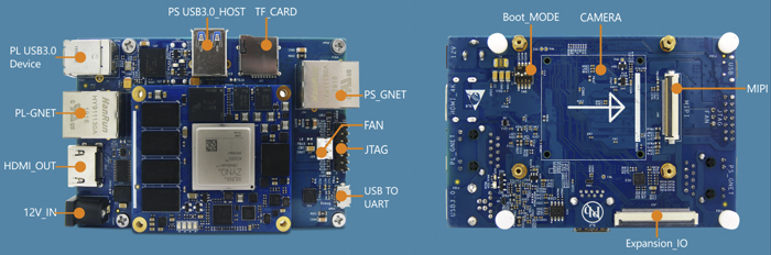

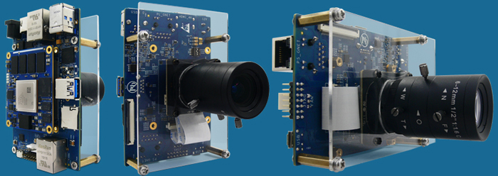

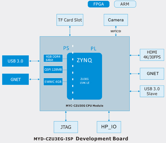

The VECP Starter Kit is using Xilinx Zynq UltraScale+ ZU3EG solution and comes with a MYD-CZU3EG-ISP development board as well as some accessories to help users start their development rapidly. The MYD-CZU3EG-ISP board consists of a MYC-CZU3EG CPU Module with installed active heatsink, a base board and a SONY imx334 4K Sensor which is installed on the rear of the base board and connected to the board MIPI-CSI interface through an FPC cable. The board is ready to run Linux OS and provided with plenty of software resources.

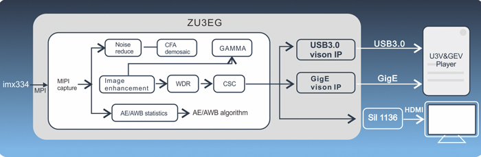

The MYD-CZU3EG-ISP development board shows outstanding image processing performance through the built-in ISP core which is capable of handling 4K video at 30fps and implementing ultra-low delay video transmission at maximum 0.7ms. It also has integrated IP cores for high-speed video standards like GigE Vision and USB3 vision to allow the image transmission via the Gigabit Ethernet or USB 3.0 from the board FPGA logic part.
