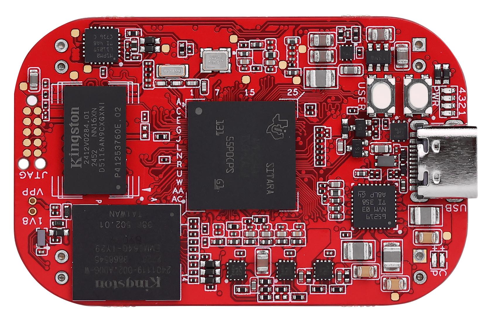

The PocketBeagle 2 Industrial SBC introduces an industrial-grade variant of the compact PocketBeagle 2 platform designed for embedded development and industrial deployments. This version keeps the same ultra-small 55 × 35 mm board layout while adding higher memory capacity, onboard storage, and support for extended operating temperatures. The board targets engineers building prototypes, industrial controllers, and compact embedded systems that require reliability in demanding environments.
Unlike the standard PocketBeagle 2, the PocketBeagle 2 Industrial SBC integrates 1GB DDR4 RAM and 64GB eMMC flash, while also supporting an industrial operating temperature range from -40°C to 85°C. The original model only includes 512MB DDR4 RAM and leaves the eMMC footprint unpopulated. These upgrades remove the need for external storage in many deployments and make the board suitable for long-term industrial use. The design continues to focus on flexibility with large GPIO access, debugging interfaces, and low power consumption.
The board runs on the Texas Instruments AM6254 SoC, which integrates four Arm Cortex-A53 cores running up to 1.4 GHz along with a Cortex-M4F real-time processor for deterministic tasks. The SoC also includes the PRUSS programmable real-time subsystem for industrial I/O control and timing-critical applications. In addition to the main processor, the board includes a Texas Instruments MSPM0L1105 Cortex-M0+ microcontroller that provides ADC capabilities and auxiliary control functions.
PocketBeagle 2 Industrial SBC Front Side

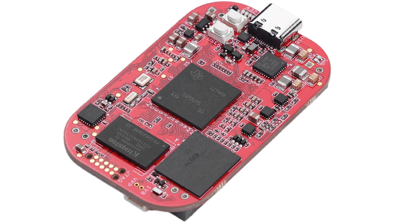

PocketBeagle 2 Industrial SBC Top Side

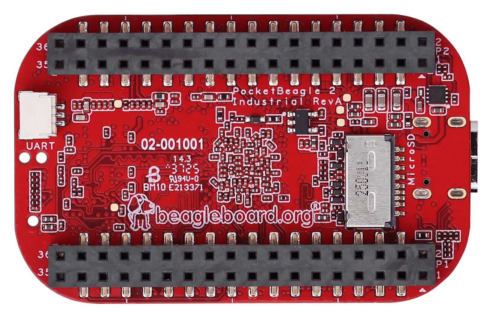

PocketBeagle 2 Industrial SBC Bottom Side

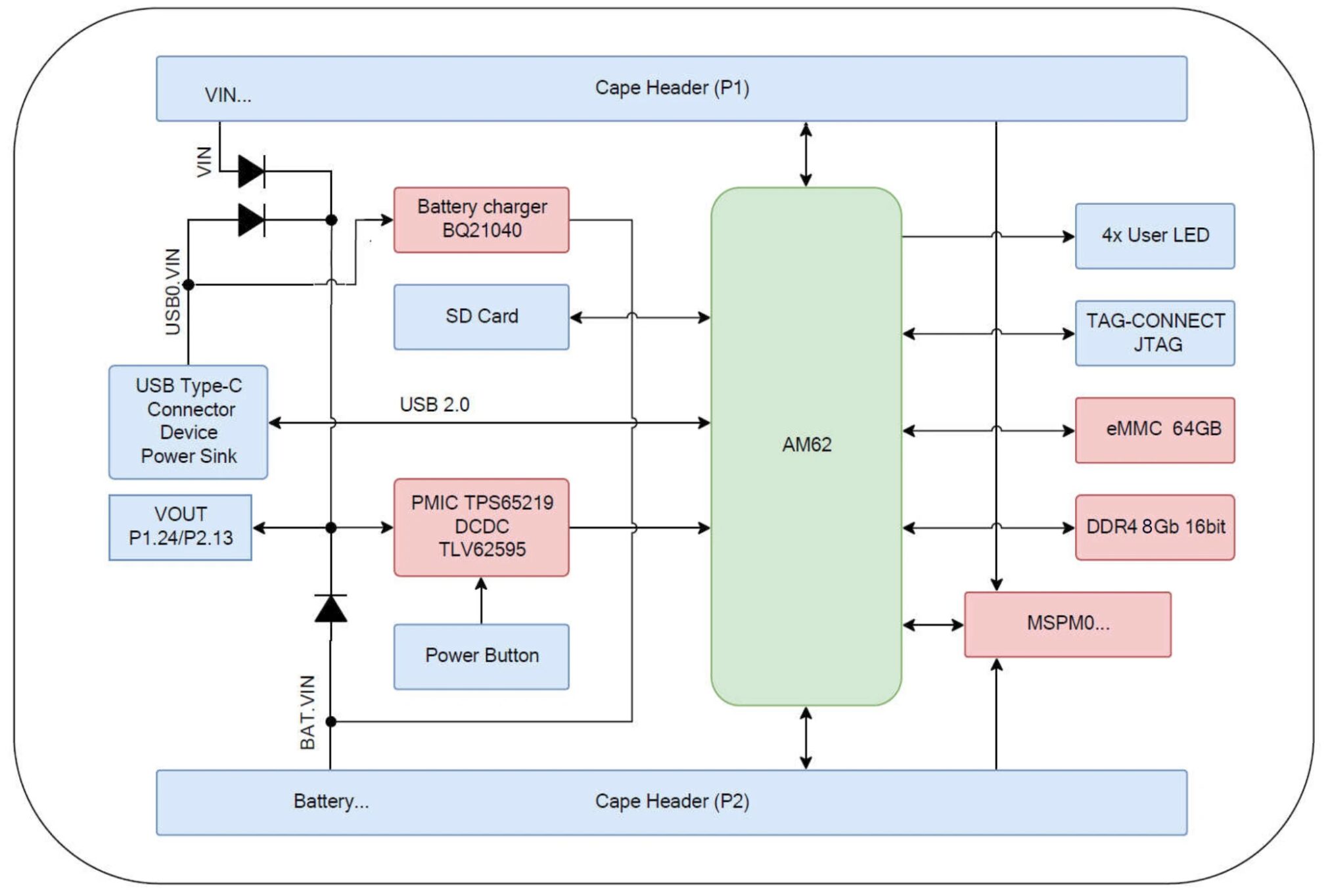

Block diagram of PocketBeagle 2 Industrial
