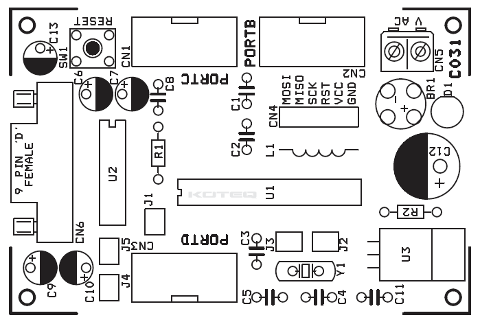

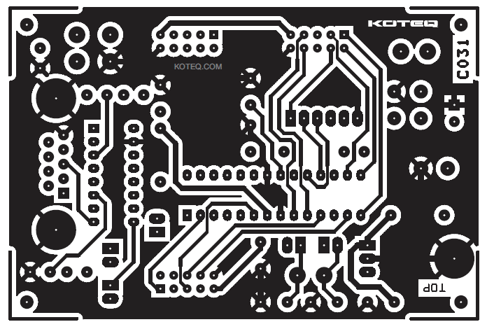

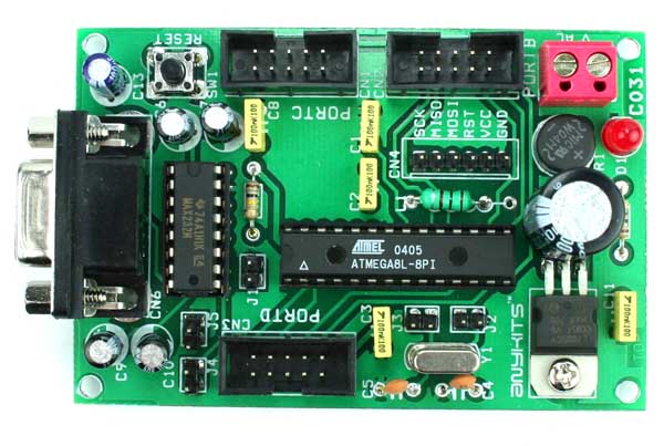

Atmega8 Development Board provides a very simple and cost effective platform for prototyping solution.  The compact design provides connection to all the pins of the microcontroller for the user.
  • Prototyping solution available for 28-pin ATmega series AVR microcontroller from ATMEL
  • All the three ports available to the user via standard 10 pin box header with supply of 5 VDC for interfacing circuits
  • Onboard reset switch for easy reset of the microcontroller
  • ISP (In circuit Serial Programming) connector available for chips with ISP support
  • 8 MHz crystal on board
  • UART level shifter circuit using MAX232 IC, on board for easy connection of the board to the RS232 devices
  • Jumper selectable connection available for connecting the UART level Shifter to the port pins
  • On board voltage regulator available for sourcing regulated 5V @ upto 1A voltage to the board and connecting circuit
  • Power-On LED indicator
  • AUX Power source of 5 VDC available on a PBT connector for sourcing DC supply to interfacing circuits
  • Four mounting holes of 3.2 mm each
  • PCB dimensions 60 mm x 89 mm

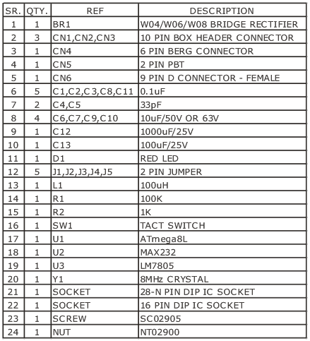

Parts List
ATMEGA8L BOM
