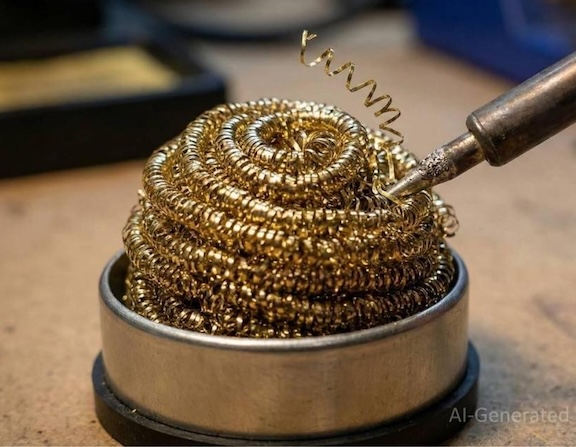

Brass or Stainless Steel Wool
This is the modern gold standard for cleaning, especially for lead-free solders.
  • Why it works: It is low-abrasive. The metal shavings are harder than the oxide/flux residue but softer than the iron plating of the tip.
  • Thermal advantage: Unlike a wet sponge, dipping the tip in brass wool does not cause a rapid temperature drop (thermal shock). This keeps the process consistent.

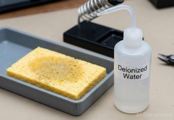

Sulfur-Free Cellulose Sponge
This traditional method is still useful for removing heavy flux buildup.
  • Requirement: It must be sulfur-free (sulfur corrodes iron) and used with deionized water (minerals in tap water cause scale).
  • Warning: The thermal shock of hitting a wet sponge can instantly drop the tip temperature by 50°C to 100°C.

Step 1: Heat up. Allow the iron to reach operating temperature (ideally 350°C).
Step 2: Wipe. Gently plunge the tip into the brass wool 2-3 times. Rotate the iron slightly to clean all sides. Note that you should not stab the wool violently; you want to scrub, not puncture.
Step 3: Inspect. The tip should look bright and silver.

Q3. Can I use tap water on my sponge?
It is highly discouraged. Tap water contains dissolved minerals like calcium, magnesium, and chlorides. When the water boils off on the 350°C tip, these minerals are left behind as a hard scale. This scale acts as a thermal insulator, which can cause the iron plating to corrode over time. Always use distilled or deionized water.
