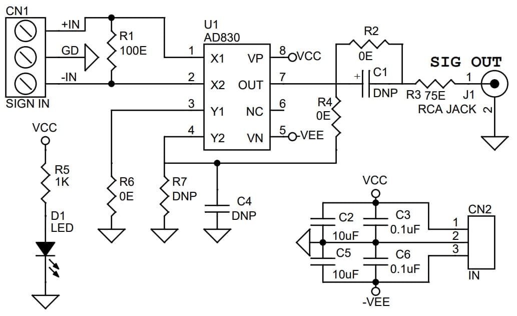

The circuit presented here is a high-frequency differential line receiver amplifier that has excellent common-mode rejection at its inputs. The project is an ideal solution for a receiver of a digital signal or video signals that are transmitted over long distances on twisted-pair cables like CAT5.
Miscellaneous by mixos
The circuit presented here is a high-frequency differential line receiver amplifier that has excellent common-mode rejection at its inputs. The project is an ideal solution for a receiver of a digital signal or video signals that are transmitted over long distances on twisted-pair cables like CAT5. Category 5 cables are very common in office settings and are extensively used for data transmission. These cables can also be used for the digital signal or analog transmission of signals such as video. These long cables pick up noise from the environment they pass through. This noise does not favor one conductor over another and therefore is a common-mode signal. A receiver that rejects the common-mode signal on the cable can greatly enhance the signal-to-noise ratio performance of the link. This project is tested with 100Hz to 1Mhz square wave signal, however, it can support higher frequency.

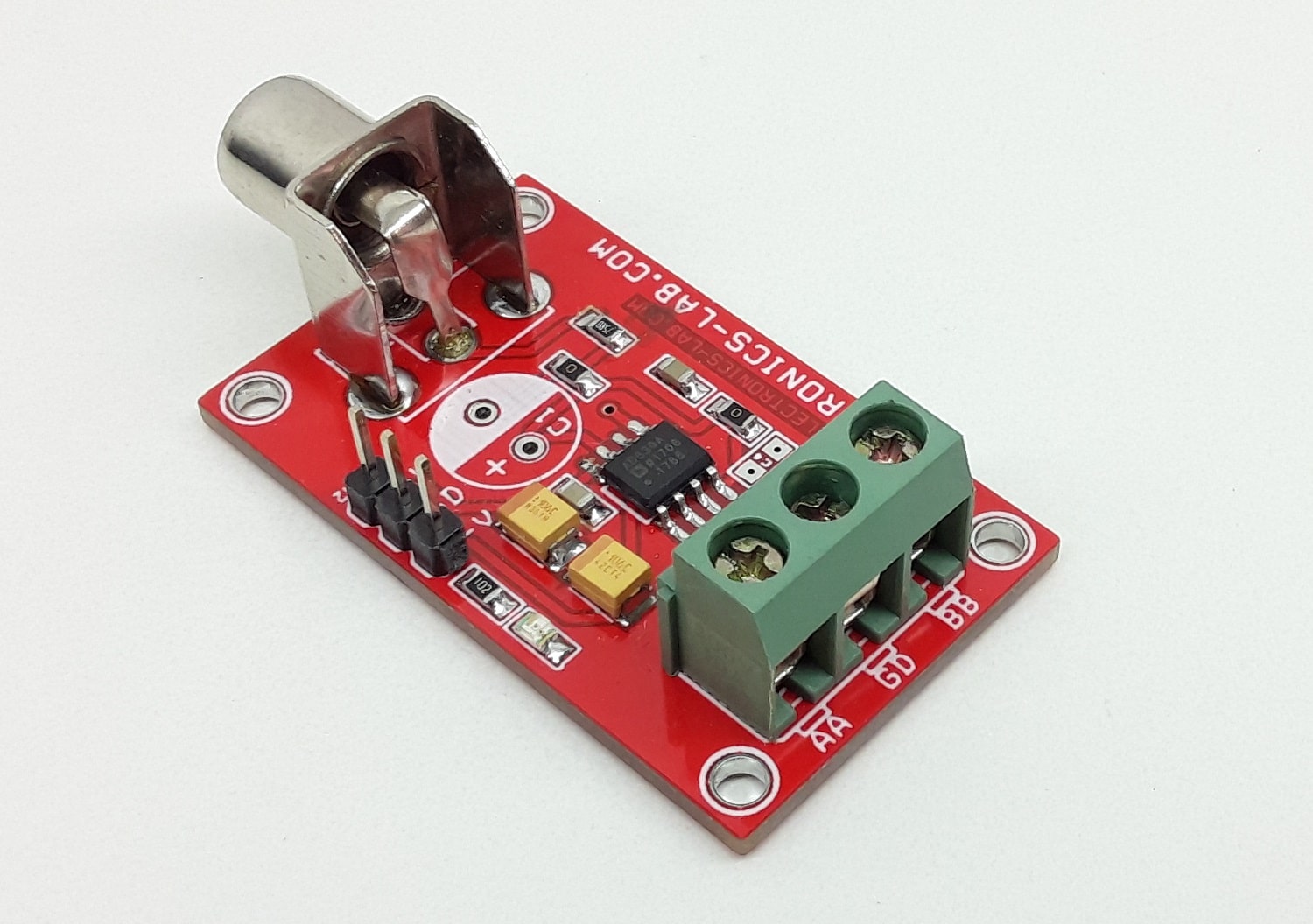

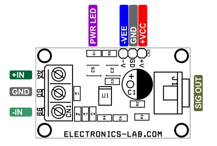

  • Operating Supply Dual +5V/-5V (+/-5V) @ 80mA
  • Input and Output Voltage Level 500mV to TTL
  • Compact Solution for Digital Signal Transmitter and Receiver over CAT-5 Twisted Cable
  • Screw Terminal for Twisted Pair CAT-5 Cable
  • RCA Connector for Digital Signal Outputs
  • Header Connector For +5V/-5V Supply input
  • Onboard Power LED
  • PCB Dimensions 42.39 x 25.24 mm
Schematic

NOQNTYREFDESCMANUFACTURERSUPPLIERSUPPLIER PART NO
11CN13 PIN SCREW TERMINAL PITCH 5.08MMPHOENIXDIGIKEY277-1248-ND
21CN23 PIN MALE HEADER PITCH 2.54MMWURTHDIGIKEY732-5316-ND
33C1,C4,R7DNP
42C2,C510uF/16V TANTLUM SIZE 1210 OR 1206KEMETDIGIKEY399-18017-1-ND
52C3,C60.1uF/50V SMD SIZE 0805MURATA/YAGEODIGIKEY
61D1LED RED SMD SIZE 0805LITE ONDIGIKEY160-1427-1-ND
71J1RCA JACKCUI DEVICEDIGIKEYCP-1405-ND
81R1100E 5% SMD SIZE 0805MURATA/YAGEODIGIKEY
93R2,R4,R60E SMD SIZE 0805MURATA/YAGEODIGIKEY
101R375E 1% SMD SIZE 0805MURATA/YAGEODIGIKEY
111R51K 5% SMD SIZE 0805MURATA/YAGEODIGIKEY
121U1AD830ANALOGDIGIKEYAD830ARZ-ND
