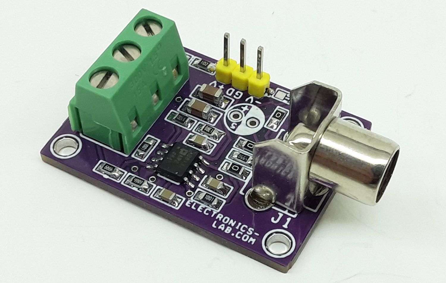

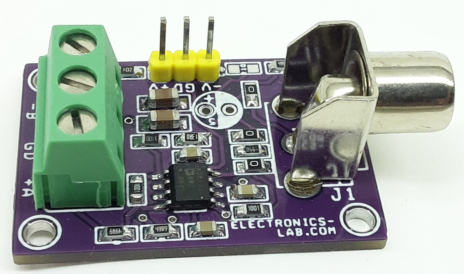

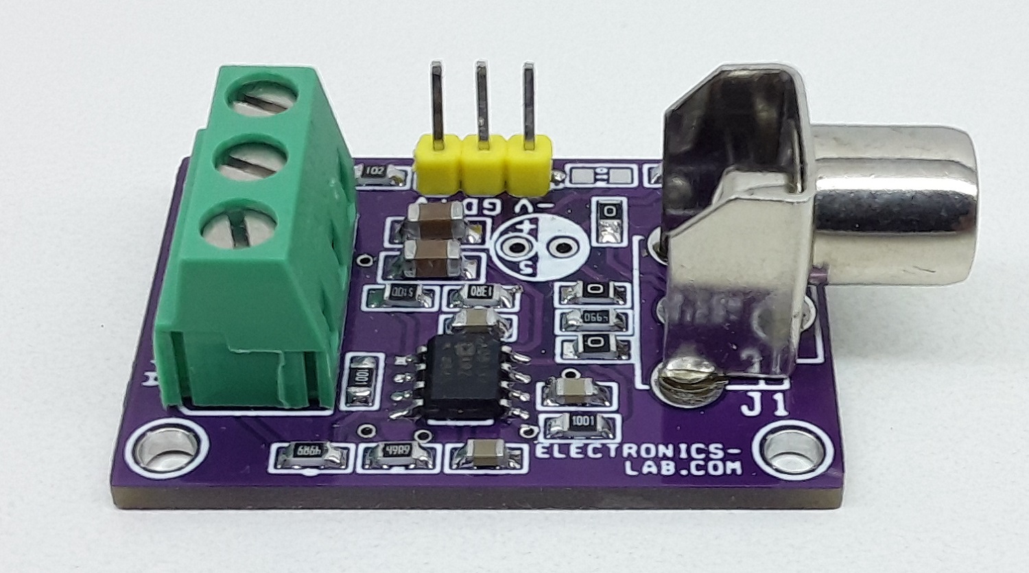

The project presented here is a differential driver for the transmission of high-speed signals over low-cost twisted pair or coaxial cables. The project was built using the AD8132 chip.
The project presented here is a differential driver for the transmission of high-speed signals over low-cost twisted pair or coaxial cables. The project was built using the AD8132 chip. It can be used to transmit either analog or digital video signals or another high-speed data transmission. The board is capable of driving either a Category 3 or Category 5 twisted pair or coaxial cable with minimal line attenuation. It is capable of operating with a 10 meters of Category 5 cable.

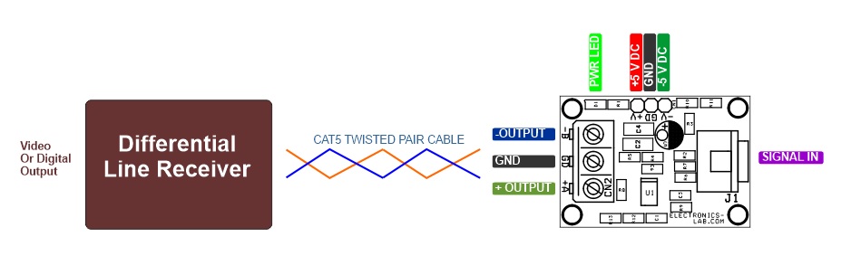

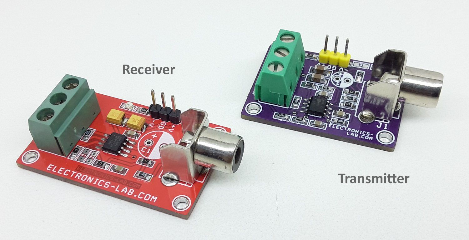

This board converts single-ended Video/Digital signals into a balanced output that can be paired with “Balanced Line Receiver for Digital Signal Over Twisted Pair CAT-5 Cable” as the receiver, published on our website.
This board has adjustable gain. You may also refer to a similar project “Single-ended Video/Digital input to differential output driver (High Speed Differential Driver)” with fixed gain published on our website.

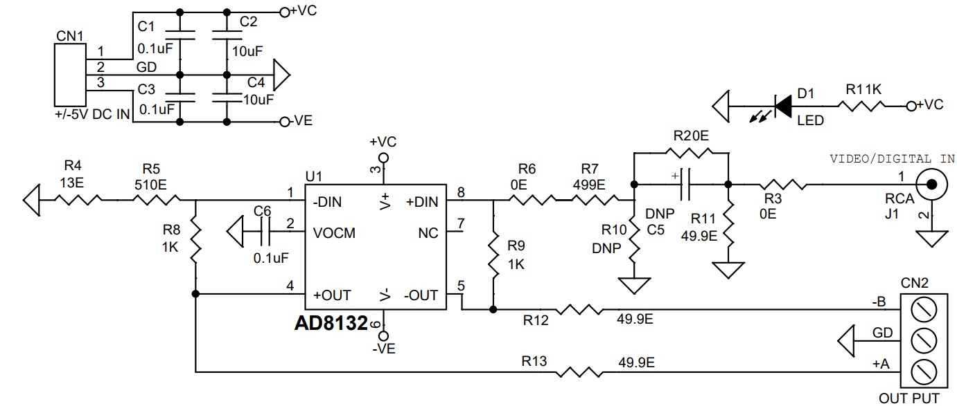

Gain Setting: Default gain is G= +2, refer to the datasheet of AD8132 to learn more about gain settings and gain change. Resistors R4, R5, R8, and R9 are used for gain adjustment.

- Resistor set gain (Resistor R8 and R9) Default Gain G=+2

Schematic

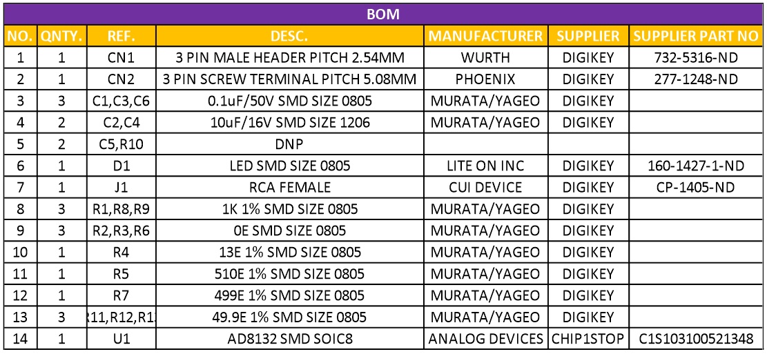

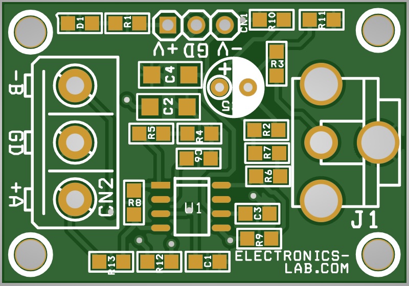

Parts List
| NO. | QNTY. | REF. | DESC. | MANUFACTURER | SUPPLIER | PART NO |
| 1 | 1 | CN1 | 3 PIN MALE HEADER PITCH 2.54MM | WURTH | DIGIKEY | 732-5316-ND |
| 2 | 1 | CN2 | 3 PIN SCREW TERMINAL PITCH 5.08MM | PHOENIX | DIGIKEY | 277-1248-ND |
| 3 | 3 | C1,C3,C6 | 0.1uF/50V SMD SIZE 0805 | MURATA/YAGEO | DIGIKEY | |
| 4 | 2 | C2,C4 | 10uF/16V SMD SIZE 1206 | MURATA/YAGEO | DIGIKEY | |
| 5 | 2 | C5,R10 | DNP | |||
| 6 | 1 | D1 | LED SMD SIZE 0805 | LITE ON INC | DIGIKEY | 160-1427-1-ND |
| 7 | 1 | J1 | RCA FEMALE | CUI DEVICE | DIGIKEY | CP-1405-ND |
| 8 | 3 | R1,R8,R9 | 1K 1% SMD SIZE 0805 | MURATA/YAGEO | DIGIKEY | |
| 9 | 3 | R2,R3,R6 | 0E SMD SIZE 0805 | MURATA/YAGEO | DIGIKEY | |
| 10 | 1 | R4 | 13E 1% SMD SIZE 0805 | MURATA/YAGEO | DIGIKEY | |
| 11 | 1 | R5 | 510E 1% SMD SIZE 0805 | MURATA/YAGEO | DIGIKEY | |
| 12 | 1 | R7 | 499E 1% SMD SIZE 0805 | MURATA/YAGEO | DIGIKEY | |
| 13 | 3 | R11,R12,R13 | 49.9E 1% SMD SIZE 0805 | MURATA/YAGEO | DIGIKEY | |
| 14 | 1 | U1 | AD8132 SMD SOIC8 | ANALOG DEVICES | CHIP1STOP | C1S103100521348 |

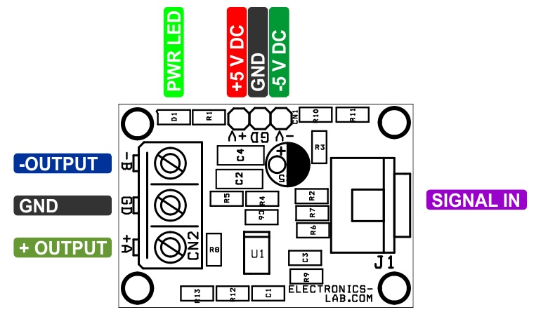

Connections
Pairing Connection
