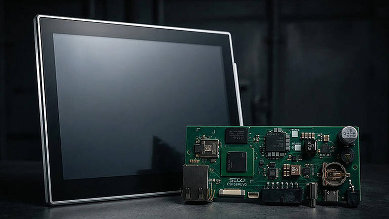

SECO Compact Vision 5 industrial HMI alongside the SBC-Dragonwing-IQ-2390

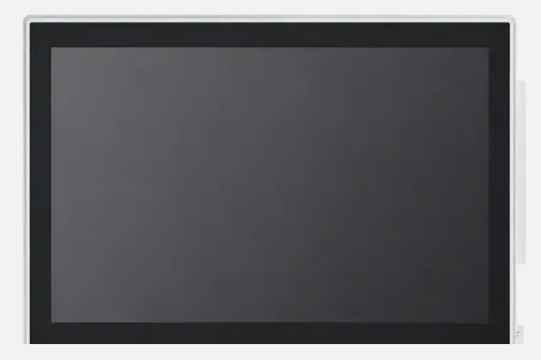

Compact Vision 5 Dragonwing IQ-2390
The Compact Vision 5 combines a 5-inch touchscreen and the Dragonwing IQ-2390 processor in a single panel-mounted unit, so there is no need for a separate display or computing board. This makes it suitable for industrial applications that need a built-in display and local processing.
SECO Compact Vision 5 Dragonwing IQ-2390 industrial HMI
The HMI device measures 145.5 × 102.4 × 33.4 mm and comes with an IP65-rated front panel for protection against dust and water jets. SECO also plans to introduce 4.3-inch and 7-inch versions in the future. The device can be used in operator panels, machine controllers, vending machines, and other connected industrial equipment.

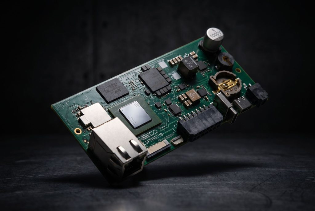

The SBC-Dragonwing-IQ-2390 uses the same processor and memory options as the Compact Vision 5 but comes in a smaller 47 × 114 mm board without a built-in display. This makes it suitable for custom controllers, industrial gateways, and other embedded systems where developers need to choose their own display, enclosure, and peripherals.
SECO SBC-Dragonwing-IQ-2390 single-board computer
The board also includes RS232, RS485, CAN, Gigabit Ethernet, USB-C, Wi-Fi, and Bluetooth connectivity. It also has an expansion connector for adding cameras, audio devices, Ethernet, USB, and I2C/I3C peripherals. This gives you options for connecting additional hardware based on your project requirements.

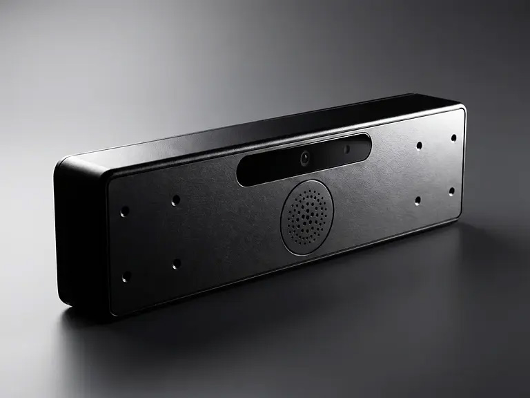

SECO AI Audio Dongle with integrated camera, microphone array, and speaker
The company also offers an optional USB-connected AI Audio Dongle for both platforms. It comes with a 3+3 microphone array with beamforming to reduce background noise during voice interactions, a 3W mono speaker, and a 2592 × 1944 camera capable of recording at 30 fps. The camera also supports autofocus and includes an LED for illumination. The dongle is designed for voice-controlled applications in factories and other noisy environments.
