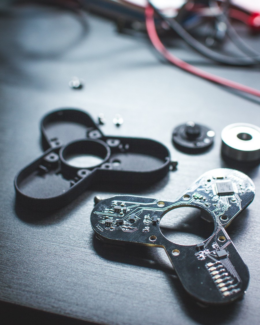

At this project on Hackaday, Sean Hodgins created a fidget-shape PCB that fits into the spinner. It consists of an 8-LED vector, a 32-bit microcontroller, an 8-bit shift register, and other electronics parts. It is powered by three 3.6 LiPo cell batteries and can be connected with PC through a micro USB connector.

The total cost is about $20 for all parts, and here is the bill of materials. Also the design of the fidget is available for 3D printing for both the body and the caps. In addition, the microcontroller can be programmed simply with Arduino IDE.
Since this project is fully open source, all resources and files are available for download. The github repository includes the CAD files, firmware code and libraries, PCB design, and some pictures.
