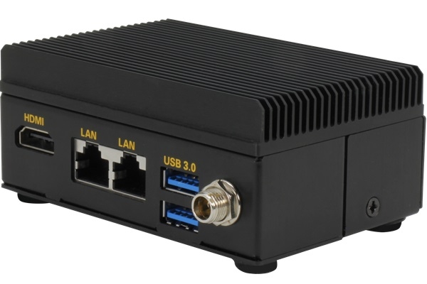

AAEON de next-TGU8-EZBOX Mini PC is a Tiger Lake-powered mini PC that claims to be the world’s smallest Edge PC. The PC can be configured with up to an Intel Core i7-1185G7E Tiger Lake SoC 16GB LPDDR4, and M.2 NVMe storage and comes in a fanless version ( 95.5 x 69.5 x 42.5mm) and a version with an active cooler(95.5 x 69.5 x 42.5mm) It also features a GbE Ethernet and 2.5GbE ports, an HDMI port USB 3.0.
It also features a GbE Ethernet and 2.5GbE ports, an HDMI port USB 3.0. ports and many other ports making it suitable for various applications like edge computing, digital signage, and industrial use.
Other than that, the company provides some additional M.2 modules like PER-T642 for AI acceleration and Wi-Fi, the PER-T643 with AI acceleration and 4G LTE, and the PER-R41P for PCIe expansion and more.
