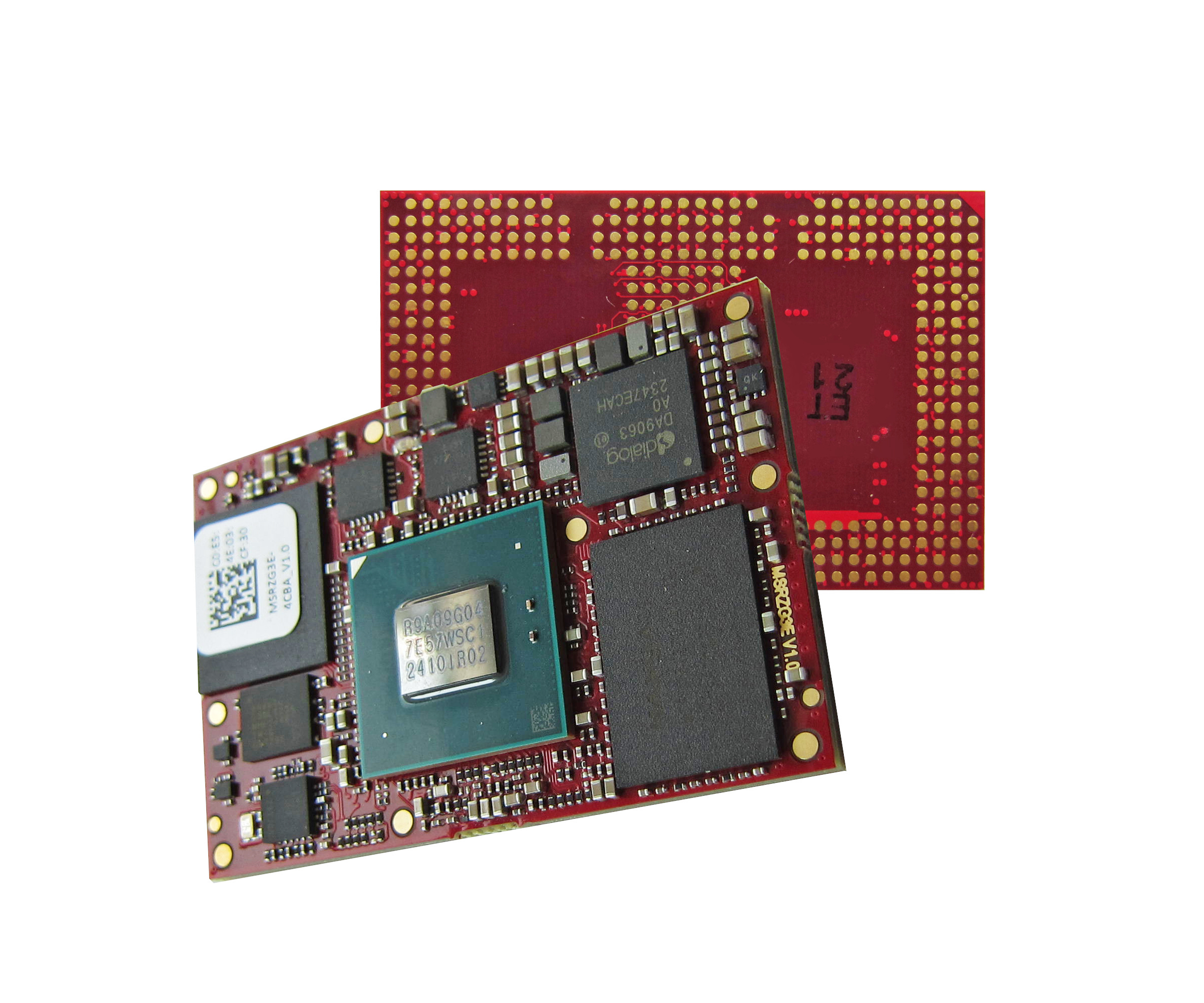

ARIES Embedded, specialist in embedded services and products, introduces the MSRZG3E, a new OSM-compliant system-in-package (SiP) built on the Renesas RZ/G3E Microprocessor (MPU). Powered by the RZ/G3E, which integrates a quad-core Arm® Cortex®-A55, a Cortex-M33 real-time core, and the Ethos™-U55 neural processing unit (NPU) in a single chip solution, the MSRZG3E delivers a powerful platform for advanced multimedia and AI workloads.
“With the RZ/G3E at its core, this SiP merges high-efficiency compute performance with a rich set of industrial interfaces optimized for demanding HMI applications,” stated Andreas Widder,
Managing Director of ARIES Embedded. Packaged in the compact OSM (Open Standard Modules by SGET e. V.) size M form factor (30×45 mm²) with 476 contact pads, the module exposes nearly the entire CPU features, enabling seamless integration into industrial, medical, and edge computing systems.

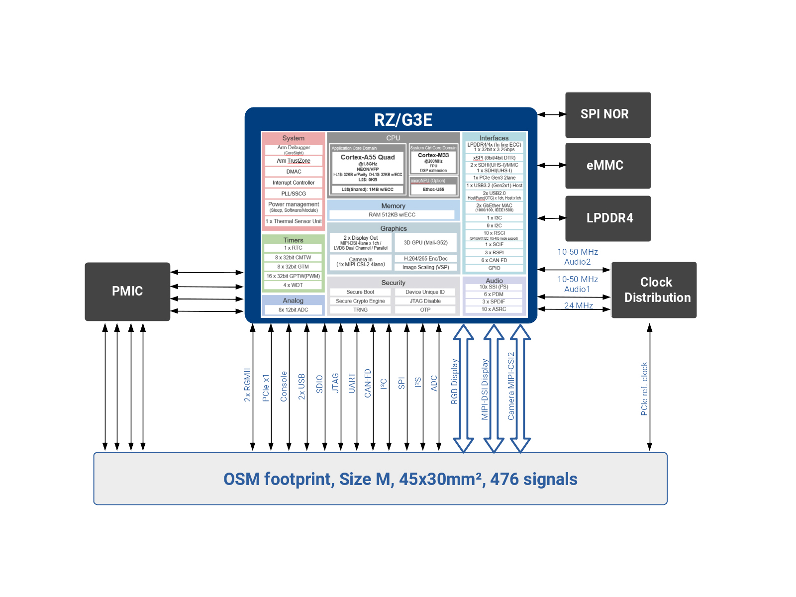

The MSRZG3E module from ARIES Embedded is engineered to power edge computing systems with robust multimedia capabilities and high-performance processing. The RZ/G3E MPU integrates a quad Arm Cortex-A55 main CPU running up to 1.8 GHz for Linux-based tasks, a Cortex-M33 sub-CPU at up to 200 MHz for NPU, and an Arm Ethos-U55 NPU delivering up to 512 GOPS (256 MACs) for AI acceleration. High-speed connectivity includes a PCIe Gen3 (2-lane) interface, USB 3.2 Gen2x1 host, and dual Gigabit Ethernet ports. Additional versatile interfaces—USB 2.0 Host/OTG, CAN FD, UART, I2C, SPI, and ADC—offer flexible integration for a wide range of industrial and embedded use cases.
Block diagram of the OSM-compliant MSRZG3E SiP by ARIES Embedded based on Renesas RZ/G3E MPU
Rich Multimedia Support for Advanced HMI Uses
To meet the demands of high-end human-machine interfaces, the MSRZG3E system-in-package integrates robust multimedia functionality. It supports dual display outputs via RGB and MIPI-DSI, along with MIPI-CSI camera inputs using 1, 2, or 4 data lanes. The module also features an integrated video codec engine for H.264/H.265 encoding and decoding, a frame data processor, video signal processor, image scaler, rotation engine, color space converter, and color keying for dynamic rendering and display control.

The MSRZG3E is available with LPDDR4 RAM configurations from 512 MB up to 8 GB and eMMC NAND Flash storage ranging from 4 GB to 64 GB. Designed for durability, it supports both commercial (-25 °C to +70 °C) and industrial-grade (-40 °C to +85 °C) operating temperatures, ensuring reliable performance across a wide range of embedded environments.
