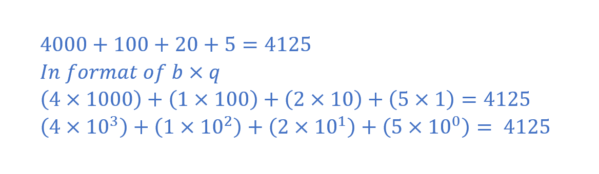

As described earlier, the value of each digit increases by ten (10) times, left from the decimal point, in decimal numbers i.e. 100, 101, 102, 103, 104 etc. Similarly, the value of each digit decreases by ten (10) times as we move to the right from the decimal point to account for fraction numbers e.g. 10-1, 10-2, 10-3, 10-4, etc. This is because the decimal number has base-10 (modulo-10) with the position of each digit indicating the weight or magnitude of that digit i.e. q = 10. This means fifty (50), for example, can be written as 5 X 101 and five hundred (500) as 5 X102. As described above, the decimal number is equal to the sum of its digits multiplied by their respective weights. In the following text, a decimal number (N = 4125) is shown in decimal format with each digit and its weight.
In the decimal number or any other number system, the right-most digit is the least significant digit (LSD) and the left-most digit is the most significant digit (MSD). Following this, for the above example, the five (5) is the least significant digit (LSD) which has the lowest weight i.e. one (1). Whilst, the four (4) is the most significant digit (MSD) having the highest weight of one thousand (1000).

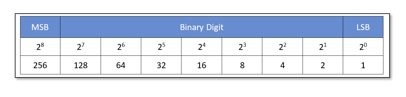

Moreover, the binary digit can hold either 0 or 1 i.e. two (bi) values. The binary number may consist of more than one binary digit and the weight or value of each binary digit increases by two (2) times from its preceding right binary digit. Therefore, following the decimal numbering system, the right-most binary digit (bit) that holds the lowest weight is called the least significant bit (LSB). Likewise, the left-most binary digit (bit) holds the highest weight and is termed the most significant bit (MSB). As the bit can have either zero (0) or one (1), the weights of bits having zero (0) values are nullified and a binary numbering system can be represented by the weights of digits having one (1) value. In the following table, the weights of a binary number’s digits and their equivalent decimal values are shown.
The weight of each binary digit (bit) increases (doubles) with each digit step as we move right to left. The least significant digit (LSD) has the lowest weight of one (1) and the most significant digit (MSD) has the highest weight of two-hundred and fifty-six (256).

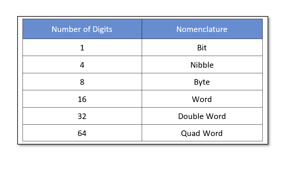

Like decimal numbers, two binary numbers can also be added and subtracted together. The resulting number’s size is dependent on the sizes of binary numbers being added or subtracted. The size of the binary number is given by the number of Binary Digits (Bits) and the number of bits is classified into different sizes and names. In the following tables, the number of bits is classified into larger groups and their respective name are also given.

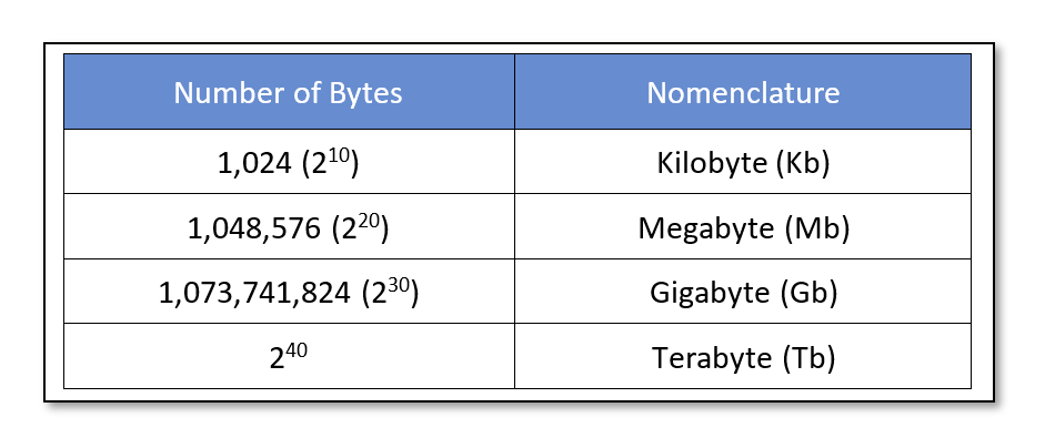

The memory size of digital systems and computers is given in bytes which groups eight (8) bits together. Like other measurement units, prefixes are added to represent larger values. The following table lists the most frequently used prefixes to represent binary numbers.
