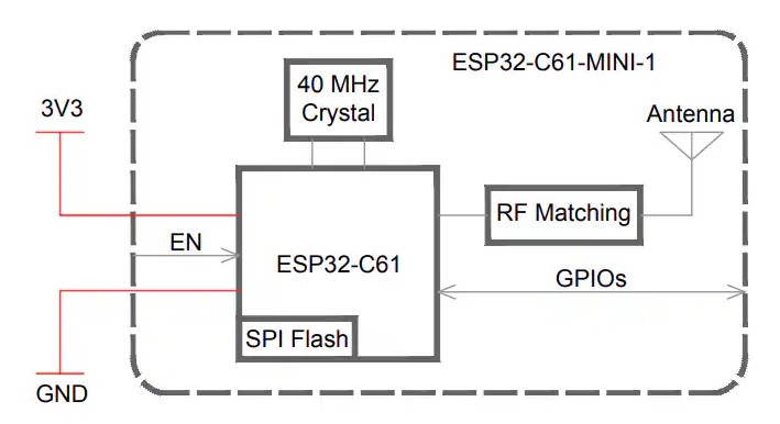

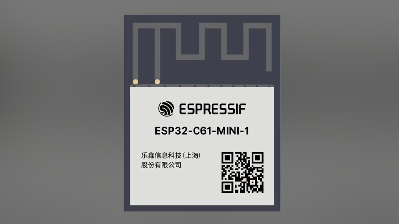

Mouser Electronics, Inc., the sector’s renowned New Product Introduction (NPI) distributing firm with the most extensive inventory of semiconductors and standardized electronic components, now stocks the ESP32-C61-MINI-1 and -1U ESP32-C61-based Multiprotocol Modules supporting 2.4 GHz Wi-Fi 6 (802.11ax), Bluetooth 5 Low Energy from Espressif Systems and IEEE 802.15.4 connectivity including Matter support. Espressif ESP32-C61-MINI-1 is a significant as well as high-performance general-purpose module with rich peripherals. The module is based on the ESP32-C61 system-on-chip (SoC) which is a 32-bit RISC-V single-core microcontroller. The ESP32-C61-MINI-1 comes with an on-board PCB antenna and an SPI flash of up to 4MB. Wi-Fi and Bluetooth can share one antenna by an internal co-exist design.

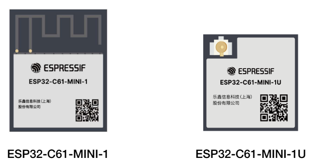

    • Variant: ESP32-C61-MINI-1
    • Antenna Configuration: On-board PCB antenna
    • Dimensions: 13.2 × 16.6 × 2.4 mm
    • Variant: ESP32-C61-MINI-1U
    • Antenna Configuration: External antenna connector
    • Variant: 13.2 × 16.6 × 2.4 mm

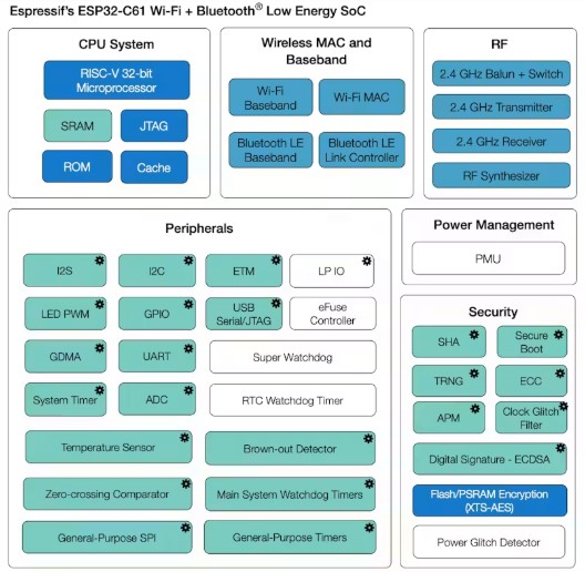

Espressif ESP32-C61 Block Diagram

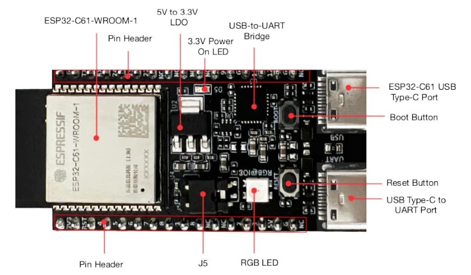

ESP32-C61-DevKitC-1 is an elementary-level development board built around the ESP32-C61-WROOM-1. This board has full Wi-Fi and Bluetooth Low Energy capability. The Espressif Systems ESP32-C611-DevKitC-1 Development Kit contains the ESP32-C61-WROOM-1 universal-purpose module with up to 8MB SPI flash and 2MB PSRAM. The ESP32-C61-DevKitC-1 is an inexpensive introductory development board that features comprehensive Wi-Fi and BLUETOOTH Low Energy support. The I/O pins of the Espressif Systems ESP32-C61-DevKitC-1 is broken out to the pin headers on either side for interfacing. Users can interconnect peripheral components with jumper wires or mount the ESP32-C61-DevKitC-1 on a breadboard.
Espressif Systems ESP32-C61-DevKitC-1 Development Kit

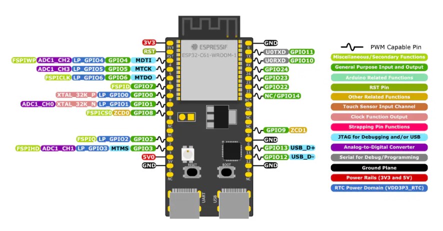

Espressif Systems ESP32-C61-WROOM-1-N8R2 Module Pinout
To begin, users can use the ESP32-C61-MINI-1/1U module, but also the ESP32-C61-DevKitC-1-N8R2 development board. It sells for $9 on AliExpress or $12 on Amazon.
