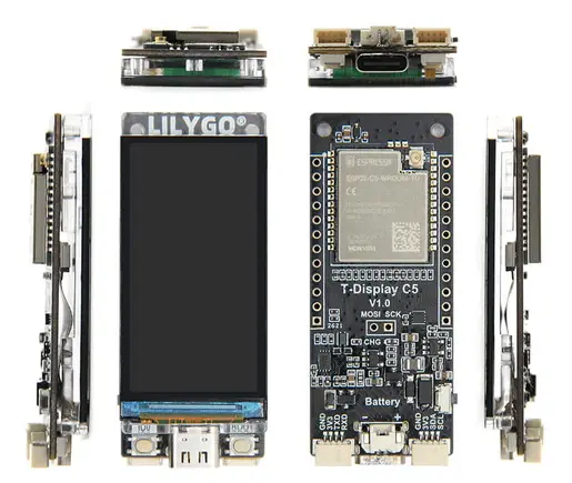

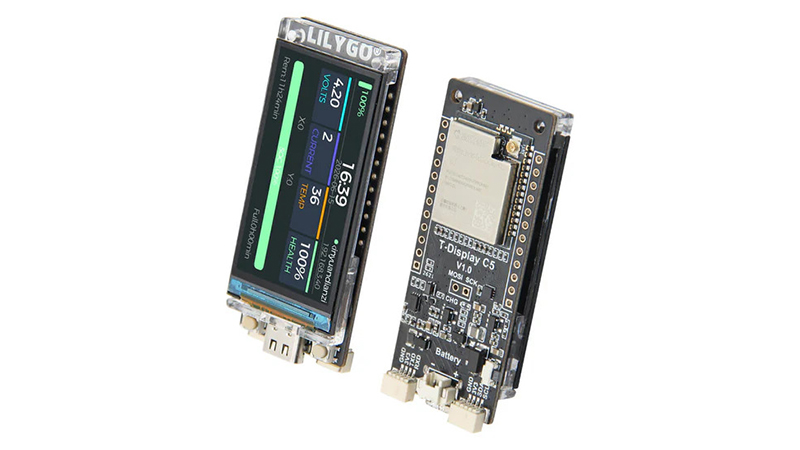

LILYGO has introduced the T-Display C5, a compact ESP32-C5 development board built for IoT, smart display, and portable embedded applications. The board combines Espressif’s ESP32-C5 RISC-V microcontroller with a 1.9-inch IPS touchscreen, making it suitable for user interfaces, wireless monitoring devices, handheld controllers, and connected sensor projects.
The board supports dual-band Wi-Fi 6 connectivity across both 2.4 GHz and 5 GHz bands, along with Bluetooth 5 LE. It also integrates 16 MB Flash, 8 MB PSRAM, and an AXP2602 power management IC for battery-powered designs. With a USB Type-C interface, capacitive touch support, and compatibility with popular development frameworks, the board provides a complete platform for developers working on modern wireless applications.

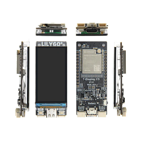

LILYGO-T-DISPLAY-C5 all side view

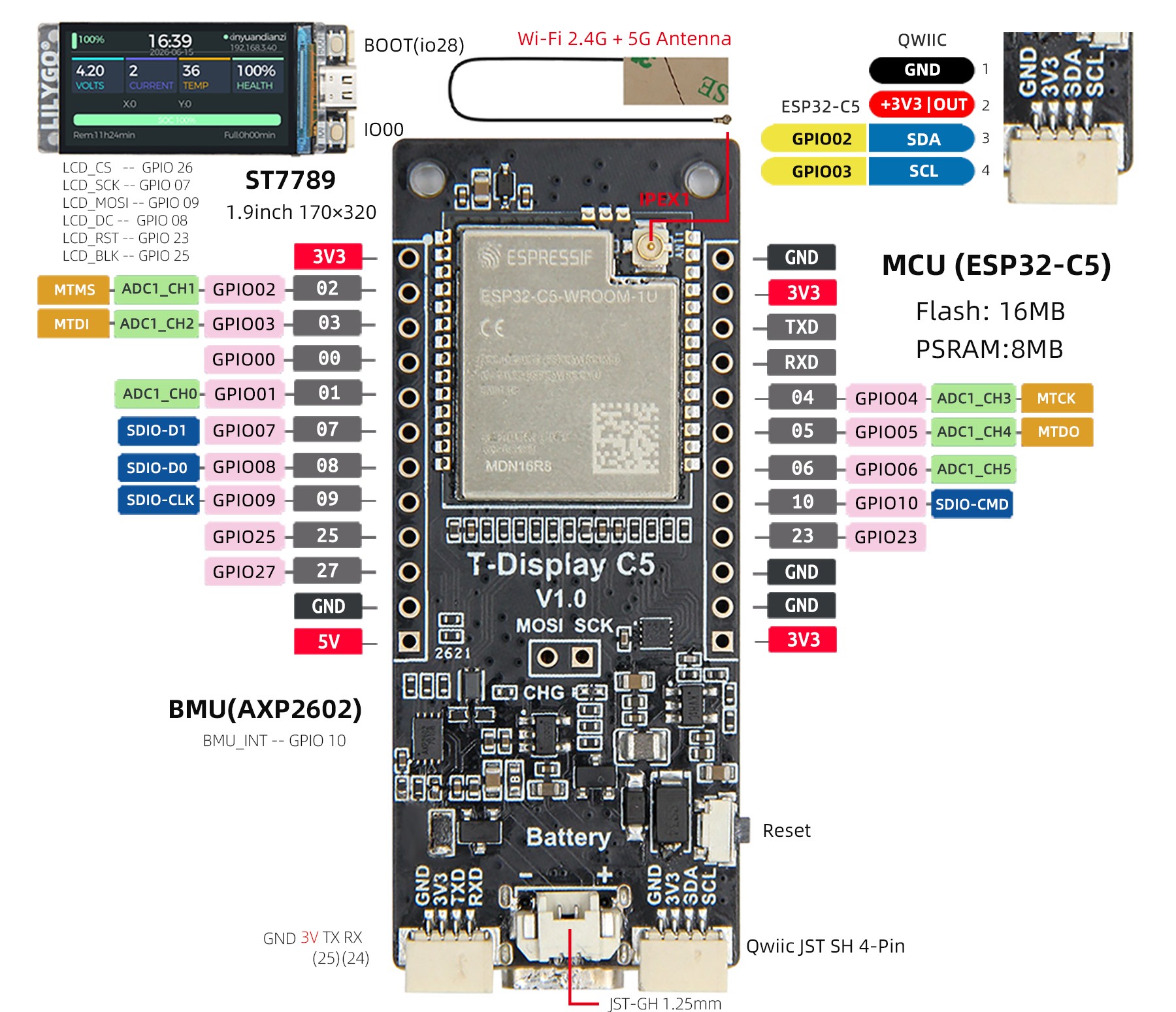

T-Display C5 features:
  • SoC: ESP32-C5 RISC-V 32-bit processor running at up to 240 MHz
  • Low-power core: Integrated ULP RISC-V core for independent sensor operation during deep sleep
  • Wireless connectivity: Dual-band Wi-Fi 6 (802.11ax/b/g/n) supporting both 2.4 GHz and 5 GHz bands
  • Bluetooth: Bluetooth 5 Low Energy (BLE 5)
  • Memory: 16 MB Quad QIO Flash and 8 MB Quad QIO PSRAM
  • Display: 1.9-inch ST7789 IPS LCD
  • Resolution: 170 × 320 pixels with RGB565 color format
  • Display interface: 4-wire SPI operating at 3.3 V
  • Touch controller: CST816S capacitive touch controller connected through I2C
  • Power management: AXP2602 battery management IC for low-power operation
  • USB: USB Type-C with USB-Serial-JTAG support
  • Power input: 5 V at 500 mA
  • Dimensions: 62 × 26 × 10 mm
T-Display C5 pinout and specifications
