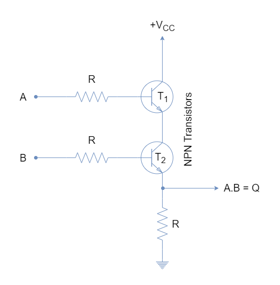

Resistor-Transistor AND Gate
In the following figure, a basic two-input AND gate constructed using Resistor-Transistor Logic (RTL) are shown. For each input, a Transistor (T) is used and the output is driven across the Resistor (R). In this type of AND logic circuit, the transistors are operated in saturated “ON” & “OFF” states.
RTL AND Gate
Figure 1: The Resistor-Transistor Logic AND Gate
When both inputs “A” and “B” are “HIGH” then both transistors are in saturated “ON” states and a state “HIGH” appears at the output (Q). Turning any of the inputs to logic “LOW” will drive the relative transistor to the “OFF” state and thus incomplete path across VCC & Ground yields state “LOW” at the output (Q).

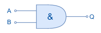

Logic AND Gate Symbol & Truth Tables
The representation of a AND logic by a symbol is shown in the following figure. Its symbol denotes the multiplication/ AND logic operation.
Log AND Gate Symbol
Figure 2: Logic AND Gate Symbol

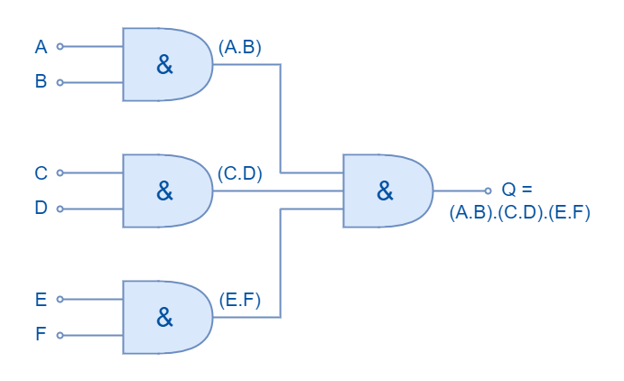

The Boolean expression can be extended to include multiple inputs to obtain AND logic operation. However, commercially available AND logic circuits have up to four inputs but the number of inputs can be further extended by cascading the AND logic circuits. In the following figure, three two-inputs gates and one three-input AND logic gate are cascaded to construct a six-inputs (2 x 3 = 6) AND logic circuit.
Figure 3: A 6-input AND logic constructed by cascading multiple AND gates
The Boolean expression for this cascaded circuit can be written as:
Q = (A.B).(C.D).(E.F)

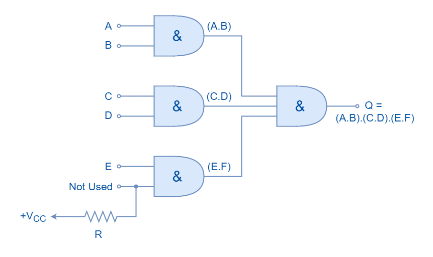

Odd Number of Inputs
The AND logic circuit having an odd number of inputs can be constructed by driving the unused input to logic “HIGH”. This will ensure that another input(s) of the AND logic gate is truly reflected at the output. It is explained in the following diagram where unused input is pulled high using a pull-up resistor.
AND logic with odd number of inputs
Figure 4: The AND logic having an odd number of inputs
