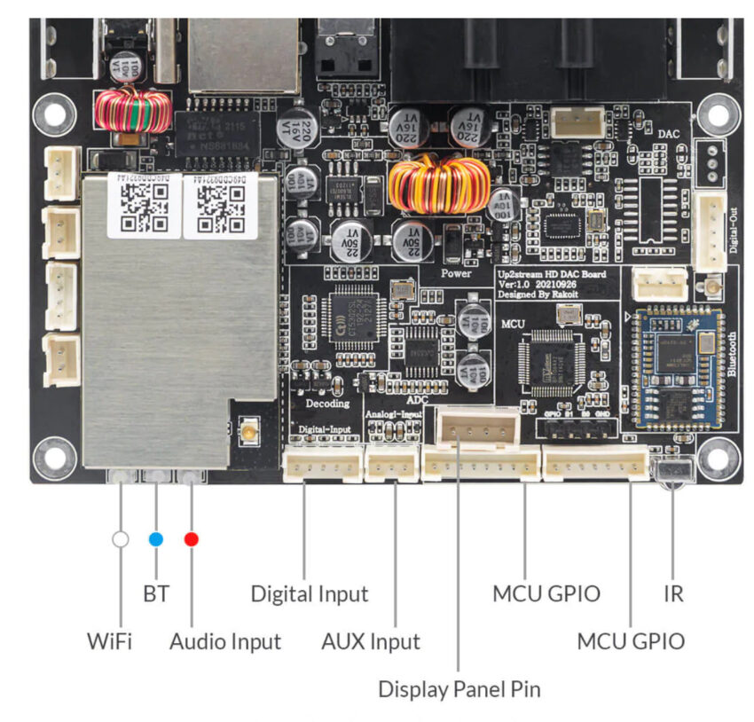

With support for Apple Airplay 2, the Up2Stream HD DAC allows music streaming from iOS gadgets to multiple Apple devices simultaneously. It comes with a high-performance ESS 9038Q2M, a hardware audio codec from ESS Technology to offer 1:1 high-fidelity lossless 192khz/24bits high-resolution audio output capable of delivering high-quality sound with connected sound systems. It also features dual-band WiFi and Aptx HD Bluetooth 5.0 for wireless functions needed in modern audio systems such as wireless speakers and streamers. It has a small form factor that can fit into a traditional sound system to turn it into a wireless streamer and connect it with any other audio system with Arylic audio board, thereby supporting multiroom installations.
The Up2Stream HD DAC is an enhanced Up2Stream as it features a display panel (promised to come in the future) header for visuals, 2 MCU GPIO headers that can accept a button board, and a digital input header. It also has 1 Ethernet port for LAN, 1 Line Out, an Optical Out, and 1 AUX input. Other features of the device include an IR receiver, a power button, and a type-c USB for 5V/2A input.

Audio:
  • Codec: ESS 9038Q2M
  • Stereo RCA  output
  • 1x Optical output (S/PDIF),
  • 1x coaxial output (S/PDIF)
  • Digital input header
  • AUX input header
Audio formats: WAV, FLAC, ALAC, MP3, AAC/AAC+, APE
Streaming Compatibility: AirPlay 2, Spotify Connect, Tidal connect,  Amazon Music, Internet Radio, iHeartRadio, Napster, 4Stream app, Qobuz HD, Deezer
Connectivity:
  • Ethernet port
  • 802.11 b/g/WiFi 4 (Dual-band)
  • Aptx HD Bluetooth 5.0
Expansion headers:
  • 1x Digital input pin header
  • 1x Display Panel pin headers
  • 2x MCU GPIO pin header
Miscellaneous:
  • 3x LEDs indicators (for WiFi, Bluetooth, audio input)
  • IR Receiver for remote control
Power:
  • 1x USB type-C port (at 5V/2A)
  • 1x multifunctional power button (for ON/OFF, WiFi/BT Reset, Mode Select, Factory Reset)
Dimension: 110 x 74mm
