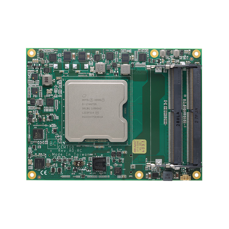

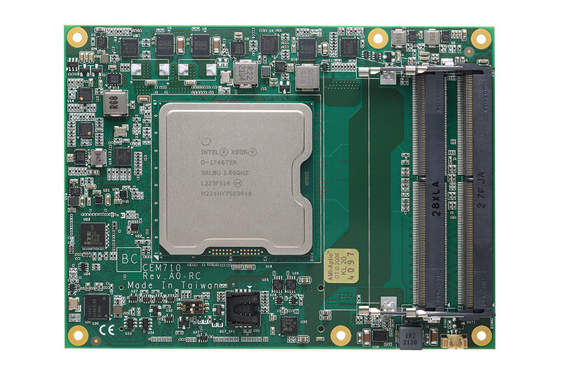

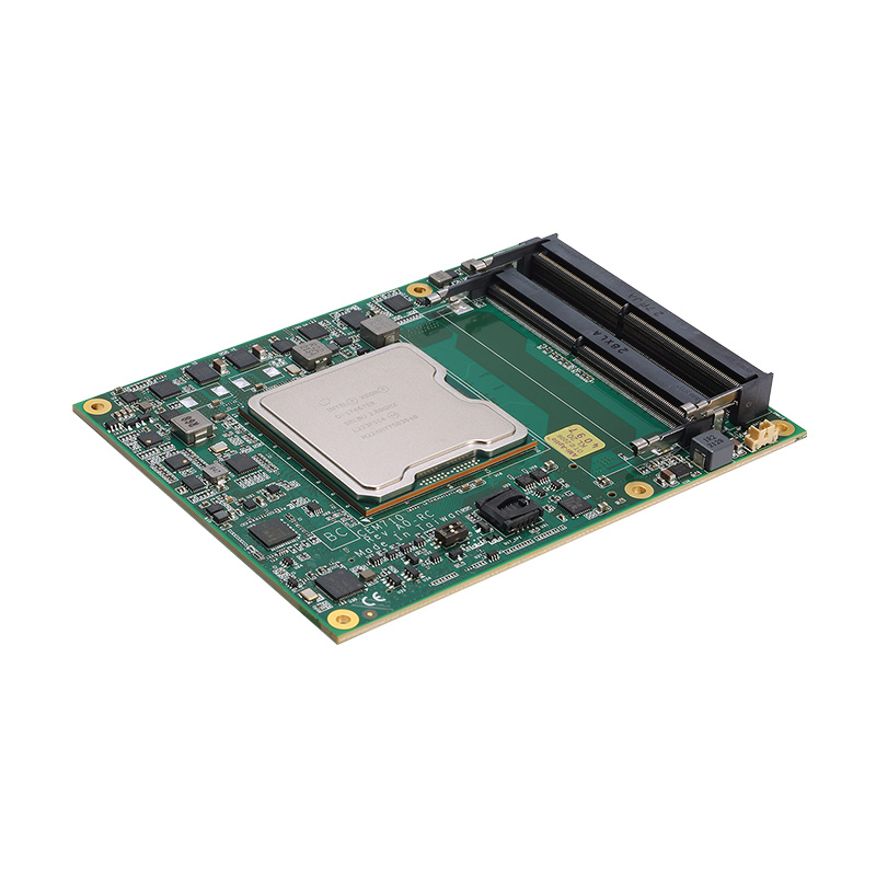

Axiomtek CEM710 COM Express Module comes with Intel Xeon D-1700 10 Core CPU, 64GB ECC, and 100Gbps Ethernet support
The Axiomtek CEM710 COM Express Module is powered by Intel Xeon D-1700 Series processors, designed for edge computing, industrial automation, and data-intensive applications. The module offers up to 10 cores, up to 100Gbps Ethernet support, and 64GB of DDR4 ECC memory.
Axiomtek CEM710 COM Express module
The Axiomtek CEM710 COM Express Module is powered by Intel Xeon D-1700 Series processors, designed for edge computing, industrial automation, and data-intensive applications. The module offers up to 10 cores, up to 100Gbps Ethernet support, and 64GB of DDR4 ECC memory. Key features of this module include multiple PCIe Gen3 slots, SATA storage, USB 3.0 and 2.0 ports, GPIO, serial interfaces, TPM 2.0 security, and support for multiple operating systems, including Linux, Windows, and real-time OSes.
The module is so designed that it can withstand harsh environments with extended temperature ranges (-40°C to 85°C), high humidity tolerance, and compliance with industrial standards like CE certification. The module also integrates advanced networking capabilities such as 10GbE and 100Gbps Ethernet, making it ideal for applications in software-defined networking, industrial automation, real-time data processing, and edge AI computing.

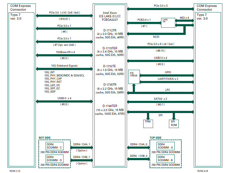

Axiomtek CEM710 COM Express Module Specifications
  • CPU Options:
    • Intel® Xeon® D-1712TR (4 x 2.0 GHz, 10MB cache, 50G Ethernet, 40W)
    • Intel® Xeon® D-1715TER (4 x 2.4 GHz, 10MB cache, 50G Ethernet, 50W)
    • Intel® Xeon® D-1732TE (8 x 1.9 GHz, 15MB cache, 50G Ethernet, 52W)
    • Intel® Xeon® D-1735TR (8 x 2.2 GHz, 15MB cache, 50G Ethernet, 59W)
    • Intel® Xeon® D-1746TER (10 x 2.0 GHz, 15MB cache, 100G Ethernet, 67W)
  • Chipset: SoC integrated
  • System Memory:
    • 2 x DDR4-2400 SO-DIMM slots
    • Up to 64GB with ECC support
  • BIOS: AMI
  • Serial Ports: 2 x TX/RX
  • USB Ports:
    • 4 x USB 3.0
    • 4 x USB 2.0
  • Ethernet:
    • 1 x 10/100/1000/2500 Mbps (Intel® I226, via COMe PCIe port 7)
    • 4 x 10GBASE-KR (Intel® 10G external PHY)
  • GPIO: 4-CH in & 4-CH out
  • Storage: 2 x SATA Gen3
  • Expansion:
    • 1 x PCIe x16 Gen3 (PEG)
    • 1 x PCIe x8 Gen3
    • 6 x PCIe x1 Gen3
  • Others:
    • TPM 2.0
    • 1 x I2C
    • 1 x LPC
    • 1 x SPI
  • Power Input:
    • ATX: +12V, +5VSB
    • AT: +12V
  • Watchdog Timer: 65536 levels, 0 to 65535 seconds
  • Hardware Monitoring: Yes
  • Operating Temperature:
    • Standard: 0°C to 60°C (32°F to 140°F)
    • Extended: -40°C to 85°C (-40°F to 185°F) with thermal solution
  • Relative Humidity: 10% to 95%, non-condensing
  • Vibration: 3.5 Grms
  • Dimensions: 125 x 95 mm
  • Board Thickness: 2.0 mm
  • Certifications: CE
