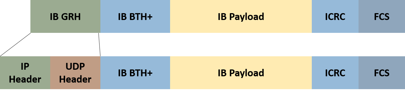

Types of RoCE
There are two versions of RDMA over Converged Ethernet: RoCE v1 and RoCE v2, depending on the network adapter used.
  1. RoCE v1: This protocol allows communication between two hosts within the same Ethernet broadcast domain (VLAN). It utilizes Ethertype 0x8915, limiting standard Ethernet frames to 1500 bytes and Ethernet jumbo frames to 9000 bytes.
  2. RoCE v2: Overcoming the limitation of RoCE v1 to a single broadcast domain, RoCE v2 introduces changes in packet encapsulation by including IP and UDP headers. This modification enables RoCE v2 to function across both L2 (Data Link Layer) and L3 (Network Layer) networks, allowing Layer 3 routing and scalability across multiple subnets. Referred to as Routable RoCE (RRoCE), RoCE v2 also introduces the capability of IP multicast.
RoCEv1 vs RoCEv2 Packet Format

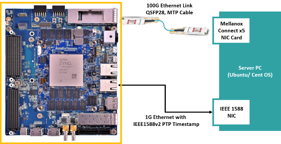

iWave, at the forefront of cutting-edge technology, has showcased the remarkable capabilities of its platform by successfully implementing 100G Ethernet solution. This was realized by using iWave’s Zynq UltraScale+ MPSoC powered development kit and integrating AMD’s ERNIC IP on the platform. The Zynq UltraScale+ MPSoC development kit is well suited for prototyping and evaluating 100G Ethernet solutions using high speed QSFP-28 connector.
The demo setup included
  • iWave’s Zynq Ultrascale+ MPSoC ZU19EG powered development kit
  • Mellanox Connect x 5 100 G NIC
  • Sync 1588 PTP Enabled 1G NIC
  • MTP Cable, QSFP-28 Modules and CAT6 RJ45 Ethernet Cable
  • Ubuntu 22.04 Server PC

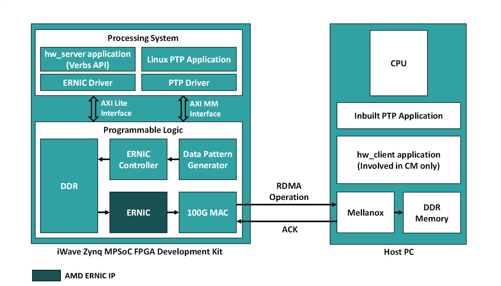

 System Architecture
The high-level architecture is illustrated in the image above, with the implementation segmented between the Processing System (PS) and Programmable Logic (PL) components within the Zynq UltraScale+ MPSoC. The PS features an ARM Cortex-A53 based Hard SoC, which is used for essential system configuration, control, and diagnosis. This includes:
  • 100G Ethernet MAC driver – Offering robust performance and low-latency support for data transmission at 100 Gb/s.
  • ERNIC Controller driver – Responsible for posting incoming data to DDR and notifying ERNIC IP, this driver also efficiently manages doorbell exchanges between the user application and ERNIC IP.
  • RDMA core and User Space Libraries – Ensures optimal performance and compatibility for RDMA operations in both kernel and user spaces.
The AMD ERNIC IP offloads the RoCEv2 Stack onto the FPGA. The ERNIC Controller manages handshaking with various modules to facilitate data transfer, generating work queue entries and ringing doorbells for the ERNIC IP. Meanwhile, the Zynq UltraScale+ MPSoC 100G Ethernet subsystem handles the MAC and Physical layers. Additionally, the Data Pattern Generator is tasked with generating both raw data and video data patterns.
PTP (IEEE 1588 Standard) timestamp is used to synchronize time between one system to another on an ethernet network. PTP timestamps enhance the performance of real-time applications by providing synchronized and low latency data exchange at nano second level.

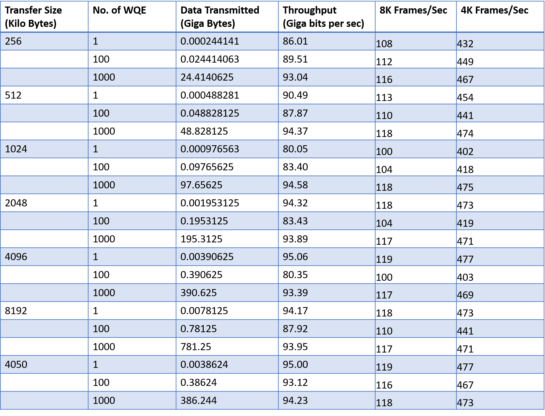

The detailed throughput statistics of the Zynq UltraScale+ MPSoC development kit to server PC video data transfer is provided in Table below. The MPSoC development platform receives 8K video @ >100 fps and 4K video @ >400fps.
