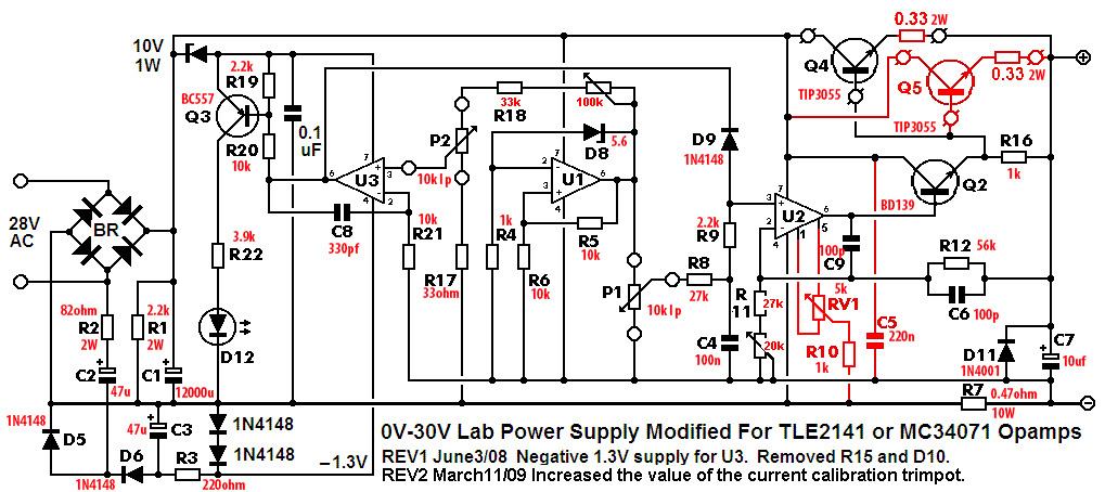

Guest 78L05 Posted July 13, 2013 Report Posted July 13, 2013 I drew my own PCB design based on original schematic (with 3 TL081), and I will be very happy if I could fix it without major changes.I tried to put 27k for R10, but the same thing hapeens. I didn't touch trimmer (it's now 100k). When I remove the capacitor on the output (C7) voltage is about - 0.15V. I put tantal capacitor at the same place but voltage is again about - 0.35V (like the first time).What to do? Quote
audioguru Posted July 14, 2013 Report Posted July 14, 2013 I drew my own PCB design based on original schematic (with 3 TL081), and I will be very happy if I could fix it without major changes.The TL081 has an absolute maximum allowed total supply of only 36VDC. The original circuit used a 24VAC transformer (that is too low) that produced a positive unloaded supply of 32.5VDC or more plus a negative supply of -5.6V so the total supply for the TL081 opamps is 38VDC or more which might blow them up!I tried to put 27k for R10, but the same thing happens.I showed that the datasheet for the TL081 uses 1.5k for R10.I didn't touch trimmer (it's now 100k). When I remove the capacitor on the output (C7) voltage is about - 0.15V. I put tantal capacitor at the same place but voltage is again about - 0.35V (like the first time).What to do?1) Use a 20VAC transformer. Then the TL081 opamps will not have a total supply voltage too high but the max output from the original circuit will be only about +21VDC.2) Change R10 to 1.5k.3) Use a film capacitor for C7.4) Adjust the trimmer for 0VDC output.Or make the fixed and improved circuit. Quote

Guest 78L05 Posted July 15, 2013 Report Posted July 15, 2013 I change R10 into 1.5k and nothing, voltage on output is -0.3V.I set voltage at 0.0V with potentiometer (10k), and measure resistance in that case, it's about 820R, so I added 820R resistor on the potentiometer and now when I turn potentiometer in the left side voltage is 0.0V, and when I turn it on the right side output voltage is 30.0V. Quote

audioguru Posted July 16, 2013 Report Posted July 16, 2013 78L05, can your power supply project produce 30VDC at 3A with low ripple?I think its maximum output voltage is about 25V or 26V at 3A.The little 2N2219 driver transistor and the single 2N3055 output transistor will be VERY hot when the output voltage is low and the current is 3A. Quote
Guest 78L05 Posted July 18, 2013 Report Posted July 18, 2013 I said that I made my own PCB, and changed few components.For example, instead of 2N2219 I put BD139 (on heatsink), and for output transistors I use 3xTIP35C with emiter resistors. Quote

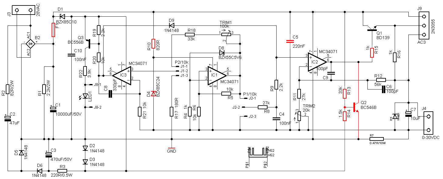

Guest Big zee Posted July 18, 2013 Report Posted July 18, 2013 dear allyou can see the different between the original and the other design he dropped a few and change places then he added diode and resistor for the U1 (pin 7)and there is the grounding and resistor on pin 6 of U2and of course you can see he put the transistor back from the old designand he fused it .I colored for you the different between the two of them Quote
Guest Big zee Posted July 18, 2013 Report Posted July 18, 2013 I said that I made my own PCB, and changed few components.For example, instead of 2N2219 I put BD139 (on heatsink), and for output transistors I use 3xTIP35C with emiter resistors.can you attached the PCB please Quote
Guest 78L05 Posted July 20, 2013 Report Posted July 20, 2013 It's in Sprint Layout 5.0, so I don't know how much it will be usefull for you. Quote
