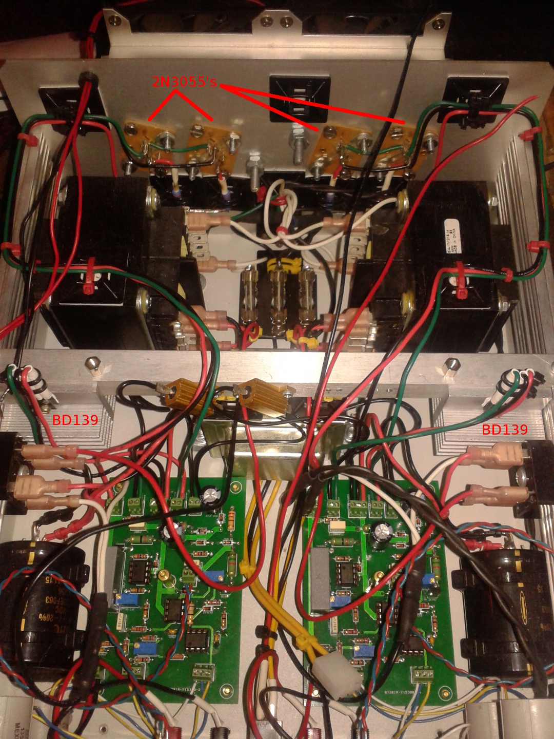

hey guys.  so ive built this suppy actually a duel both circuits being on the same pcb but totaly isolated from each other. except for the 3055's and bd139's which all mount to the same aluminum heat sink with resistors on a seperate pcb. its interesting what has been happening. ive had lots of issues with these boards and id solve them as i troubleshoot through them ive had them working fine then short circuit somthing on a test circuit and have to go through them and replace caps and chips. i now have 741's in u1 and u3 so i know that may contribute to not getting total current cutoff at my current cutoff setting. ill put a motor on output set my currrent limit then hold motor armeture. red light will come on and armeture force drops out but still have light voltage on output say 5v. i think with the right chip it would drop out to 0v. will be getting new chips until then its been a little dangourous to the board. any how after going through the entire circuit and getting my board corrected ive noticed somthing. when i fire one side up (oh i should state each circuit has its own toggle going from ac to bridge input) that both supplys will power up. now ive traced it back to one of the 3055's. now when all four 3055's are mounted to the heat sink and one toggle is on  both supplys power up they both operate what seems perfectlly fine going 0 to 30 seperatlly as typical. but i can pull one of the 3055's off the heatsink (the one that is bad) and the supplys will come on seperately and work as usual. am i possiblly seeing this cause the 3055's are in parrelle and i dont really see what is happining with the bad one till its tied to the heatsink. and how could this be suppying my other circuit if it is bad. i believe the chips heatsink is tied to the collector so i get 34v on the heatsink when eigther supply is on but how can it possibly be supplying my other circuit. it doesnt matter witch circuit i turn on while the bad one is mounted to the heatsink both circuits come on. i know were not all experts on how transistors fail but this whole progect was done so i may learn and understanding this failure is part of that any help would be appreciated. also i wanted to through this on there for other people who may see simular problems and reading through somthing like this with ya'lls input is a goldmine of understanding. i just want you guys to know how much we newbies appreciate your long time commitment to this thread. i've seen some of you guys here for years. and your comments are all that got me through this. thanks
Link to comment
Share on other sites
Guest liquibyte
I'm going with Redwire's assessment here.

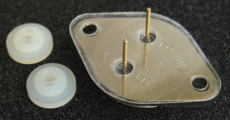

I hope you've been insulating the TO-3's with something like in the first picture.  This is how I have all four of mine on the same heatsink mounted to an all aluminum case.  A little non conductive thermal compound on both sides of the mica washer and you're good to go.  I went the extra mile in that the holes that the transistors leads and mounting screws go through also are lined with nylon tubing so everything is insulated just to be on the safe side.
As long as everything is insulated properly you'll never have issues.  If you can't insulate the transistors , you can insulate separate heatsinks with two 2N3055's each, just make sure the cases are at least tied together with a wire and don't just rely on the heatsink itself to act as a conductor, I wouldn't trust that.  I made sure that when mine were all mounted, I used a continuity tester to make sure the cases were isolated, as a matter of fact, I checked everything before powering up, three times.  Measure twice, cut once.  :P

Guest jeffrey13
this is great advice. i'll surelly do this. but in retrospect i wonder why i did not see this problem earlier when i first put it all together im thinking my heat transfer compound must have been insulating the chips (im actually using the tip3055. i think its the st255 style.) i have changed all my transiters numorous times trying to solve this.

Im thinking my heat transfer compound must have been insulating the chips (im actually using the tip3055. i think its the st255 style.) i have changed all my transiters numorous times trying to solve this.
Texas instruments invented the TIP3055 transistor and their datasheet says the collector pin is connected to the heatsink tab.
But ST Micro copied it and their datasheet does not say anything about the `live` heatsink tab.

Thermal compound can act as an insulator if enough is used though that's not how it should be applied.  The trick is to use as thin a layer as you can because it's just there to fill the microscopic gaps in the mating surfaces and create a smooth surface to transfer the heat.  I use an exacto knife to get the layer as thin as possible and spread one layer to the mica insulator and the other layer onto the transistor itself to ease positioning while putting things into place to avoid a mess.  I was careful enough when I did mine that I didn't even have anything to clean up afterwards.
The ON semi sheet has it as pinout #4.  I wonder if ST thought that the connection was implied and therefore left the info off their datasheet.  I always check the datasheets so as to not make mistakes but will always assume that if the package has any sort of metal plate that it's connected to one of the pins and must be isolated if not used that way.

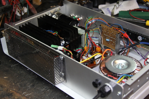

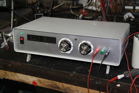

I'm new on this board, just wanted to thank you all for the excellent contributions on this topic. I wanted a bench power supply and came across your contribution. The amount of development is amazing. I made a PCB using Printmaster's single-sided template using the old photocopy and iron-on trick and built it during the Easter weekend. At first, my aim was just to try it out, but, surprised at how well it worked, I ended up using on old RS box and added a couple of LCD displays and making it into a project. OK, so its not like the beautiful "beast" that Liquibyte is building, it doesn't have the buzz of 50Volts like Redwire's and it probably won't meet Audioguru's approval, because it uses TIP3055's instead of the 2Ns. To be quite honest, the whole thing was built using junkbox components. It worked, basically, "out of the box". It deliver's the full 90 Watts and I just love the linear voltage and current limit scales. Ive attached a couple of pics. It needs tidying up, but for a weekend job, I'm very happy. Thanks again.

Don't knock yours, it's a beauty.  If you built two and put it in bigger box, you'd have what I'm doing.  I wish more people would post their pics.  I like to see how different people design and solve problems.
I don't even have my displays designed yet but they're coming.  I'm trying to decide on a temperature control system for the fans right now and am doing testing to find the "hot spots".  So far, the component that gets the hottest fully loaded is R7 so I'm thinking of using a fan for those as well and sensing the temp at that point to control the fans for the whole system.
