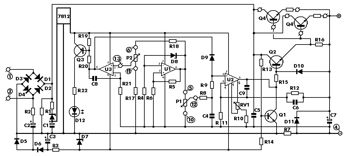

Trying to adapt your schematics for microcontroller control and indication.
Thinking about changing 11.2 volt reference voltage to 5.0 volt and using digital potentiometers.
Which purpose C5 serves for? Should I connect it phisycally close to Q2, as on the picture, or better close to U2?
Can it be ceramic type, or better polyester?

Which purpose C5 serves for? Should I connect it phisycally close to Q2, as on the picture, or better close to U2? Can it be ceramic type, or better polyester?
C5 is a high frequency filter. Mount it close to opamp U2. It should be a polyester film type.

sonycman,  U3 requires a voltage between 0 and 1.5V (for 3A output) and U2 requires a voltage between 0 and 11.2V to adjust the output voltage.  If you are using a microcontroller, couldn't  you delete U1, and U3 and feed a DAC signal to U2 of 0-5 V to control voltage (Yes you will need to adjust the gain for U2 by changing R12 to about  70K and R1 to about 10K so you get a gain of about 6 so that the 0-4.5V signal will provide the same amplification as the original project).  The microcontroller would also control the current by measuring  the voltage drop across R7 and  replace  U3.  If the voltage drop across R7 was greater than your set voltage, then the microcontroller could automatically drop the voltage to U2 until it matched or was lower than the set voltage.  You could also incorporate a temperature sensor that could also reduce current if a certain value is achieved.    Make sure you pick a processer that has enough pins to support these features and a LCD display.  Not sure if a digital potentiometer is necessary.

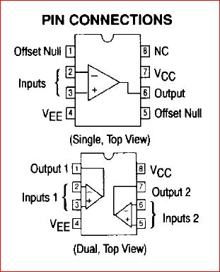

Unfortunately, both the op-amps MC34071 and TLE2141 is not available in my country but there is MC34074 available.
Are you using the single op-amps or the duals ?
Is it possible to replace the three MC34071s with one MC34074 ? but the problem remains in U2 for the pins 1 & 5
An MC34074 will probably get too hot.

If I use MC34074 with a big heat sink and a computer fan and did you use the offset null for U2 ?
On the other hand, MC34074 do not have any offset null.

I do not know why you cannot buy ordinary parts in your country.
An MC34071 quad opamp is in an epoxy package that cannot have a heatsink. You can glue on a heatsink but the epoxy will not conduct heat to it well.
The input offset adjustment on opamp U2 sets the output to exactly 0V when the voltage-setting pot is at zero.
Without adjusting the offset then the output could be plus or minus 20mV.

Should I try this old modified one proposed by Ivan on 02/2010.
Oh, I forget to mention that I already bought the old parts last year :(
The circuit you found uses a 7812 voltage regulator so that the original opamps do not have a supply voltage too high. Then opamp U1 will not work unless its circuit is changed to reduce its output voltage.
The maximum output from opamp U2 is about +9.5V and the maximum output voltage from the project is about +6V. If the original 24VAC transformer is used then Q2 will get extremely hot and might fail and the output transistors will get very hot.
