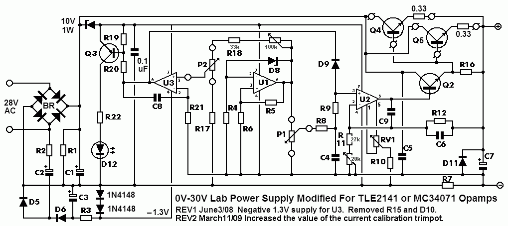

audioguru Posted February 27, 2014 Report Share Posted February 27, 2014 Add another 2V for the negative rail on U2 results in 43V across U2.Using a TLE2141 opamp for U2, a negative supply is not needed. The inputs will work slightly below ground but go down to only 0V and the output will go almost to ground but goes only as low as about +1.1V in this circuit. Quote Link to comment Share on other sites More sharing options...
audioguru Posted February 27, 2014 Report Share Posted February 27, 2014 .....work out some sort of voltage drop later on.The high supply voltage problem has already been worked out for opamp U3 because it uses a -1.3V negative supply. So its positive supply pin is powered through a 10V zener diode which reduces its supply voltage by 10V.Power your U1 and U2 from this zener diode too to reduce their supply voltage. Check the zener diode for heat. Quote Link to comment Share on other sites More sharing options...
Guest liquibyte Posted February 27, 2014 Report Share Posted February 27, 2014 The high supply voltage problem has already been worked out for opamp U3 because it uses a -1.3V negative supply. So its positive supply pin is powered through a 10V zener diode which reduces its supply voltage by 10V.Power your U1 and U2 from this zener diode too to reduce their supply voltage. Check the zener diode for heat.Like this?Edit: removed pic to avoid confusion with other schematics. Quote Link to comment Share on other sites More sharing options...
audioguru Posted February 27, 2014 Report Share Posted February 27, 2014 Like this?Absolutely NOT!You have more than 3A passing through the zener diode because it also feeds the driver and output transistors which do not need their voltage reduced. With a current of more than 3A then the poor little zener diode will blow up like a bomb. Quote Link to comment Share on other sites More sharing options...
Guest liquibyte Posted February 27, 2014 Report Share Posted February 27, 2014 Yeah, I just realized that mistake. Leave the transistors on the original input and split off the U1 and U2 through the zener right? Quote Link to comment Share on other sites More sharing options...
audioguru Posted February 27, 2014 Report Share Posted February 27, 2014 Yeah, I just realized that mistake. Leave the transistors on the original input and split off the U1 and U2 through the zener right?Correct. Quote Link to comment Share on other sites More sharing options...

redwire Posted March 1, 2014 Author Report Share Posted March 1, 2014 Using a TLE2141 opamp for U2, a negative supply is not needed. The inputs will work slightly below ground but go down to only 0V and the output will go almost to ground but goes only as low as about +1.1V in this circuit. You are correct. I must have been thinking of another circuit. On another note, there is no reason for U1 to need a 41V input rail. It only needs about 13-14V in order to supply a constant 12.2 V. Why didn't we connect the positive rail of U1 to the 10V zener like U3 and drop 10V? Quote Link to comment Share on other sites More sharing options...
audioguru Posted March 2, 2014 Report Share Posted March 2, 2014 On another note, there is no reason for U1 to need a 41V input rail. It only needs about 13-14V in order to supply a constant 12.2 V. Why didn't we connect the positive rail of U1 to the 10V zener like U3 and drop 10V?Like opamp U2, U1 also does not have a negative supply. With a good 28V transformer, with no load its supply is +40.5V which is less than its 44V maximum.U1 can be powered from the 10V zener diode together with U3 if you want and if the zener diode is rated at 1W then it will get only fairly warm. Quote Link to comment Share on other sites More sharing options...
Guest liquibyte Posted March 2, 2014 Report Share Posted March 2, 2014 Like opamp U2, U1 also does not have a negative supply. With a good 28V transformer, with no load its supply is +40.5V which is less than its 44V maximum.U1 can be powered from the 10V zener diode together with U3 if you want and if the zener diode is rated at 1W then it will get only fairly warm.If I were to drop in two seperate 12V 1W zeners for U1 and U2 instead of all three going through the 10V would that be ok? I have two sitting here that could be used for this if it's possible without disrupting the circuit too much. Quote Link to comment Share on other sites More sharing options...
audioguru Posted March 2, 2014 Report Share Posted March 2, 2014 With a 12V zener diode reducing the raw positive supply to opamp U2 then your project will not produce regulated +30V at 3A. It might produce regulated 27V with no load, 25V at 1.5A and 23V at 3A.Its output will have lots of ripple at high voltage/high current. Quote Link to comment Share on other sites More sharing options...
Guest liquibyte Posted March 2, 2014 Report Share Posted March 2, 2014 So U1 and U3 through the 10V zener. Maybe a voltage drop with diodes through U2? I've tried to get a good drop after the rectifier but even with two power diodes I can only get it down to 44.3 volts. I think the 0.7 volt drop talked about a lot is theoretical and not practical, either that or I have some really efficient diodes. Quote Link to comment Share on other sites More sharing options...
audioguru Posted March 2, 2014 Report Share Posted March 2, 2014 The forward voltage drop of a diode depends on its current because it has some resistance.Without a load on this project its opamps current is only 9mA for U1 and 3.4mA for each of U2 and U3.At a few mA the voltage drop of a 1N400x rectifier might be only 0.5V. Quote Link to comment Share on other sites More sharing options...
Guest liquibyte Posted March 2, 2014 Report Share Posted March 2, 2014 I've got it planned out now to run U1 and U3 through the 10V zener and I'm going to drop a volt point something through a couple of 1N4005's in series which should get me under my 44V max on U2. I've been consistently running tests for the voltage after the smoothing caps and I get between 44.7 and 45 volts so I think this may work. Quote Link to comment Share on other sites More sharing options...
redwire Posted March 2, 2014 Author Report Share Posted March 2, 2014 liquidbyte , I I personally think you are splitting hairs on getting to exactly 44V or less on U2, but if it helps you sleep better, you could put a 5.6V zener between the positive rail and pin 7 of U2. Since you need at least one 5.6V zener for the project, it is likely you have a spare. Hey, if thing don't work out just put a piece of wire across the Zener. Quote Link to comment Share on other sites More sharing options...

Guest rencajs Posted March 8, 2014 Report Share Posted March 8, 2014 Hi guys! I just builded original power supply project based on tl081 opamps and now i realised that there was some major problems vith original project but now i cant find solution :(The problem is that U2 is heating up but in output there is only 200mV. I checked components and nominals and everything ir wright but still i cant find promlem :( Could you please give me some advise? Quote Link to comment Share on other sites More sharing options...
audioguru Posted March 8, 2014 Report Share Posted March 8, 2014 The original project used a 24VAC transformer that was overloaded at maximum power. It produced about 25.5VAC with no load then its peak voltage was 36V that was reduced to 34.7V by the bridge rectifier.The opamps used this as their positive supply but U2 also has a -5.6V negative supply so its total supply was 40.3VDC. Its maximum allowed supply is only 36V so it fails. the 24VAC transformer does not allow this project to make 30VDC at 3A anyway because its voltage is too low (its power rating is also too low).Many more parts in the original project are overloaded especially the single output transistor and its driver transistor.You can replace the TL081 opamp with a TLE2141 opamp that has a maximum allowed total supply of 44V but maybe the overloaded output transistor or driver transistor have also failed. Quote Link to comment Share on other sites More sharing options...
Guest liquibyte Posted March 8, 2014 Report Share Posted March 8, 2014 Is there a specific procedure that you use to calibrate this circuit? I've finally got both of my circuits working but am not sure where to set RV1, 2, and 3 when I start this up. I know that setting RV2 and RV3 sets the limits of voltage and current. What am I setting with RV1, what do I look for and where am I measuring from to get this set right? I don't want to release the magic smoke by doing things wrong so I figured I'd ask how others have started. Quote Link to comment Share on other sites More sharing options...
audioguru Posted March 8, 2014 Report Share Posted March 8, 2014 What am I setting with RV1, what do I look for and where am I measuring from to get this set right?Set the voltage pot to zero and adjust RV1 so that the output voltage is exactly 0V. You will be able to adjust it from about +50mV to -50mV. If the output capacitor C7 is an electrolytic type then it will have dielectric absorption which will cause the output voltage to be a little positive instead of 0V. A film type of capacitor will not do this. Quote Link to comment Share on other sites More sharing options...
Guest liquibyte Posted March 9, 2014 Report Share Posted March 9, 2014 I'm actually pulling -100+mV at zero and no matter what I adjust, the voltage doesn't change that much. In addition, the most I can get out of each circuit is around 10V, not the 30 I was hoping for. Quote Link to comment Share on other sites More sharing options...
audioguru Posted March 9, 2014 Report Share Posted March 9, 2014 I'm actually pulling -100+mV at zeroI do not know what "pulling" is. If RV1 can adjust the output +/-100mV then that is good. Simply adjust for 0V.no matter what I adjust, the voltage doesn't change that much. In addition, the most I can get out of each circuit is around 10V, not the 30 I was hoping for.Then you have something very wrong. I will look back to see what modifications you have. Quote Link to comment Share on other sites More sharing options...
