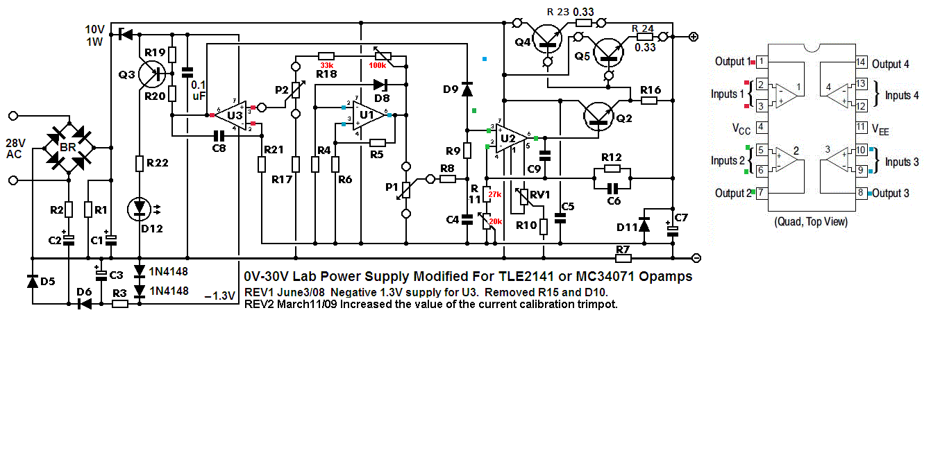

Guest electroguy Posted February 14, 2014 Report Posted February 14, 2014 Instead of redesigning the circuit for the quad one, what if I just place all the pins: 2;3;6 of U1,U2,U3 at the input and output of the quad one. will it work ?The design is shown below.The three red/ blue/ green dots represents the input and output of the quad one.As I also bought the old parts, is it going to be wasted?The transformer is 24V 3A, if I buy MC34074 and use it for 24V, less than 30V will not be a big problem for me.@redwire: a few millivolts is not a problem for me Quote

Guest liquibyte Posted February 26, 2014 Report Posted February 26, 2014 I started asking about hooking up the TO-3's over at EEVBlog because it's a much more active site and I was looking for an immediate answer to my question. I am getting a bit of negative feedback regarding the fact that someone thinks that this design isn't sustainable due to the fact that with a 28V transformer after rectification and smoothing that the voltage into the opamps is going to be around 50V. Has anyone that's built the 3 amp version run into issues with this? If so, what sort of solution did you use to fix the issue to get the voltage to less than 44V so as to not overload the max limits on the TLE2141's?.Edit: Nevermind. I hooked up the filter cap and measured 45.1 VDC. It's a little over the 44V max of the op amps which worries me a bit. So I guess a new question would be, is there a recommended way to drop that to the 44V? Voltage divider to ground? Quote
audioguru Posted February 26, 2014 Report Posted February 26, 2014 The peak of 28V RMS is 28V x 1.414= 39.6V. The bridge rectifier drops 1.2V when the current is very low so the positive voltage is 39.6V - 1.2V= 38.4V. The opamp U2 is the only one using the full 38.4V which is not near the maximum allowed voltage of 44V.I selected a Hammond high quality torroid transformer that has good voltage regulation. its voltage is 29.5V with no load. Then its peak is 41.7V and the bridge rectifier drops it to 40.5V which is still less than the maximum allowed 44V.Maybe you used a cheap transformer with poor voltage regulation and maybe your AC electricity voltage is too high. Quote
Guest liquibyte Posted February 26, 2014 Report Posted February 26, 2014 I typically get 122.4 VAC out of the wall.The transformers I'm using are Triad Magnetics VPS28-4600's with the following ratings wired parallel input and serial output:1. Maximum Power: 130.0VA2. Primary – Series: 230VAC, 50/60Hz; Parallel: 115VAC, 50/60Hz3. Secondary: Series: 28.0V CT@ 4.6A; Parallel: 14.0V @ 9.2A4. Voltage Regulation: 25% TYP @ full load to no load5. Temperature Rise: 30C TYP (45C MAX allowed)6. Insulation Resistance: 100MΩWhen I measure the output of each transformer I get 35.5 VAC and 35.4 VAC (building two units). After rectification I get 28.5-28.6 VDC (it fluctuates a bit) and after I hook up the smoothing caps I get right around 45 VDC for each transformer.I'm not sure what I should do now. I don't want to exceed the op amp ratings and I'm not sure whether I should work on a limiting circuit or try and find a higher rated op amp to replace these. Any suggestions? Quote
audioguru Posted February 26, 2014 Report Posted February 26, 2014 Years ago I selected an opamp with a 90V maximum power supply rating but it was not available frequently and was not common in distant countries.Connect the + supply pin of all the opamps to the 10V zener diode, and feel if it gets hot. Quote
redwire Posted February 26, 2014 Author Report Posted February 26, 2014 liquidbyte I have the Triad Magnetics VPS28-6250 (175VA) transformer and I am getting approx 41VDC rectified. Add another 2V for the negative rail on U2 results in 43V across U2. The TLE2141's are rugged devices. In my first unit, I used a home built transformer that puts out nearly 60VDC rectified. I was concerned about the TLE2141's operating well outside of their specifications so I put them on sockets in case I smoked one. I did blow one when I had wires crossed during fabrication but once corrected I never had a problem. I don't use the high voltage unit much but its been working for several years. I am fairly confident that operating the TLE2141's at 44-45Volts will not be a problem. I just built a smd version of this board using smd TLE2141's using the same 175va,28V transformer. I haven't had any issues or temperature problems. JUST BUILD IT! Quote
Guest liquibyte Posted February 26, 2014 Report Posted February 26, 2014 Thank you guys for your help. I made sure that I got sockets as well, just in case. I've been doing measurements for a few hours off and on and I'm getting a steady 44.6 V out of both sides now. I feel better now that I know you ran one at 60 V. I'll go ahead with the build and see how things work out. Worse case scenario is I'll have to replace op amps and work out some sort of voltage drop later on. There's room in the case so everything's good. Quote
