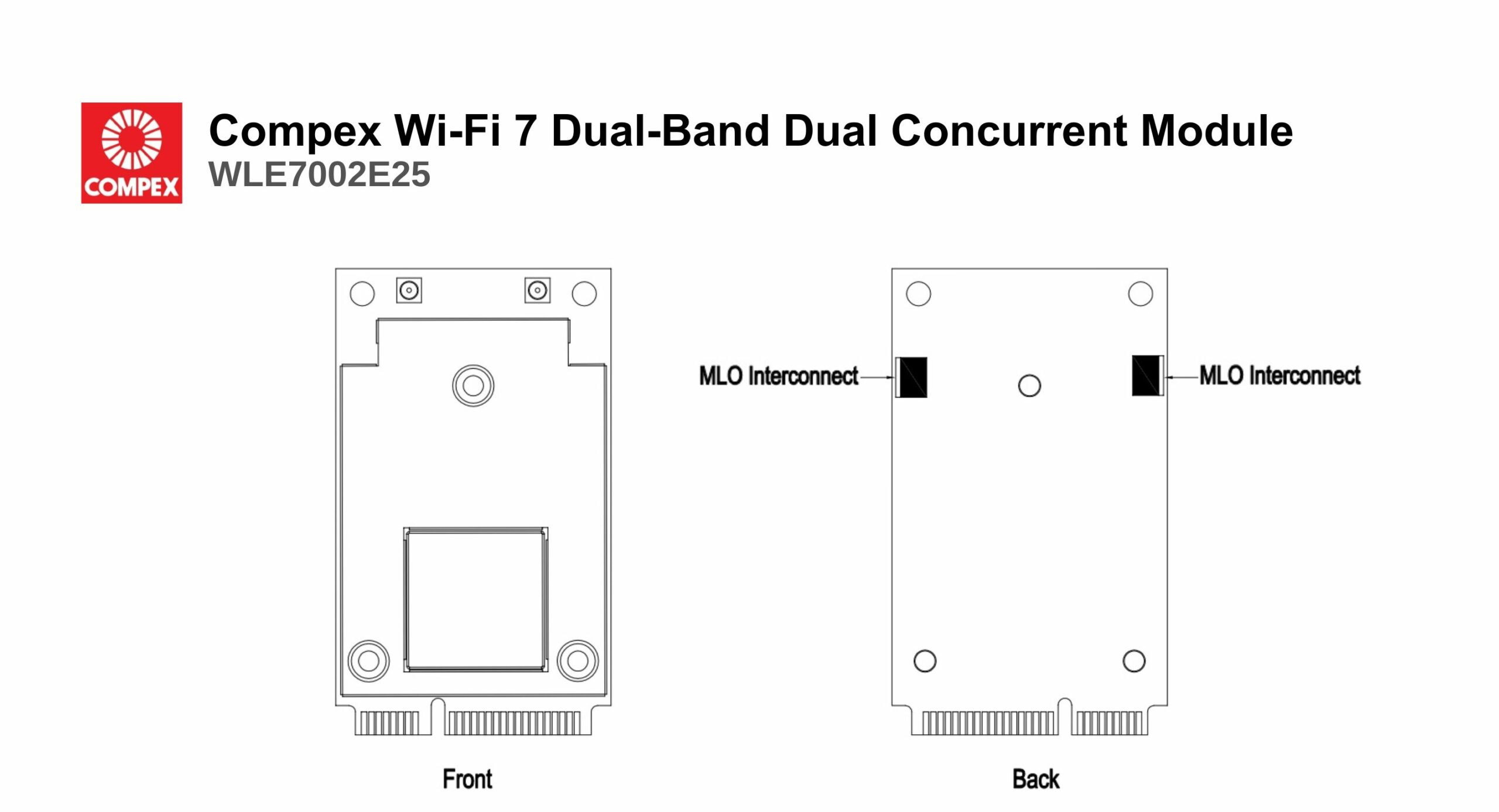

Implementing MLO typically requires custom host board designs with impedance-controlled traces to route high-speed signals between radios through card edge gold fingers, which pose challenges for 3rd party host boards as most do not support the interconnecting traces. Compex’s latest advancement features miniature interconnects and proprietary-configured connecting cables that enable high-speed MLO/WSI signals routing across multiple radios. The MLO/WSI signals are single-ended synchronous data streams, which require great care when routed, even on impedance-controlled PCBs. The Compex’s patent-pending signal conditioning design ensures optimal data transfer while minimizing EMI. With Compex’s MLO Interconnect, the incredible speed and efficiency of Wi-Fi 7 with MLO are accessible across different CPU platforms, including those with Intel x86 and ARM processors, delivering lightning-fast connectivity and high-performance Wi-Fi 7 for both dynamic enterprise and industrial settings.

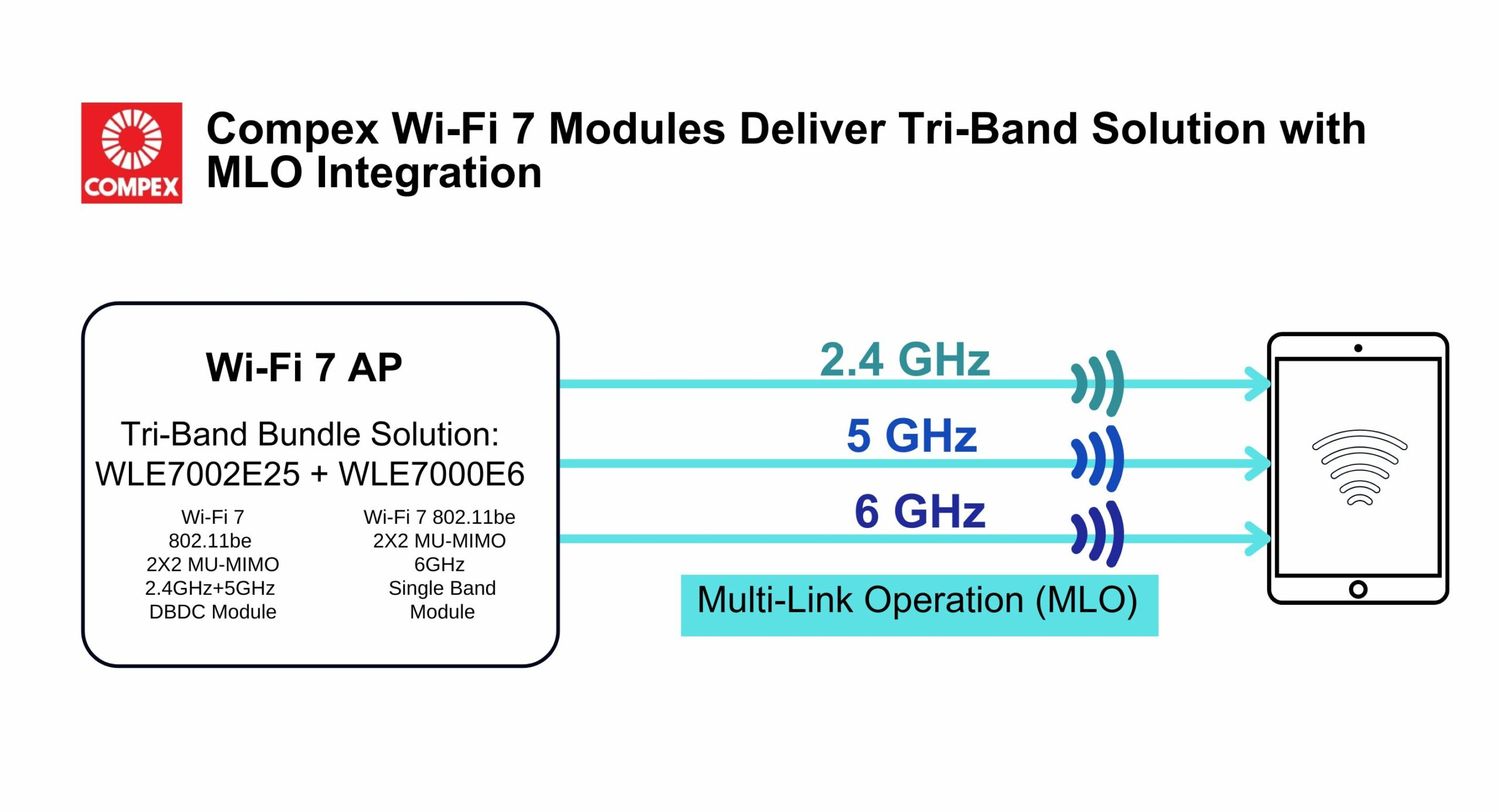

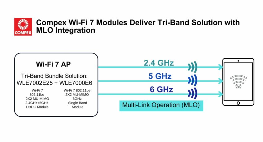

Compex’s Wi-Fi 7 module, WLE7002E25 and WLE7000E6, integrates MLO with smart MLO connectors, delivering a powerful Wi-Fi 7 Tri-Band Bundle Solution.
Building on the Compex’s Wi-Fi 7 modules, the standard miniPCIe form factor WLE7002E25 (Wi-Fi 7 802.11be 2X2 MU-MIMO 2.4GHz+5GHz Dual-Band Concurrent Module) and WLE7002E6 (Wi-Fi 7 802.11be 2X2 MU-MIMO 6GHz Module), deliver MLO-enhanced performance with improved latency and reliability. This Tri-Band Bundle Solution, supporting 2.4GHz, 5GHz and 6GHz, is a game-changing combination that offers low-latency and high-reliability, making it ideal for bandwidth-intensive and high-demand applicants. Additionally, the Compex standard miniPCIe form factor WLE7002E26 and WLE7002E55 deliver a powerful Quad-Band Bundle Solution with MLO capabilities, further expanding Compex’s product lineup of high-performance Wi-Fi 7 wireless solutions.
