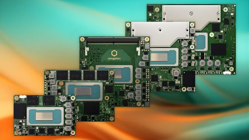

Congatec’s five new COMs come in four different form factors
Congatec’s five new COMs come in four different form factors. Image used courtesy of Congatec
For applications requiring maximum I/O bandwidth, congatec offers two COM-HPC modules. The conga-HPC/mPTL in the COM-HPC Mini form factor and conga-HPC/cPTL in the COM-HPC Client Size A both support PCIe Gen5 and USB4 interfaces. These modules enable higher data throughput for applications such as machine vision, data acquisition, and edge computing with multiple high-speed peripherals.
