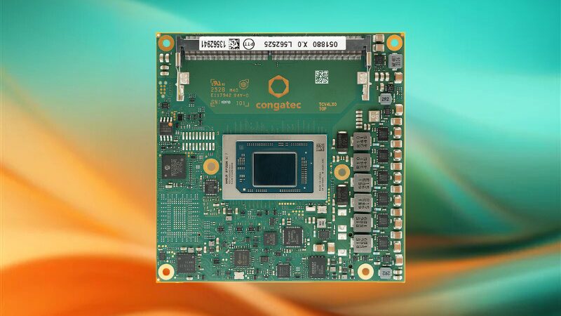

Congatec’s conga-TCRP1 modules, built on the AMD Ryzen AI Embedded P100 Series processors.
Congatec’s conga-TCRP1 modules, built on the AMD Ryzen AI Embedded P100 series processors. Image used courtesy of Congatec

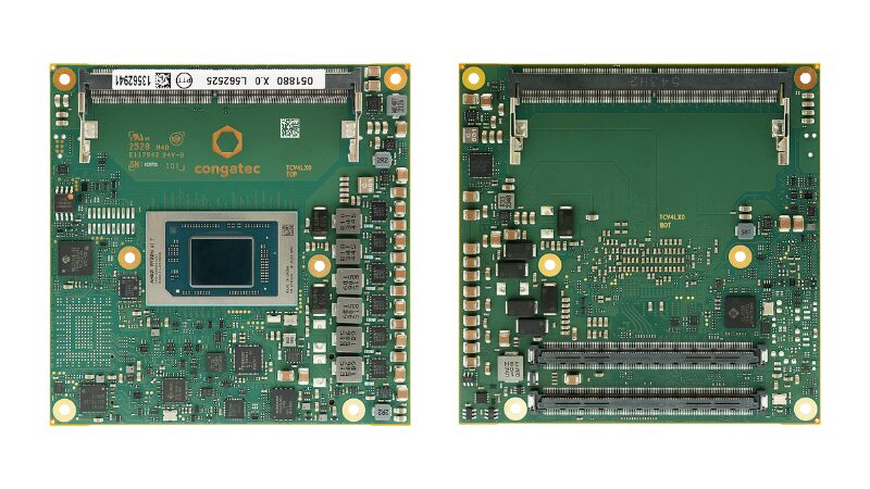

Top (left) and bottom (right) view of the conga-TCRP1 module
Top (left) and bottom (right) view of the conga-TCRP1 module. Image used courtesy of Congatec
