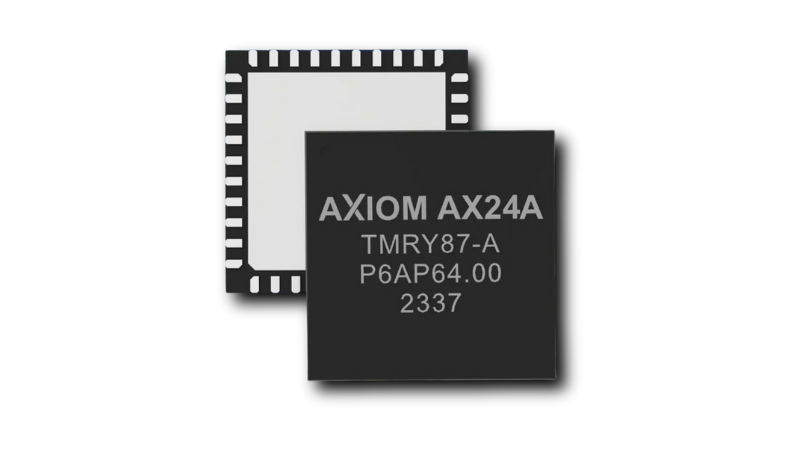

The AX24A joins the company’s Axiom product family and comes in a 40-pin QFN package.
TouchNetix’s AX24A touch-and-force-sensing controller comes in a 40-pin QFN package
TouchNetix’s AX24A touch-and-force-sensing controller comes in a 40-pin QFN package. Image used courtesy of TouchNetix
AX24A Sensing Controller

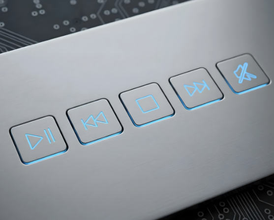

The AX24A can detect force changes from 20 g to 20 kg with micron-level precision and linear response characteristics. A notable feature of the controller is its ability to implement force-only buttons behind conductive materials, including metal panels. This capability enables button placement in environments where traditional capacitive touch sensing would not function while also providing water- and fluid-tolerance.
For joystick implementations, the force-sensing approach offers longer operational life compared to mechanical switches or variable resistors. The controller includes Pilot ID support for user differentiation and safety features.
TouchNetix has designed the AX24A for touch and force buttons in industrial, automotive, and consumer applications
TouchNetix has designed the AX24A for touch and force buttons in industrial, automotive, and consumer applications. Image used courtesy of TouchNetix
