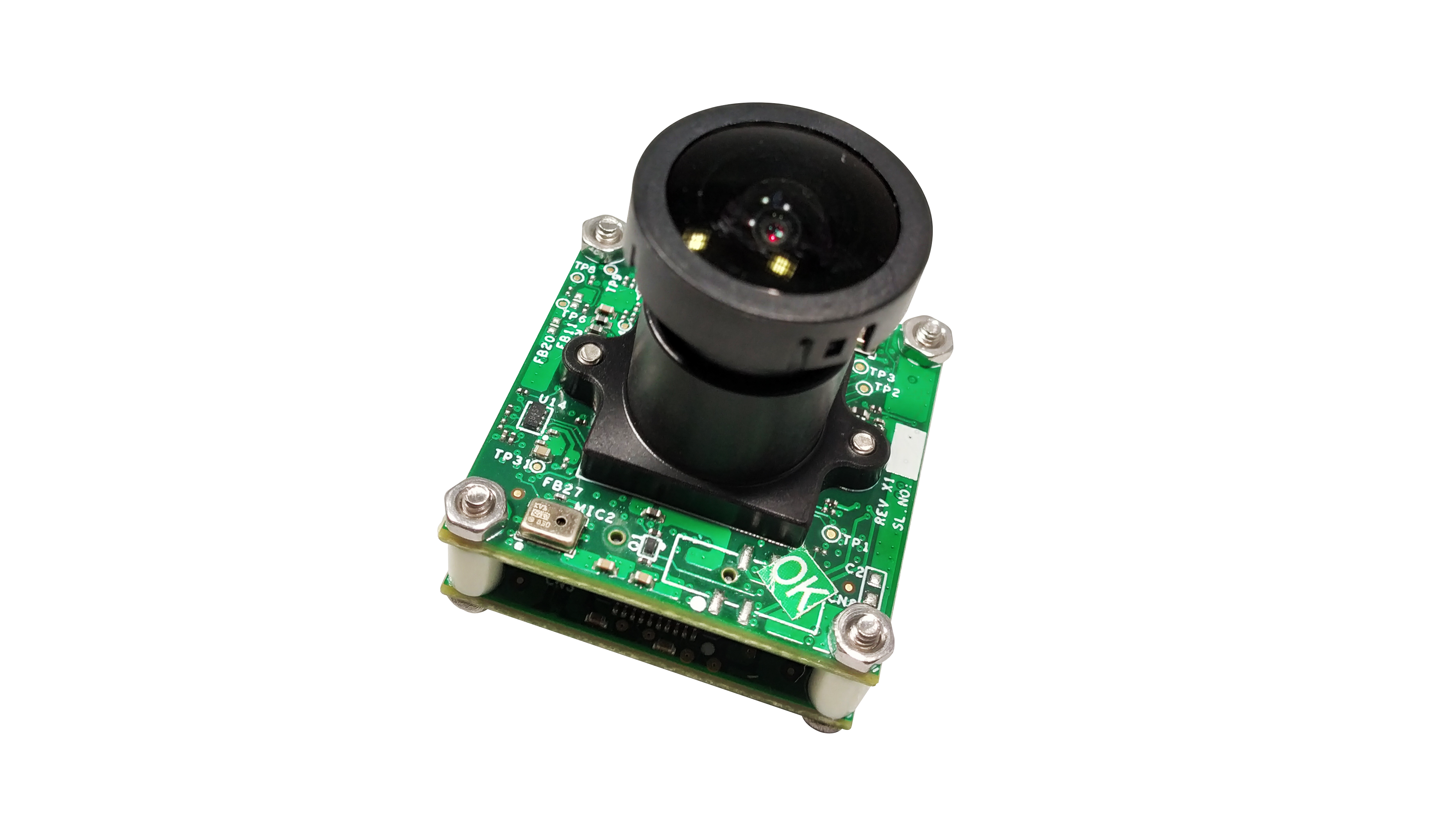

The Conversa also known with the code name See3CAM_CU38 is a USB 3.1 Gen 1 based Camera with an inbuilt stereo microphone and supports low light environment. The camera module is a 3.4 MP custom lens fixed focus camera, and the built-in stereo microphone can provide 16bit audio @48KHz. Supplied with the camera is an S-mount (M12) lens holder that is expected to allow users to choose what sort of lens they choose to use with it.
Conversa – A USB 3.1 Camera with Microphone and supports Low Light
The Conversa camera module is based on its predecessor, the See3CAM_CU30, which is a similar low light USB camera but doesn’t feature a microphone. The camera is based on the AR0330 sensor from ON Semiconductor which gives it the superbly low light performance. The camera can stream FHD (1920 x 1080) at 60 fps and HD (1280 x 720) at 60 fps in both Uncompressed UYVY and Compressed MJPEG formats.
With a dedicated ISP (Image Signal Processor) chip, the camera can perform all the Auto functions (Auto White Balance, Auto Exposure Control) with support for a processing pipeline which helps in providing video and MJPEG compressions. It is a plug-and-play (UVC and UAC) compliant USB 3.1 Gen1 SuperSpeed camera and is also backward compatible with USB 2.0 host ports.
