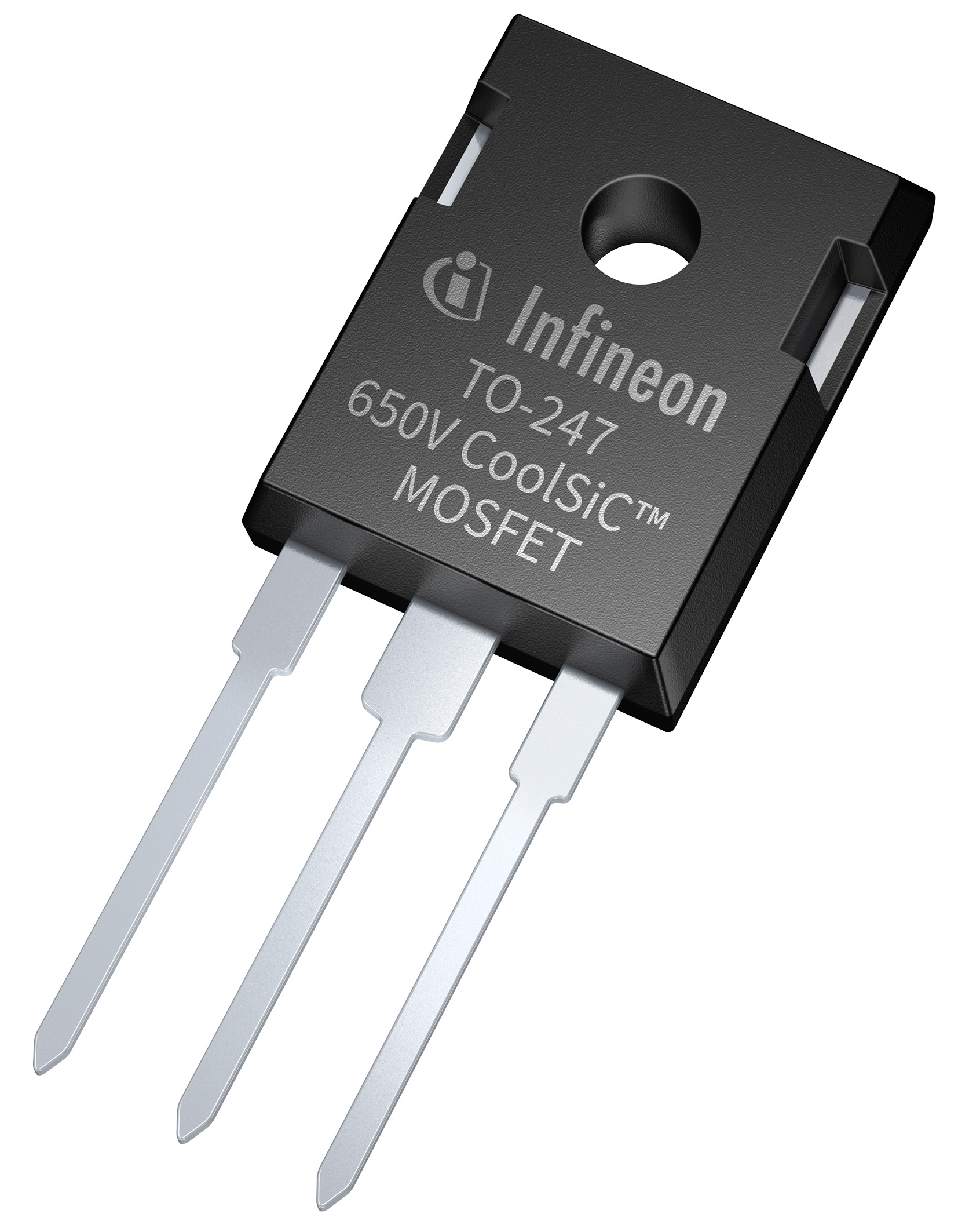

The CoolSiC MOSFET 650 V devices are rated from 27 mΩ to 107 mΩ. They are available in classic TO-247 3-pin as well as TO-247 4-pin packages, which allows for even lower switching losses. As for all previously launched CoolSiC MOSFET products, the new family of 650 V devices are based on Infineon’s state-of-the-art trench semiconductor technology. Maximizing the strong physical characteristics of SiC, this ensures that the devices offer superior reliability, best-in-class switching and conduction losses. Additionally, they feature highest transconductance level (gain), threshold voltage (V th) of 4 V and short-circuit robustness. Thus, trench technology allows for the lowest losses in the application and highest reliability in operation – without any compromise.
650 V CoolSiC MOSFETs offer attractive benefits in comparison to other silicon and silicon carbide solutions in the market such as switching efficiency at higher frequencies and outstanding reliability. Thanks to the very low on-state resistance (R DS(on)) dependency on temperature they feature an excellent thermal behavior. The devices boast robust and stable body diodes retaining a very low level of reverse recovery charge (Q rr), roughly 80 percent less compared to the best superjunction CoolMOS™ MOSFET. The commutation-robustness helps in achieving very easily an overall system efficiency of 98 percent, e.g. through the usage of continuous conduction mode totem-pole power factor correction (PFC).
