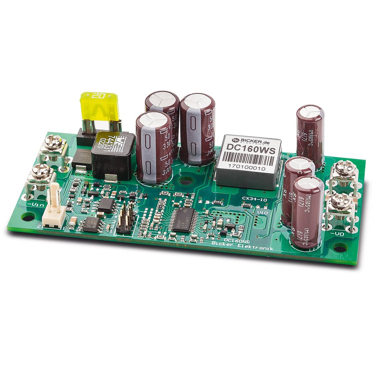

The DC/DC converter DC160WS delivers fanless 160 watts of continuous power at a constant high efficiency of up to 98%. In addition to the ultra-wide input range of 6 to 36 VDC, the compact converter offers three jumper-selectable output voltages of 12, 19 or 24 VDC, so that virtually any equivalent single-voltage mainboard or computer system can be powered..

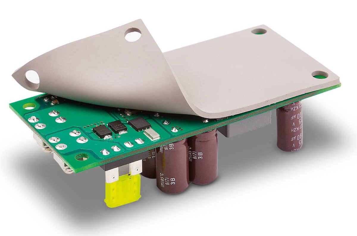

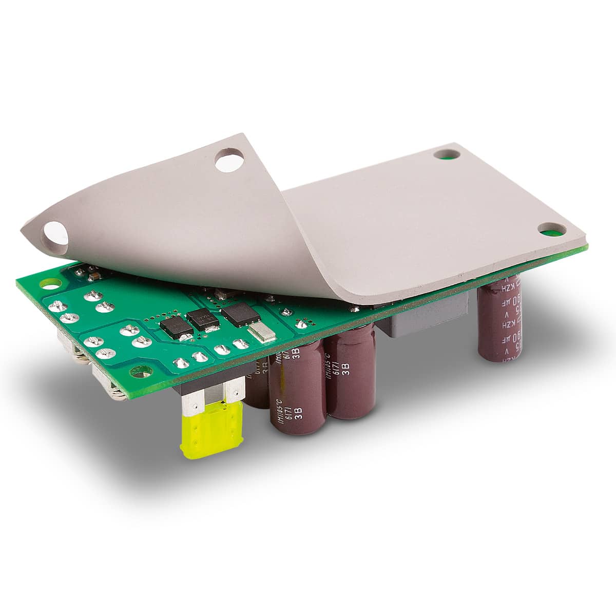

Developed for long-term 24/7 continuous operation in the extended temperature range from -20 to +70°C, the DC160WS is equipped with premium components of highest quality. With a footprint of only 95 x 45 mm and a height of 1″ (25.4 mm), the highly efficient DC/DC converter can be perfectly integrated into compact and closed IPC and Embedded BoxPC systems. In addition, the DC160WS is ideal for the reliable power supply of regulating and control electronics, actuators, sensors, DC motor drives and cameras.

  • DC/DC converter with 160W power fanless
  • Ultra wide input range 6…36VDC
  • Selectable output voltage +12V, +19V or +24VDC
  • Extended temperature range -20…+70°C
  • High efficiency up to 98%
  • Compact design
  • High reliability due to premium quality components
  • Including thermal pad for chassis mounting
  • Optional EMC filter for EN 55022 class B available
