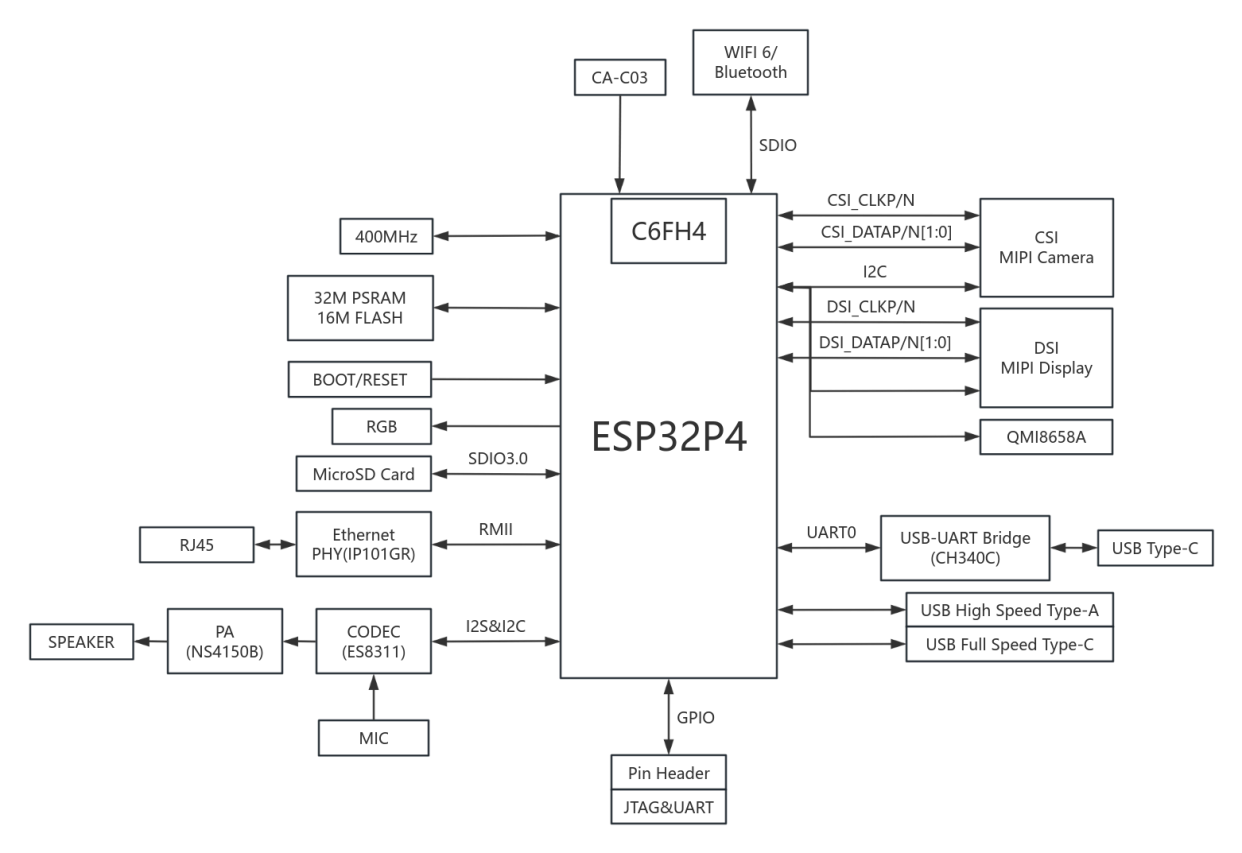

ESP32-P4-Pi-VIEWE Block Diagram

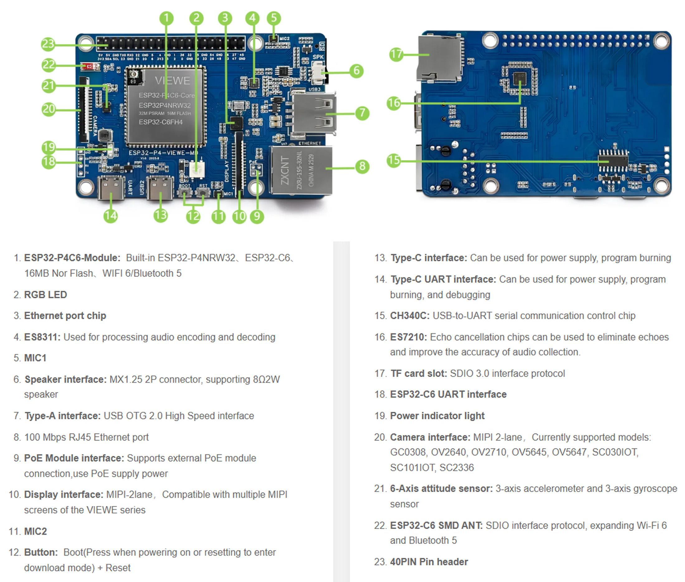

ESP32-P4-Pi board layout showing key components, ports, and interfaces

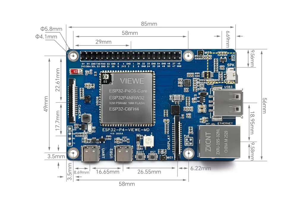

ESP32-P4-Pi board Dimensions
