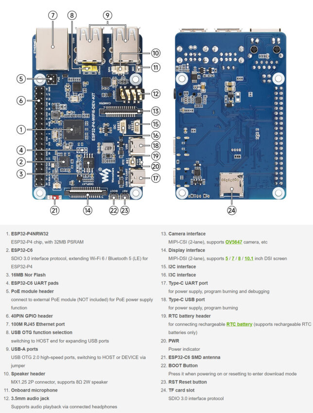

ESP32-P4-WIFI6-DEV-KIT development board Hardware Overview
ESP32-P4-WIFI6-DEV-KIT Hardware Overview

Waveshare ESP32-P4-WIFI6-DEV-KIT Specifications:
  • SoC (Dual SoC Design):
    • Microcontroller: ESP32-P4NRW32
      • MCU
        • Dual-core RISC-V microcontroller @ 400 MHz with AI instructions extension and single-precision FPU
        • Single-RISC-V LP (Low-power) MCU core @ up to 40 MHz
      • GPU: 2D Pixel Processing Accelerator (PPA)
      • VPU: H.264 and JPEG codecs support
      • Memory: 768 KB HP L2MEM, 32 KB LP SRAM, 8 KB TCM, 32MB PSRAM
      • Storage: 128 KB HP ROM, 16 KB LP ROM
    • Wireless: 2.4 GHz Wi-Fi 6 + Bluetooth 5/BLE (via SDIO 3.0 interface)
    • Storage: 16MB NOR Flash
  • Storage: MicroSD card slot (SDIO 3.0)
  • Display:
    • MIPI-DSI 2-lane interface, supports 5/7/8/10.1″ displays
    • Optional 7″ (720×1280) or 10.1″ (800×1280) capacitive touchscreens with 10-point touch
  • Camera: MIPI-CSI 2-lane interface with ISP, supports OV5647 and similar cameras
  • Audio:
    • Onboard microphone
    • 3.5mm audio jack (headphone output)
    • 2-pin speaker header (8Ω/2W supported)
  • Networking:
    • Wi-Fi 6 (ESP32-C6)
    • Bluetooth 5 / BLE (ESP32-C6)
    • 10/100M Ethernet (RJ45 port)
    • Reserved PoE module header (optional PoE HAT, not included)
  • USB:
    • USB OTG 2.0 high-speed, configurable as HOST or DEVICE via jumper
    • 2x USB-A host ports
    • 2x USB Type-C UART port (power, programming, debugging)
  • Expansion:
    • 40-pin GPIO header (28 usable programmable GPIOs)
    • I²C, I³C, SPI, UART, TWAI (CAN), ADC, PWM, RMT
    • ESP32-C6 UART pads for debugging
  • Misc:
    • BOOT & RST buttons
    • Power indicator LED
    • USB OTG function switch (host/device)
    • Supports AI speech interaction with online LLM platforms
    • RTC battery header (rechargeable only)
    • ESP32-C6 SMD antenna
  • Power Supply:
    • 5V from USB Type-C
    • 5V from USB OTG (host/device)
    • 5V via PoE header (with optional

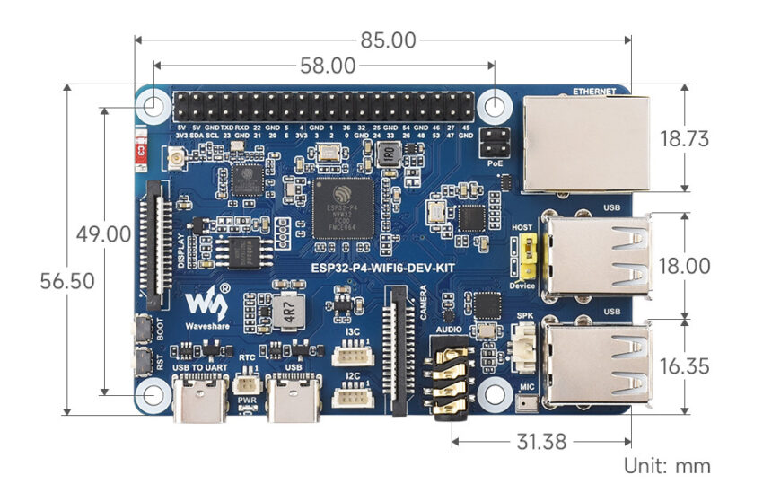

  • Dimensions: 85 x 56 mm
The ESP32-P4-WIFI6-DEV-KIT supports ESP-IDF for full access to Wi-Fi 6, BLE 5, Ethernet, USB, MIPI-CSI/DSI, and security features. It also works with Arduino-ESP32 for easier prototyping, with programming and debugging over USB Type-C/UART. More information about the development board can be found on Waveshares’ wiki page.
ESP32-P4-WIFI6-DEV-KIT Dimensons
