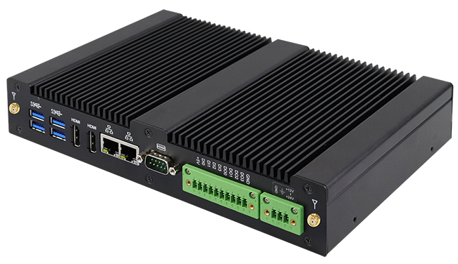

IBASE leverages the high performance and stunning graphics capabilities of AMD Ryzen Embedded processors with its own manufacturing flexibility to design the fanless ASB200-918 that runs two simultaneous HDMI 2.0a displays at Ultra HD 4K resolution (3840 x 2160) with a frame rate of 60 fps. Measuring 240mm x 162mm x 42mm, it is equipped with rugged components to ensure a reliable and uninterrupted operation in industrial control, factory, kiosks and other space-critical applications.
The robust design of the ASB200-918 comes with 16GB of DDR4-2666 memory with ECC and up to 32GB support. The unit features a 64GB TLC SSD storage, 12V~24V DC wide power input and optional 90W power adaptor. Versatile I/O connectivity is provided by 4x COM, 4x USB 3.1, 1x USB 2.0, 2x GbE and an external GPIO, while expansion is supplied by two M.2 slots for NVMe storage and WiFi or Bluetooth connections. Supported operating systems include Win10, Win10 IoT Enterprise, Win Embedded Standard 8, and Ubuntu 16.04.

  • Fanless system with IBASE IB918 3.5’’ Disk-Size SBC
  • AMD Ryzen™ Embedded V1000/R1000 on board
  • 2x DDR4 SO-DIMM, Max. 32GB, supports ECC
  • Supports 2x M.2 sockets (E-Key / M-Key, NVMe)
  • 2x HDMI(2.0a), 2x Intel® Gigabit LAN
  • 4 x COM ports, External GPIO
  • 4 x USB3.1, 1x USB2.0
  • 12V(-10%) ~ 24V(+10%) DC-in Power Input
  • Operating temperature 0°C~45°C (32°F~113°F)
