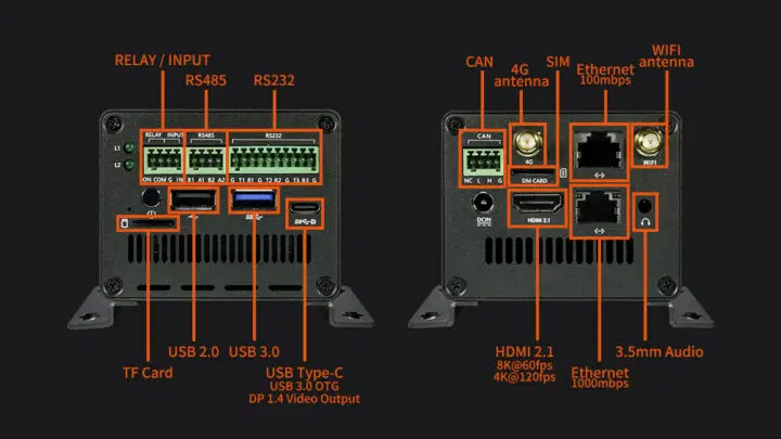

The mini PC is further equipped with up to 32GB RAM and 128GB eMMC flash, M.2 NVMe or SATA storage, a strong video encoding and decoding capability, and numerous interfaces used for industrial purposes such as RS485 and RS233, CAN Bus, Relay, and digital input. Gigabit Ethernet, fast Ethernet, WiFi 4, Bluetooth 5.0, and 4G LTE are also available for strong network connectivity. Others include 8K-capable HDMI 2.1 and DP1.4 video outputs, USB ports, and a 3.5mm audio jack.

  • Variety of Interfaces
    • M.2 (PCIe 2.0) socket for NVMe SSD
    • Relay/digital input
    • RS485
    • RS232
    • CAN Bus
    • L1/L2 LEDs
    • 1x USB 3.0 Type-A port
    • 1x USB 2.0 Type-A port
    • 1x USB 3.0 OTG Type-C port
