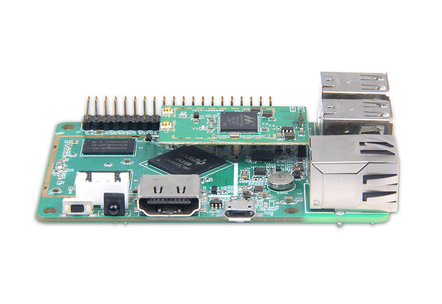

A look to the side of the board. Shouldn't the IR receiver be located on the other side?
A look to the side of the XPI 3128 board and its hardware
