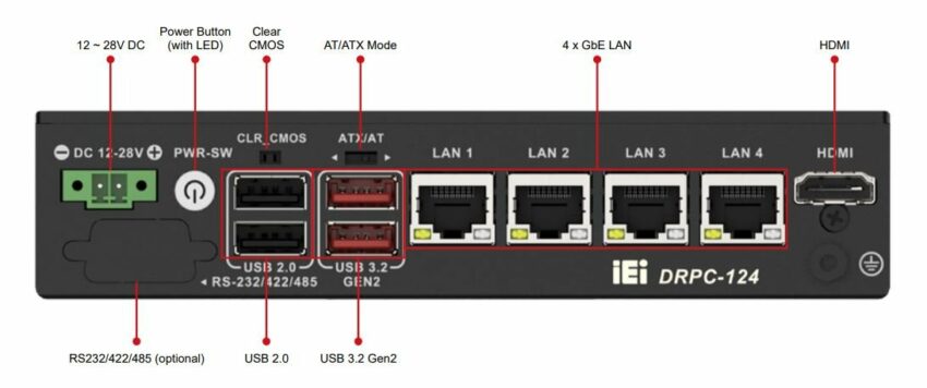

The DRPC-124-EHL is a compact DIN-rail mini PC powered by an Intel Celeron J6412 processor. The nominal clock speed of the device is 2.0 GHz, which can boost up to 2.6 GHz with a max TDP of 10W. Besides that, this mini PC comes with a dual 2.5GbE Ethernet and is equipped with 8GB of LPDDR4x memory, expandable up to 16GB. In terms of storage, the device comes with 64GB or 128GB storage options. The device uses a 2-pin terminal block with a 12-28V DC input for power.
The DRPC-124-EHL by ICP Germany is an ultra-compact, DIN-rail, Fanless Mini PC with a 10nm Intel Celeron Quad Core J6412 processor and four LAN ports.
The IntelCeleron-J6412 is a 4-core, 4-thread processor with a maximum boost frequency of 3.6GHz and a 1.5 MB L2 Cache. Other than that, it has 16 Execution Units and support for Intels 11th Gen UHD Graphics; with all the features, the total TDP of this device is only 10 Watts, which is very impressive for a device like this.
Regarding Ethernet Connectivity, this device offers Four Intel Ethernet ports, among those there is one GbE interface with an I210 controller and three 2.5 GbE interfaces with an I225V controller. The device comes with Windows 10 preinstalled but it is also compatible with Linux. other than that, when it comes to certifications its CE, FCC, and UKCA certified.
Specification of DRPC-124-EHL Module
  • Memory/Storage: Up to 16GB LPDDR4x, Up to eMMC 5.1 128GB.
  • Display: 1x HDMI V 1.4B.
  • Expansion: 1x 2242 B-key (PCIe Gen3 x2), 1x 2242 B-key (SATA), 1x 2280 M-key (PCIe Gen3 x2).
  • Connectivity: 1 x RJ-45 PCIe GbE, 3 x RJ-45 PCIe 2.5.
  • I/O Interfaces: 1x RS-232/422/485 (Optional).
  • USB: 2 x USB 3.2 Gen2, 2 x USB 2.0.
  • Other Features: TPM 2.0.
  • Power: 12-28 VDC (via 2-pin terminal block).
  • Operating Temperature: 10°C to 50°C.
  • Mechanical: 159 x 132.5 x 35 mm, 1.2 kg, DIN-Rail, Wall Mount, extruded aluminum alloy chassis.
