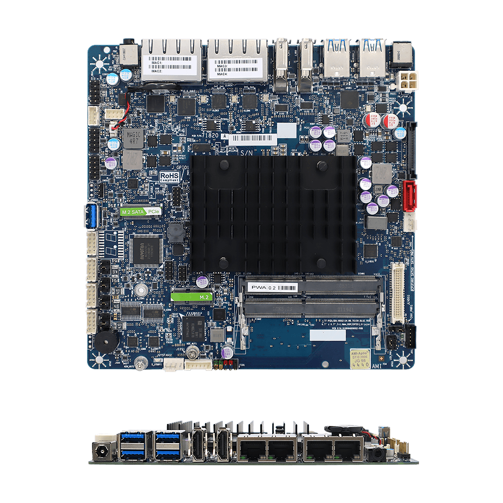

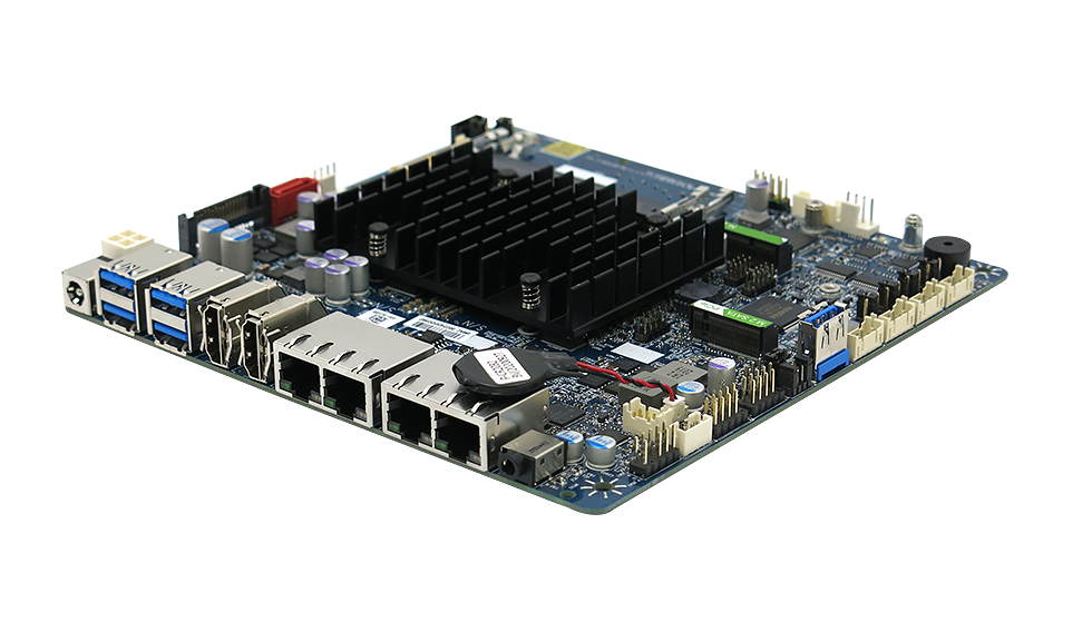

BCM Advanced just introduced a new industrial motherboard designed for fanless operation – the Intel Celeron J6412 thin Mini-ITX motherboard. The motherboard, equipped with quite a number of interesting features, is powered by an Intel® Celeron J6412 Quad Core Elkhart Lake SoC up to 2.6GHz Burst Frequency, with Intel UHD graphics and 10W TDP.
The motherboard, equipped with quite a number of interesting features, is powered by an Intel® Celeron J6412 Quad Core Elkhart Lake SoC up to 2.6GHz Burst Frequency, with Intel UHD graphics and 10W TDP. The motherboard is further equipped with up to 32 GB RAM via two SODIMM DDR4 memory slots, four LAN ports (two 2.5GbE and two Gigabit Ethernet RJ45 ports), three independent displays, up to five USB 3.0 Type-A ports and four USB 2.0, four COM ports, SATA and NVMe storage, a large but thin heatsink which makes it suitable for fanless operation, HDMI 4K video outputs, 12-24V DC input, and a good number of serial ports.
