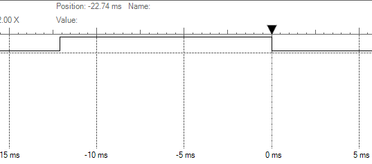

Timing Diagram For Printing “Hello World!” Using printf() Through A UART At 9600 Baud - Image courtesy of EDN
Timing Diagram For Printing “Hello World!” Using printf() Through A UART At 9600 Baud – Image courtesy of EDN

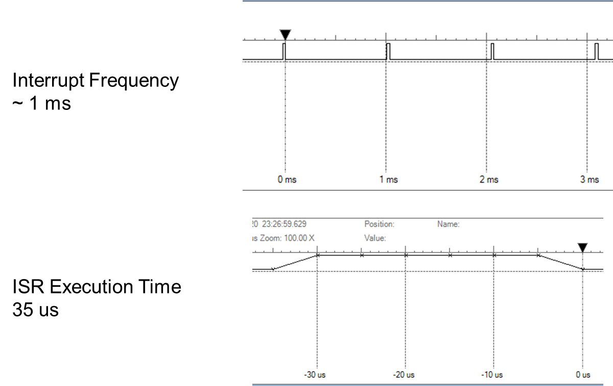

Performance Of The Non-blocking Version - Images courtesy of EDN
Performance Of The Non-blocking Version – Images courtesy of EDN
