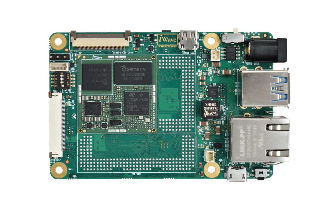

iWave Systems iW-RainboW-G54S is An STM32MP13x-based SBC designed for Embedded and Industrial use
iWave Systems has recently launched its iW-RainboW-G54S, a compact SBC designed for industrial automation, machine learning, vision systems, and multimedia applications with a temperature range of -40 to +85°C. It features an STMicroelectronics STM32MP13x OSM with a Cortex-A7 core processor running up to 1 GHz and supports up to 1GB DDR3L memory and expandable 128GB eMMC storage.
It features an STMicroelectronics STM32MP13x OSM with a Cortex-A7 core processor running up to 1 GHz and supports up to 1GB DDR3L memory and expandable 128GB eMMC storage. A wide range of connectivity options is offered by the board, including Gigabit Ethernet, multiple UART, CAN, I2C, SPI, USB ports, and an 18-bit RGB display interface. It operates on Linux 6.1.28 or higher and offers long-term product longevity of over 10 years. The SBC provides a balance of performance, flexibility, and reliability in a compact 85mm x 56mm form factor.
Previously, iWave Systems introduced some SoMs, such as the iW-RainboW-G58M, the iW-RainboW-G61M, the iW-RainboW-G63M, and many more. These are nothing like the iW-RainboW-G54S SBC, except for some features.

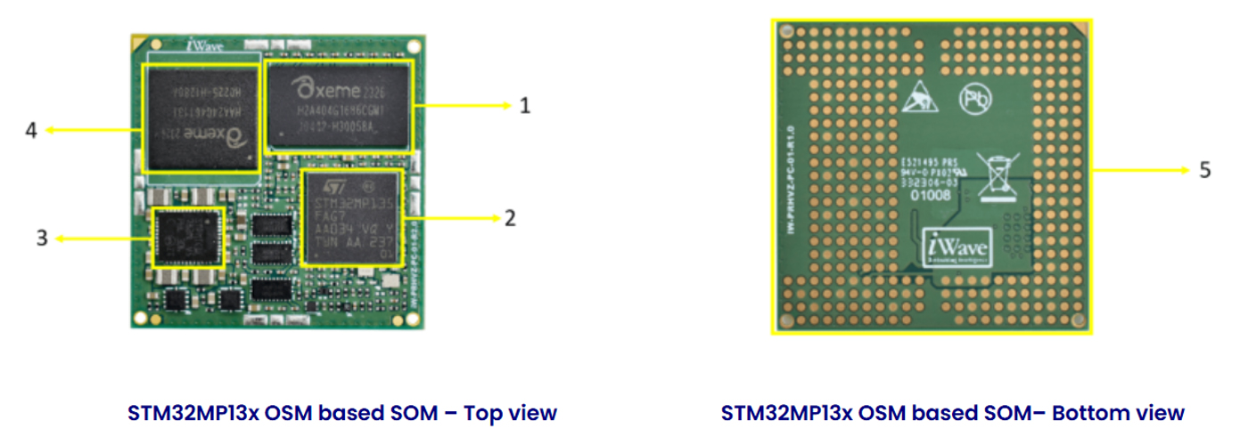

1.DDR3L, 2.STM32MP135 MPU., 3. PMIC, 4.eMMC, 5.OSM LGA

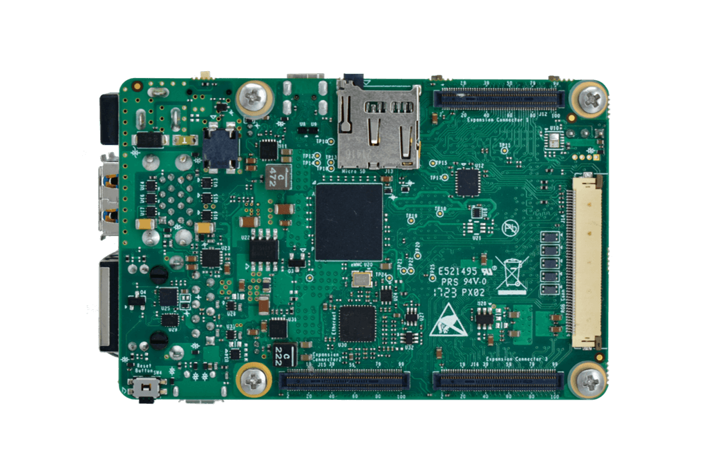

iW-RainboW-G54S Specifications:
  • SoC: STMicroelectronics STM32MP13x
    • Processor:
      • STMicro STM32MP133 single-core Cortex-A7 @ up to 1GHz
      • STMicro STM32MP135 single-core Cortex-A7 @ up to 1GHz
    • Memory: Up to 1GB DDR3L RAM
    • Storage:
      • 4GB eMMC (expandable up to 128GB)
      • 16Kbit EEPROM
    • Networking and Connectivity: On-module Gigabit Ethernet PHY
    • Dimensions: 30 x 30mm
  • Storage:
    • MicroSD card slot
  • Display and Multimedia:
    • 18-bit RGB display with touch support
    • SAI (Serial Audio Interface)
    • MIPI CSI connector (Optional)
  • Networking:
    • Gigabit Ethernet (RJ45 with Magjack)
  • USB:
    • 1x USB 2.0 Host port
    • 1x USB 2.0 OTG port
    • USB header
  • Expansion:
    • 2x CAN bus ports
    • 2x SPI
    • 2x I2C
    • 4x UART (2 with flow control)
    • 3x 100-pin expansion connectors
    • JTAG
    • 7x GPIOs
    • 2x ADC
    • 1x PWM
  • Misc:
    • RTC Battery Header
    • FAN Header
  • Power: 12V/2A power input
  • Dimensions: 85 x 56mm
  • Operating temperature: -40°C to +85°C
  • Compliance: REACH and RoHS3 compliant

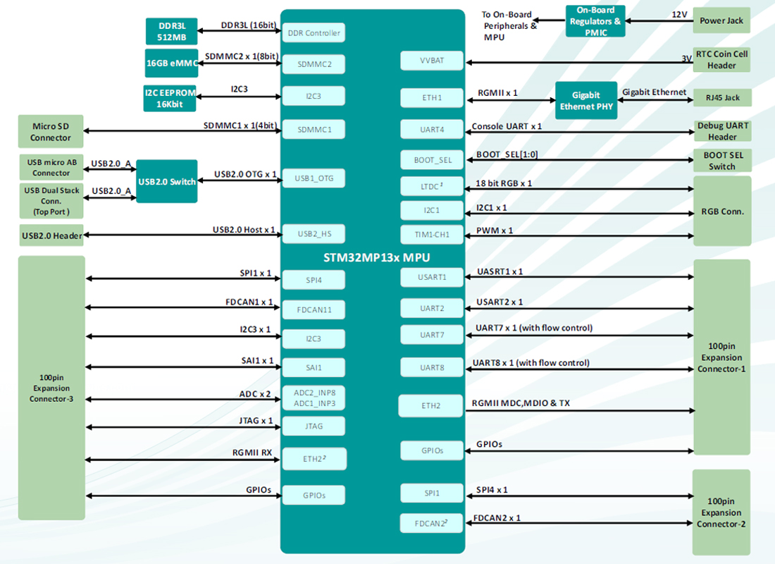

Block Diagram
The company also mentioned that the SBC supports Linux 6.1.28 or later. Basic documents like the brochure, datasheet, and STEP file are available after entering an email, while access to Linux documentation and the SBC requires contacting sales. A quick start guide is also available without registration, explaining how to boot a Yocto-built ST OpenSTLinux image on the board.
